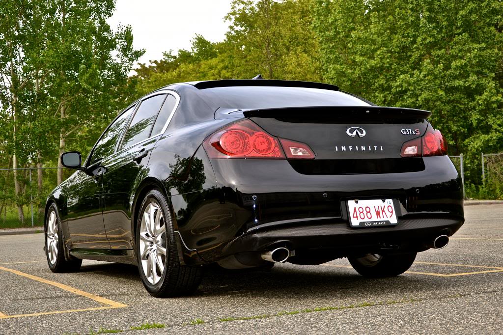

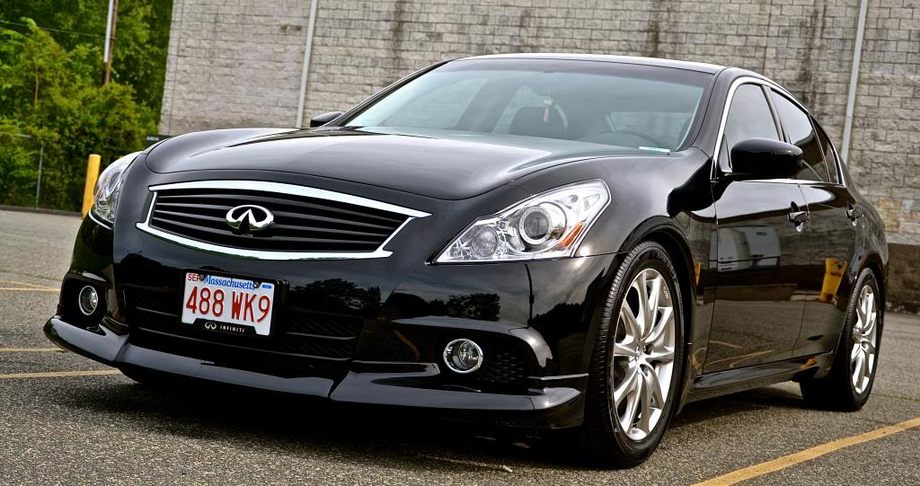

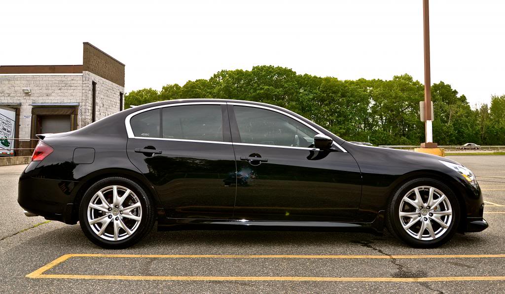

Now I'm on my 2013 G37xS and have B2Design DRM Hub Centric 20mm Spacers for almost 2yrs and all is fine.
I have had the spacers tested & re-torqued twice since I've installed them and no issues.
I was a bit hesitant on going with the DRM style spacers in the beginning, but after careful research I decided they were safe to be installed...as long as you install them correctly as instructed.
I have nothing but good experience regarding spacers.
As long as I'm on stock wheels, they will have spacers & a drop!
