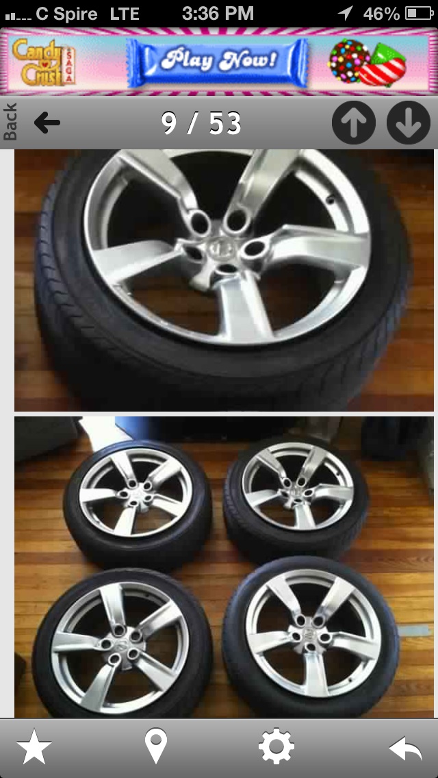

So I searched and don't have a definite answer yet. Will these wheels and tires I found on Craigslist fit my sedan. It's a 10 non sport rwd with factory everything. They are listed as 18" and that's all I know right now. I am unsure if they are staggered or not. Anyway here is a pic
Thanks in advance
Matt

Yes, they will fit.

Yes, they are staggered
The Z guys run 245 front and 275 rear on those 18" but I am not sure about doing that on a G.

the offset is way too aggressive if they are staggered for the rear, they will rub.

Seller said the tire sizes are 245/45R18 96W and 225/50R18 95W
He is gonna get me the rim sizes this weekend.

The front ones will fit, the rear ones will stick out real bad since their offset is 12", I know, because I already tried them on in the past.

Specs on the OP's wheels are as follows:
F: 18x8 +43 225/50/18
R: 18x9 +15 245/45/18
madmax2k1 is definitely right about the rears. You could always try to nab 4 fronts like the guy in this post.

Oh we'll, guess I'll pass.
