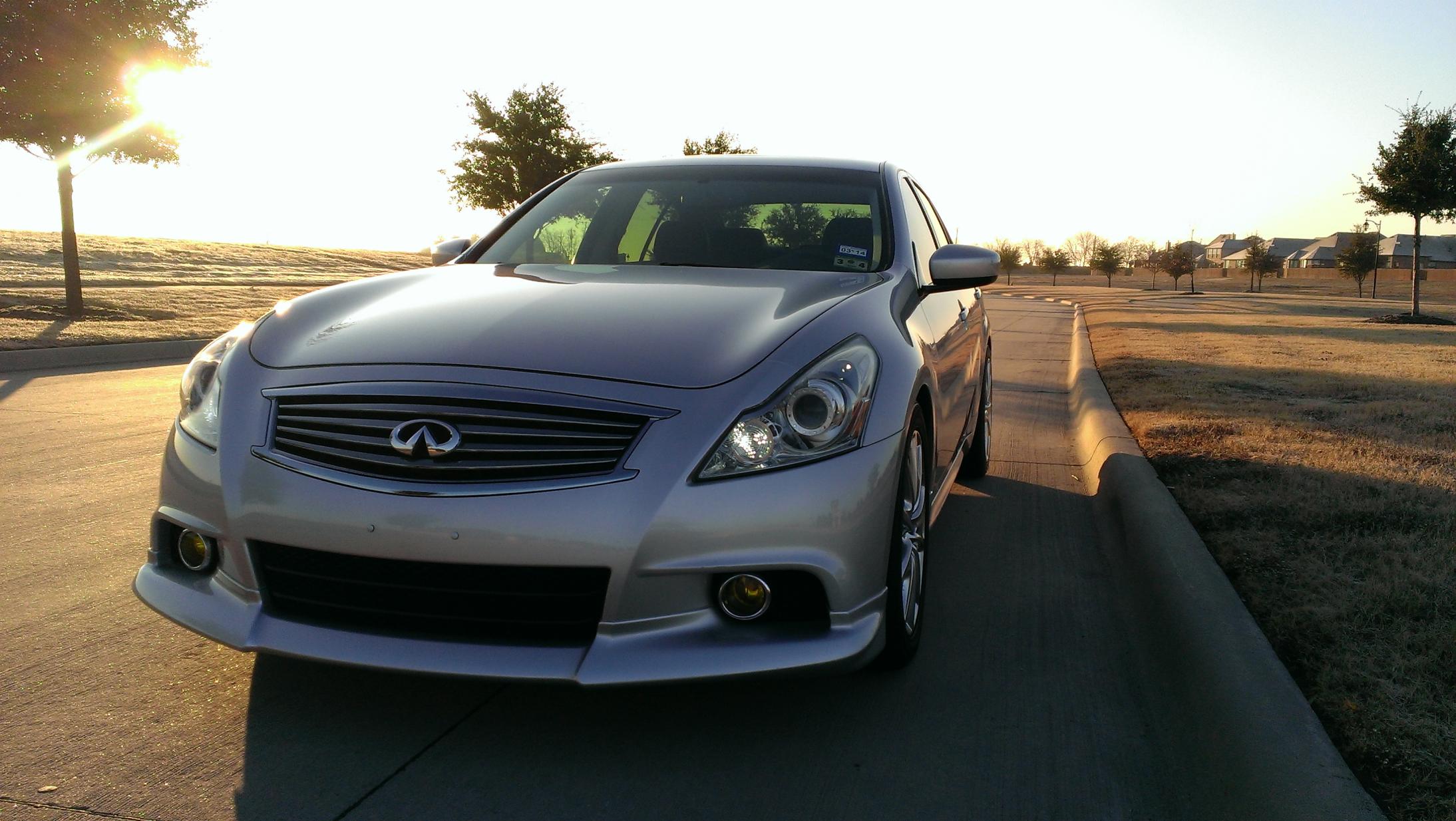

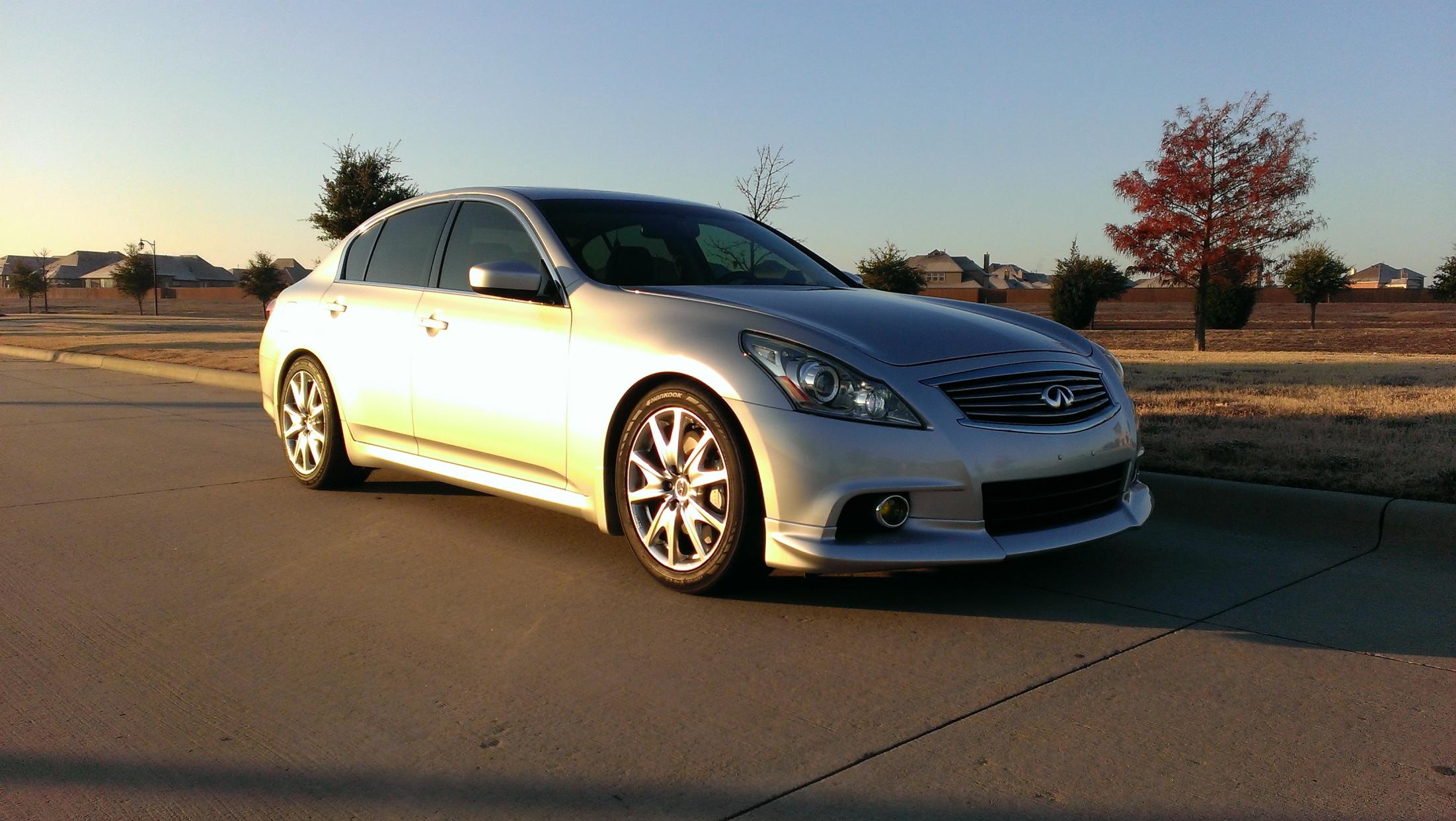

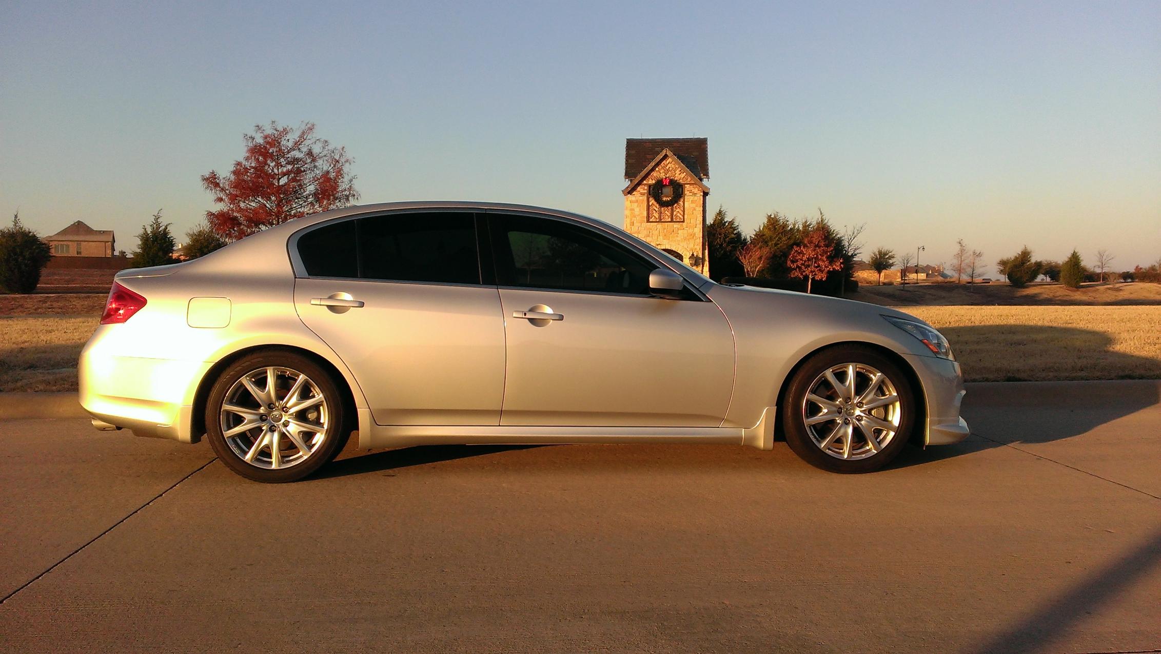

Wink Swift springs with B2 auto designs spacers
I recently installed swift springs with 15mm and 20mm b2 auto designs spacers, and I love this setup! It rides, handles, and looks so nice.
Attached Thumbnails To spacer or not....?-2013-12-24-08.03.29-1.jpg   To spacer or not....?-2013-12-24-08.03.49.jpg   To spacer or not....?-2013-12-24-08.02.49.jpg

:^ Very clean. Something about monochromatic that gets me.. Tires could use a shine though . I do like the spacer look and it is cost effective for the time being, I just can't get myself over the hump with them though..

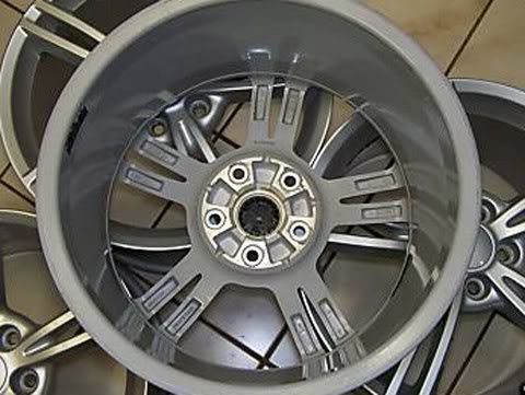

Originally Posted by G37fan09
Hi can anyone tell me if a 15 mm spacer with extended studs (adapters) will get my original studs flush to the spacers or will they stick out?
No, they won't be flush, but they don't have to be. As long as the wheels you're installing are designed with an indented area between each lug hole, like the OEM wheels are, you'll be fine.
Most cast aluminum rims are like that. Steelies, not so much.
For example:
