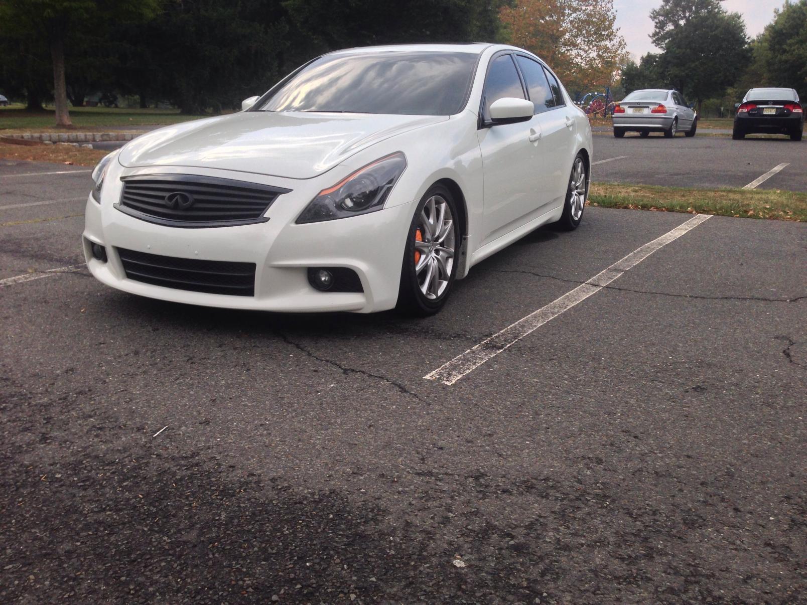

Hey guys I been on the site for couple of months just looking, I have a 2010 g37s sedan 6mt. I have a question purchased 370z wheels 19" with 9.0 front with +47 10 with +30 in the rear I'm dropped on h&r spring, wanted to know if I run 245/40 front and the back 275/40 would it fit. don't really want to run 35 in the back
Attached Thumbnails The OFFICIAL "I have a wheel offset / tire fitment question!" thread-image.jpg
