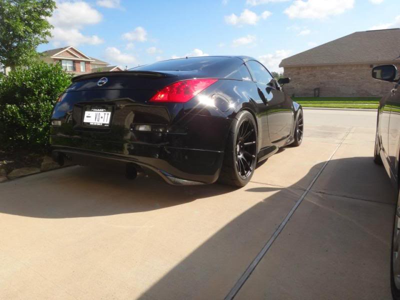

I'll start with my "CrackerJack Box" Twin Turbo 350Z.
Vehicle: 2003 350Z
Wheels: HRE P43SC Satin Black
F: 19x9.5 +20
R: 19x11 +25
Tires: Toyo R888
F: 265/30-19
R: 305/30-19
Suspension: KW V3 w/ SPL Front Camber Arms & Rear Camber Links
**Pics were taken before alignment. I prefer a square set-up.**
