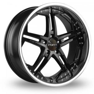

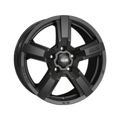

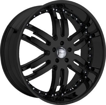

Hey guys
I'm a complete amateur at this so I'm learning as I go along. I'm hoping someone can explain a couple of things to me
I want to swap out my 2011 coupe wheels for something nicer
Now from what I understand, the g37 wheels are:
19 x 8.5 inch (front)
19 x 9 inch (back)
I found a nice pair of alloys I like but they only come as 19x8.5 so If I swap out all four, the back ones will be 1 inch too small for the tyre. How do I compensate for this?
Also, how do I know if an alloy is going to fit? I keep seeing things about the bolt placings and the offsets (these particular wheels say they are 35-50 offsets). Will they fit straight on?
I'm contemplating these alloys:
Attached Thumbnails Wheels-get_image.jpg   Wheels-giovanna_caracas_black.jpg   Wheels-phpthumb_generated_thumbnailjpgcasdsyts.jpg

if you do change your wheels make sure the bolt pattern on the wheel is 5 x 114. Secondly, make sure you have proper offsets. The offsets will determine how far the wheels will poke out from you wheel well. Too conservative and the wheels will hide inside the well, not a good look, IMO. Too aggressive and the wheels will poke out and could cause rubbing issues. Any good wheel/tire shop can help you with the right offsets and recommend something that you will like and look good. Also, if you shop on some of the online stores like Tirerack.com or Wheelsnext.com, all you need to do is put in your vehicle information and they will display the products that will fit your car. Good luck and post pics if you decide to get new shoes.

If I had to choose, it would be the middle wheel...but I'd get staggered man....or keep the stockers

Staggered set up is where to go. I like the thrid ones.. Off sets I have no clue either.. LOL Going through this now with my car..
IE 19x8 front 19x9.5 rears, Offsets good luck. NO CLUE sorry

Have any of you seen the 2011 sport wheels??? Anything is an upgrade from those. I choose the middle as well.

Do you have any more options? The ones in the op are fugly. Plus offsets are really weak...35-50?? On a 8.5" wheel you should be looking for an offset in the 20s, maybe low 30s.

Not really, those are the only thick wheels that look good to me. I really like the first one.
Regarding the off-sets, they're advertised as 35-50 i believe on the website where I can order them from. Does that mean they will fit onto the g37 coupe without any issues? I don't know enough and certainly don't want to tamper with anything, I just want a straight easy swap out of the alloys.
