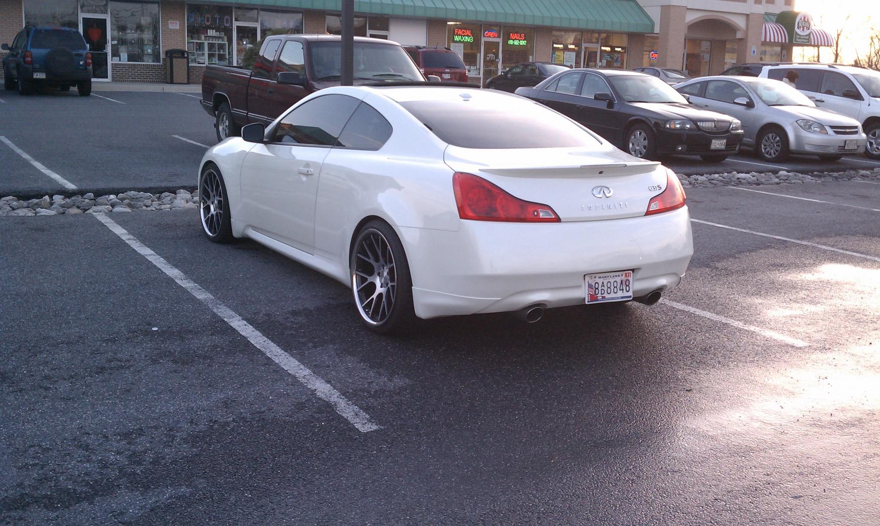

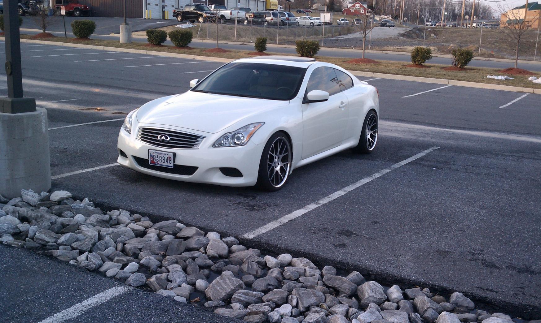

VVS085
20x9 20x10.5 - 285's on the rear..
Eibach Kit
Just washed and waxed! Cell shots but I figured Id post em' anyhow after seeing this thread!

85s are so nice ^^^ Looks great!
