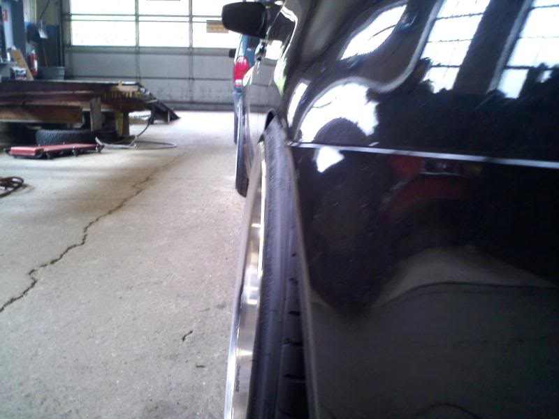

Ok guys im STILL tweaking the suspension. Prob going to leave it at this height, since its perfectly tucking tire all around. Also have to take into consideration all the crappy roads around here. Here are the specs:
F 19x9.5 +18
R 19x 10.5 +13
Dropped on Stance Gr+OEM. Tires are 235/35 & 255/35 Toyo T1R's. Running -2 camber up front and -5 camber in the back.
So looks great but can't drive it. The rear had credit card clearance from tire to fender and on the slightest imperfection it would rub. So we ended up taking the 10mm spacer off of the rear.
Now what would you guys recommend i should do? I dont want to pull my fenders. Fenders come pre rolled from factory.
1. Run spacer anyways and f up my fenders
2. Run smaller spacer (5mm) and hopefully it works.
3. Call it quits and run normal setup like everyone else. LOL

i say run a smaller spacers on the rear or none at all and bring your camber back to spec a bit that way it will stick out more then raise it back up a lil if you're still rubbing.

try a 5 on the rear and see if it still rubs.
or get a skinnier rear tire

This is my last resort. I dont know how u did it Wei. Been back and forth tweaking the suspension all month now. So close but yet so far away.
I will try a smaller spacer. Lets pray for me.

Did you chop off the bumper bracket?
from that shot it looks like it should still be able to camber in on bumps and be fine.

lol you see how f'd up my tirewall is? yea i grinded them down and cut the fender liner. It was literally credit card clearance from tire to fender. You could drive straight but if you ran over a penny it would rub on the fender.
Im prob going to pull my fenders or run smaller spacer.
