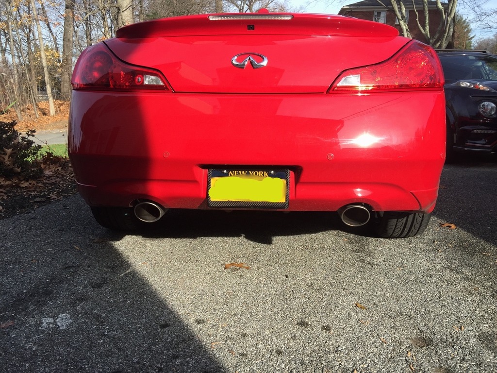

Scored one from the Infiniti eStore at @25% off. ($533)
As an FX owner with the VQ35DE engine, I miss the growl in my G37xS.
I did see a Sport muffler on a couple of showroom floor cars but the salesman told me it was not available for aftermarket. I did my research (here) and fortunately found he was mistaken.
Cut to the chase. If Coke is normal, this is RedBull. It's not a HUGE difference, it is exactly the boost in tone and volume I was looking for.
It drives fairly normally until I stomp on it, and it's all the difference.
I also noticed after some driving the sound improved further.
Was it in my head? well my kid texted me and told me one of her friends just happened to be driving behind me and said the car sounded awesome. She did not mention the exhaust so maybe not so mental after all.

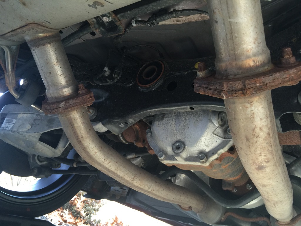

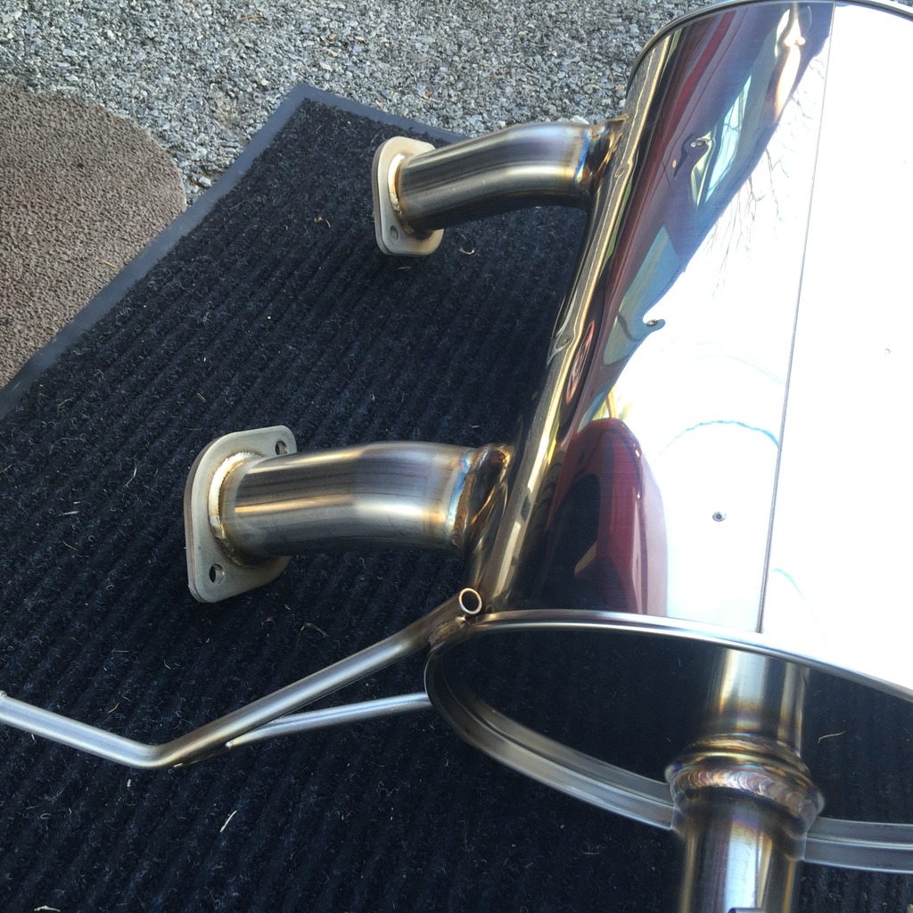

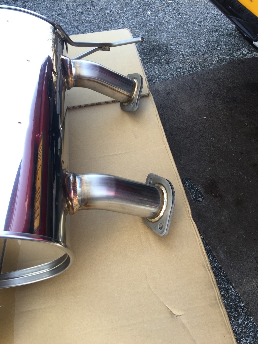

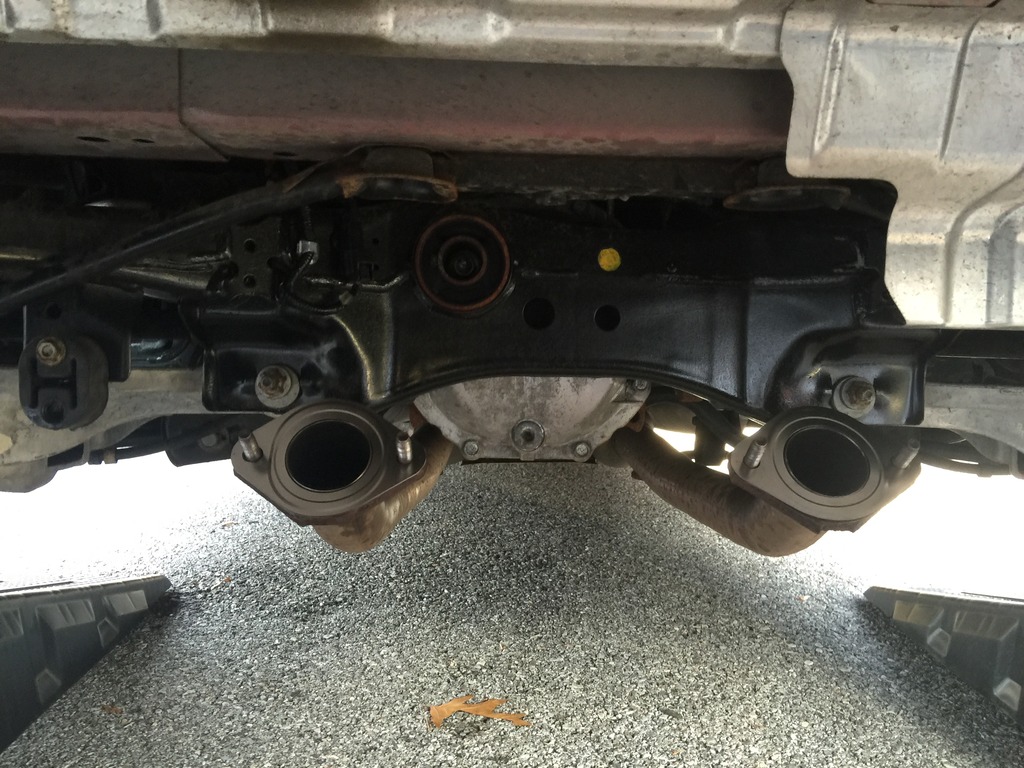

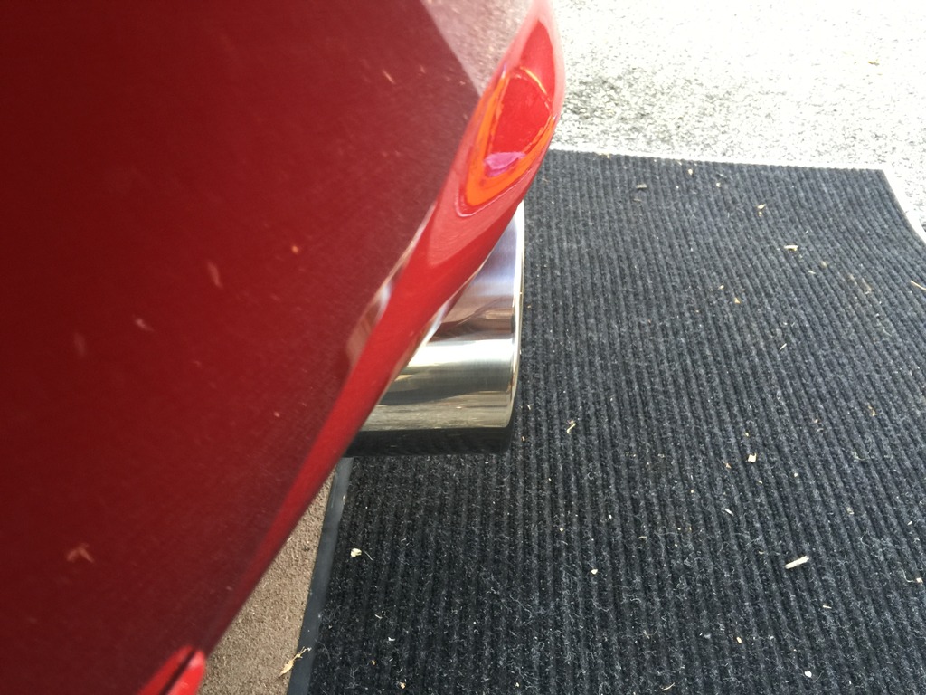

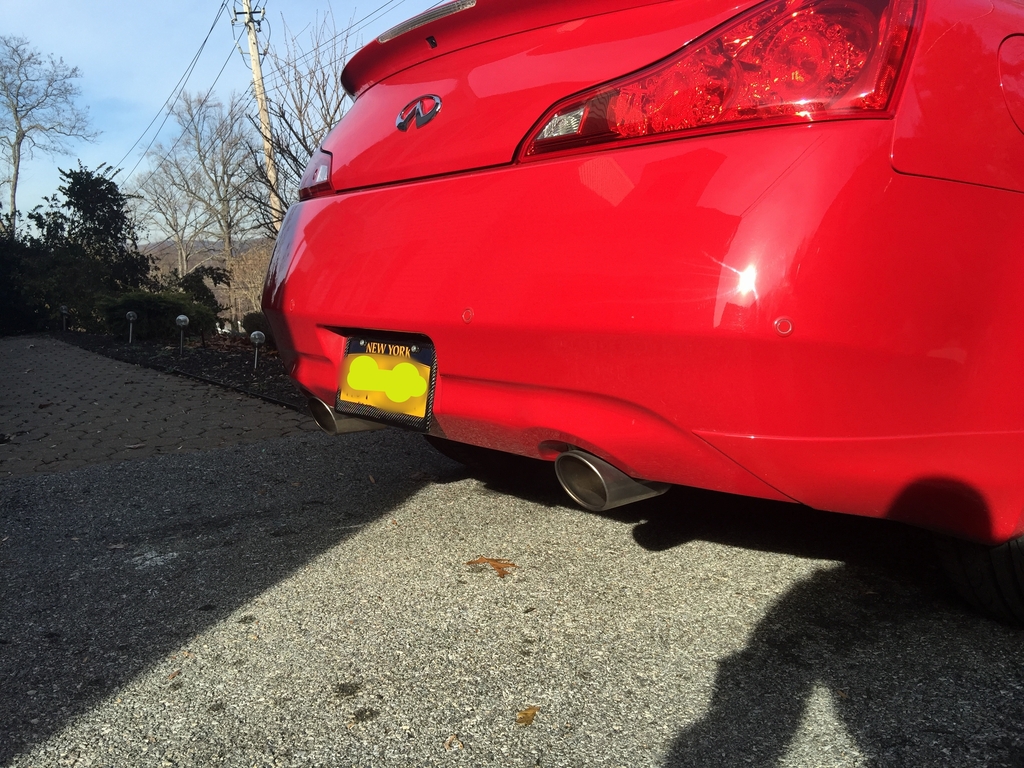

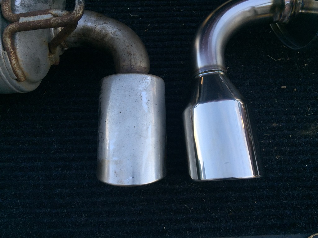

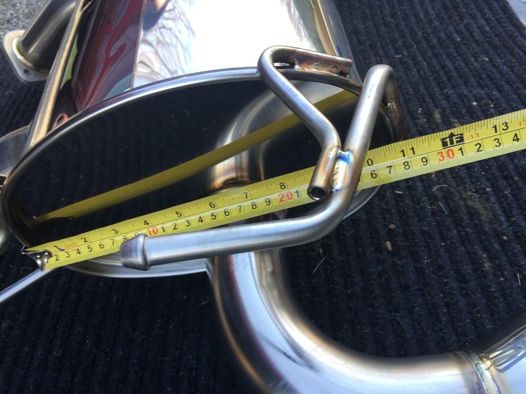

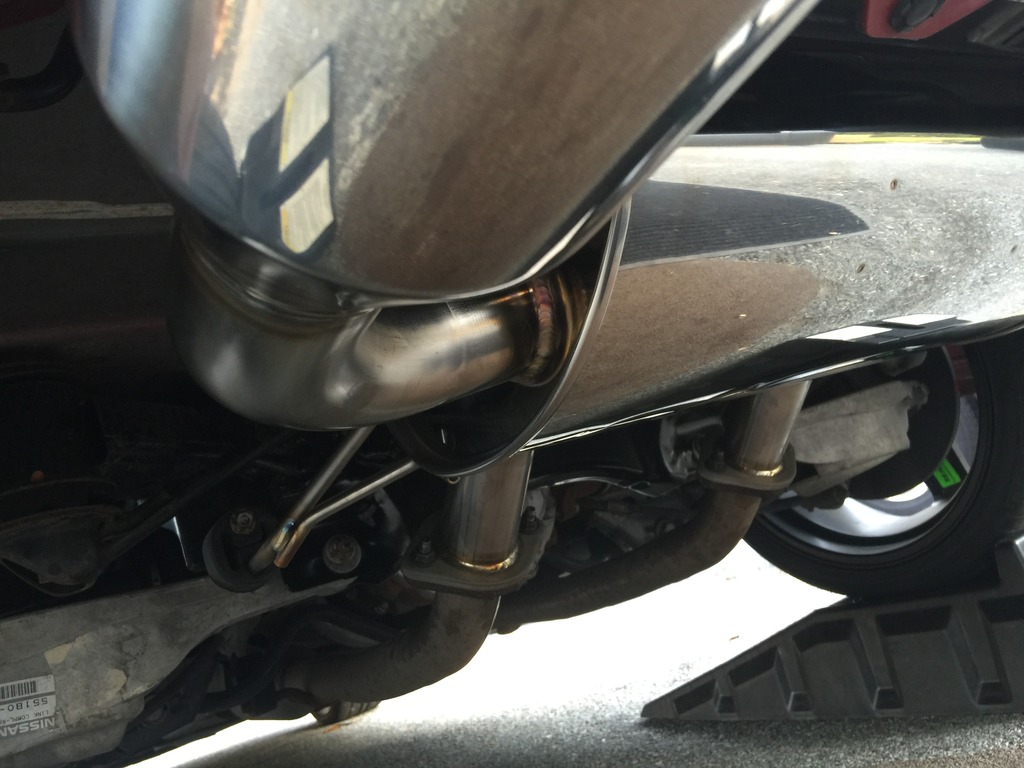

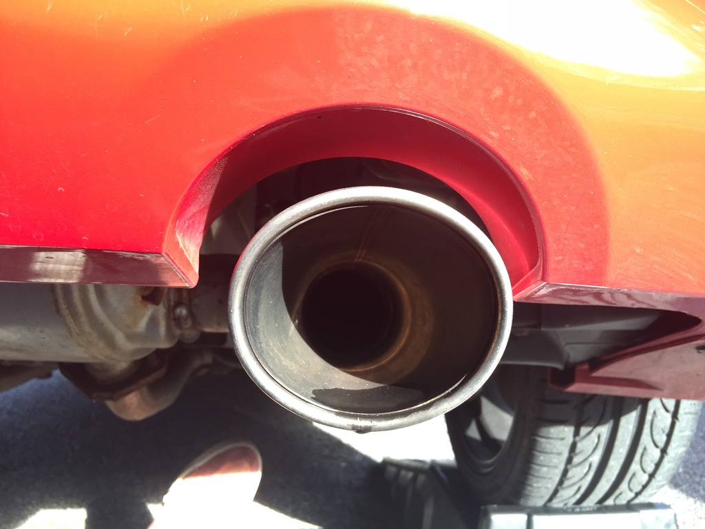

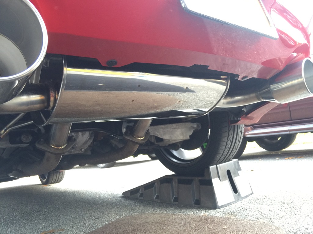

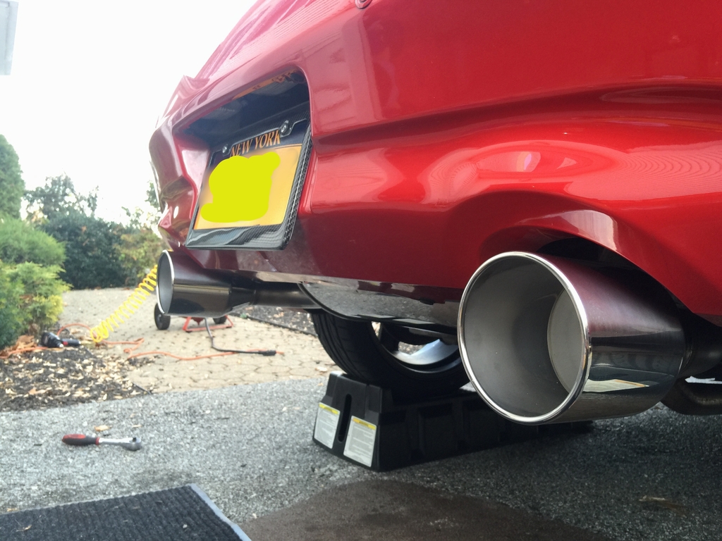

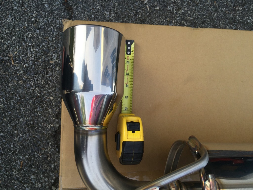

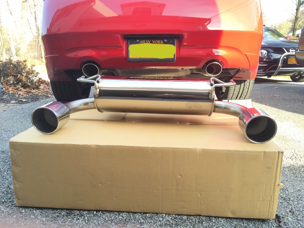

Here are several shots of the install. Photobucket seems to be a pain to manage bulk lists of pics do I'll just dump the lot here without comment. It should be pretty straight forward to see what was done. I used a torch to heat the flange bolts and WD40 to ease the nut movement. Also used WD40 on the rubber hangers which helped quite a bit. I used a large flathead screwdriver to pry the rubber hangers over the tip of the muffler hangers. I also cleaned the flange bolts and flanges with a wire wheel on a drill. It made installation smooth.

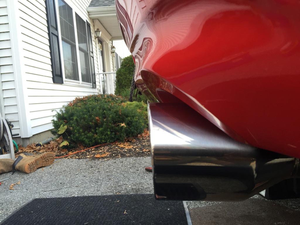

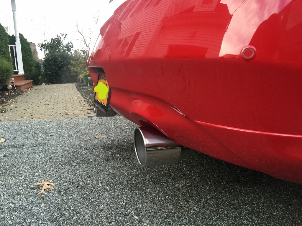

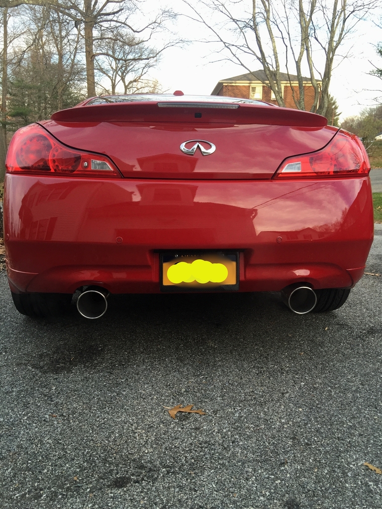

The tips are huge. Not wider but taller and rounder. They only stick out to the OUTER edge of the stock diffuser. Just enough for me. I like the sound and the looks. Exactly what I was aiming for. I'll post some video as soon as I figure out how.
