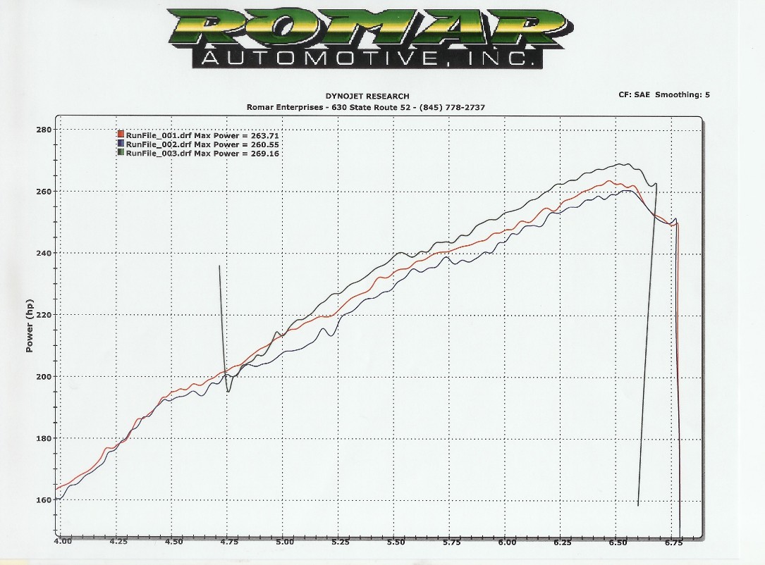

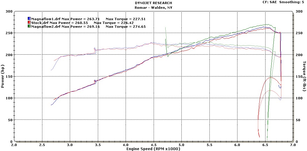

Well, I was finally able to get in on the dyno for a few runs. The runs were performed on a Dynojet at Romar Automotive in Walden, NY. I arrived with the "installed by me" Magnaflow and that run is labeled as "Magnaflow1." We then switched back to stock, this is labeled as "Stock." The stock was then removed and replaced with the Magnaflow and it was properly tightened. Having the exhaust on the lift was way easier to properly tighten those clamps and also to make sure that the resonator hangers aren't rubbing. So, other than being quieter, it was a real treat to see it make more than the 3.2hp and 1.1tq put down by my leaky install! I was told that it's a common mistake to not tighten the clamps enough and that they need to be completed closed on the spacer inside the clamp.
So, the Magnaflow when properly installed got me 269hp/228/tq vs 260hp/219tq for the stock. Not bad for less than $500!

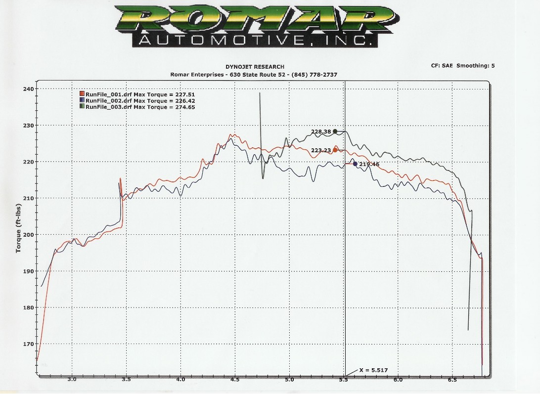

Note 1: The spike on run 3 and the weird dropoff after 6200 rpms is due to the auto which does not take kindly to dyno testing! Even in DS mode and paddle shifting with the VCM off, it would still throw an upshift to 5th right at 6500rpms no matter what. Therefore, ignore the graph after 6000 rpms and no, I didn't get 274.65tq. The real figures for torque I had printed out due this anomoly are 219 stock, 223 leaky Magnaflow, 228 proper Magnaflow.
Note 2: Run conditions were between 74 and 75 degrees with a humidity of 29%. All runs done in 4th gear.
