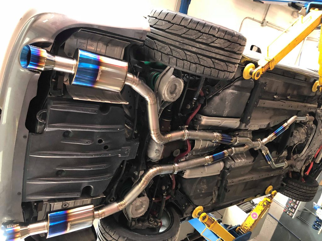

I have some near the mid/axel too lol. Those are the ones I have extra straight pipes in titanium to replace. See here:
