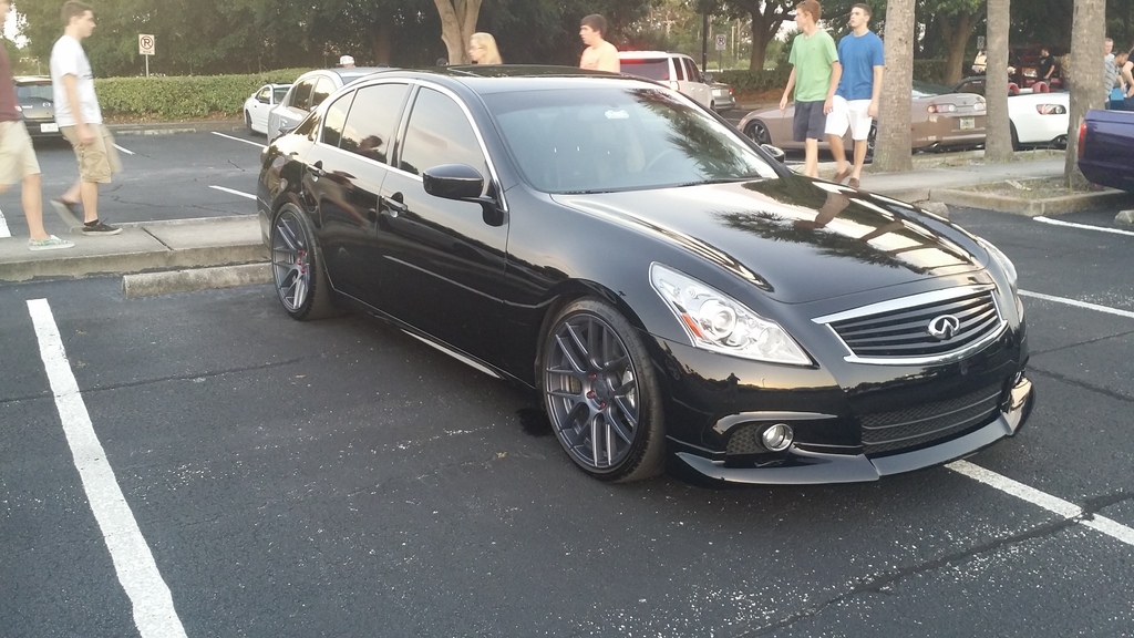

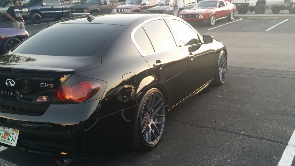

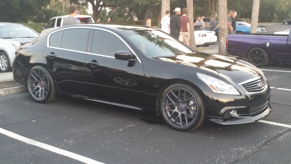

Front
GroundForce GF07 19x8.5 +30
15mm Spacer
Continental ExtremeContact DW 245/40-19
RS-R Sports-i Coilovers
No Camber Correction
Rear
GroundForce GF07 19x9.5 +35
Continental ExtremeContact DW 275/35-19

Originally Posted by PG-v36_6MT
Winning, and w/o camber correction, too. Very nice.
I've seen this car in person. It really does look this good.

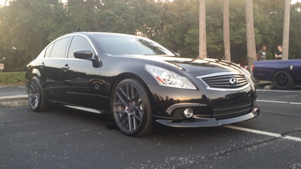

Old 01-06-2016, 03:26 PM
  #89
Daddy Fat Sacs
Daddy Fat Sacs's Avatar
Join Date: Jul 2013
Location: Tampa
Posts: 1,705
Received 357 Likes on 249 Posts

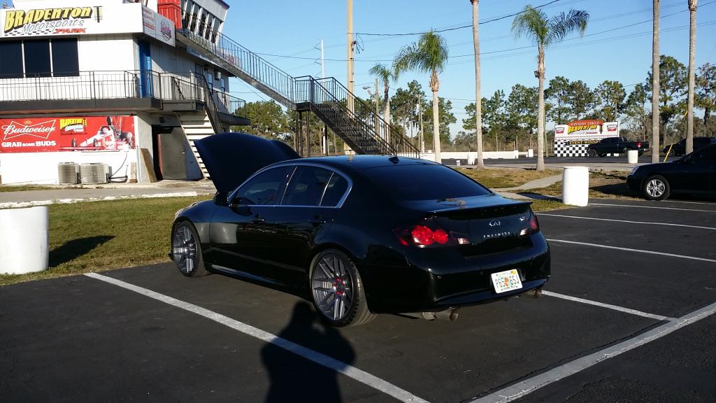

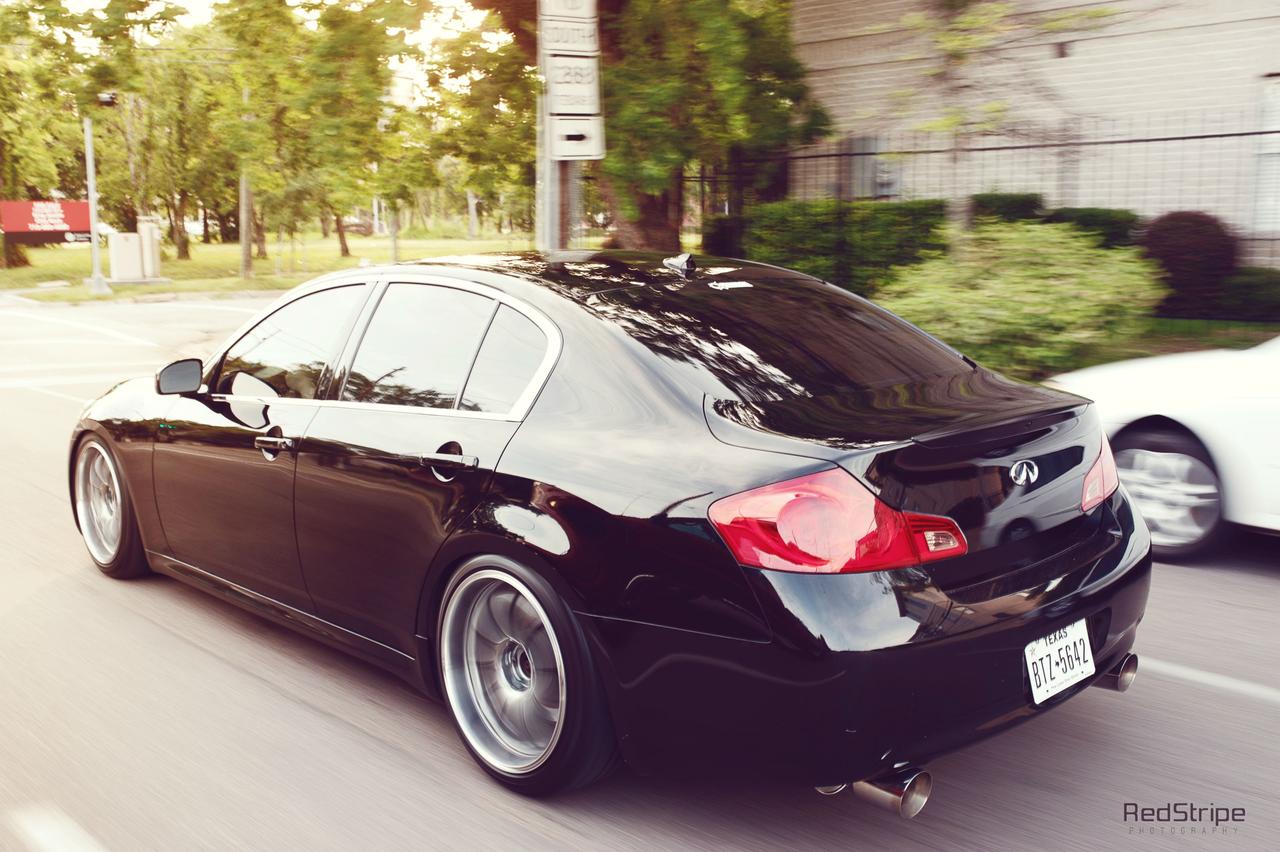

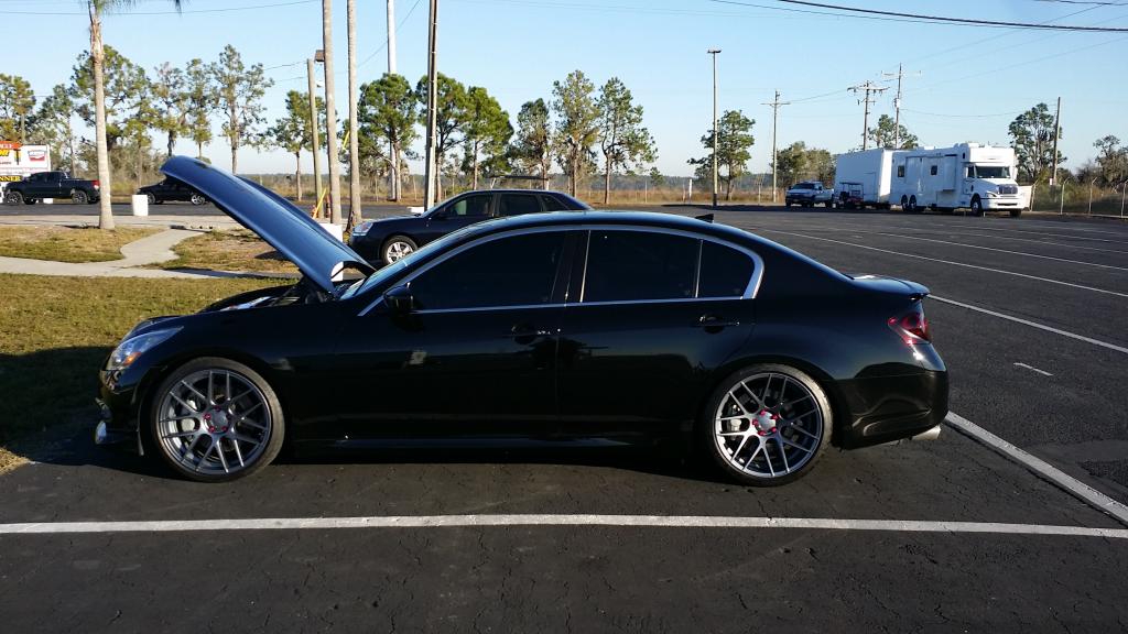

ah why not play along...
heres with F: 20x9 +35 245/35/20 R: 20x10.5 +45 295/30/20
Now running same upfront 245/35/20 , rear is now 285/30/20

damn... the back looks nice and fat!..
ever break loose?
