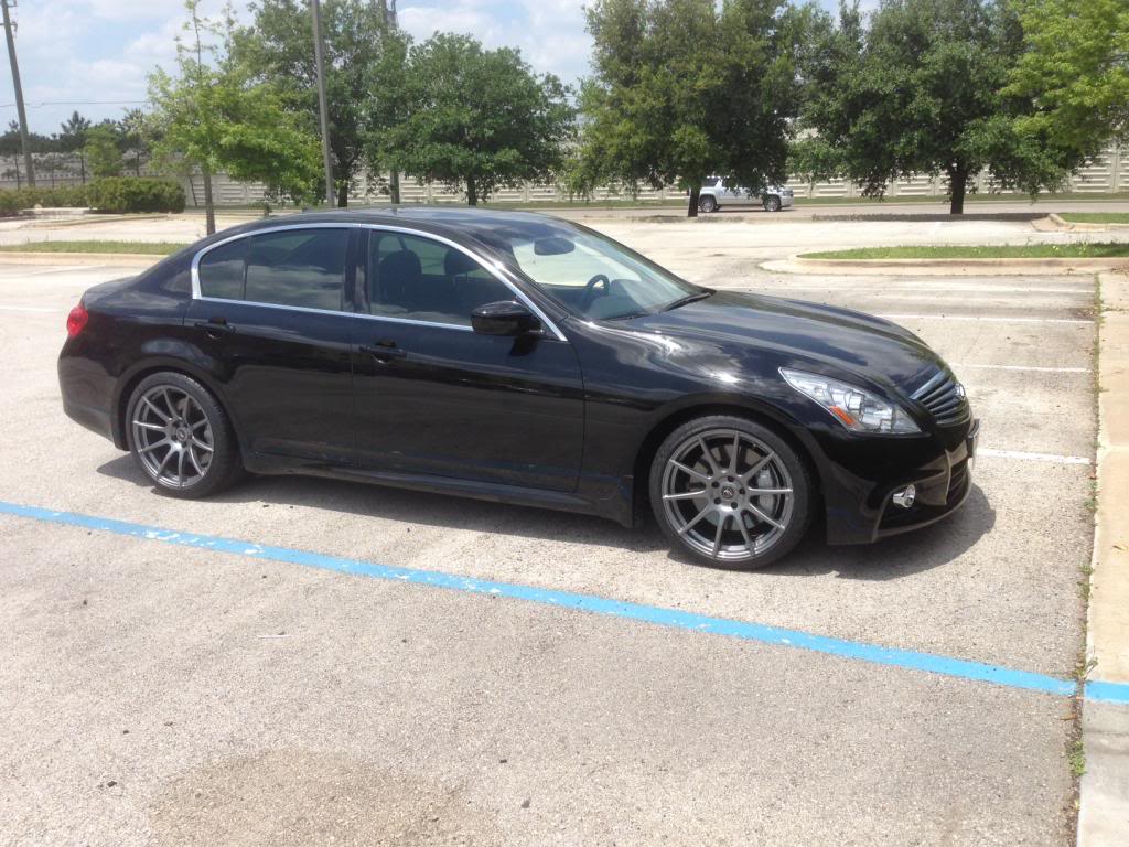

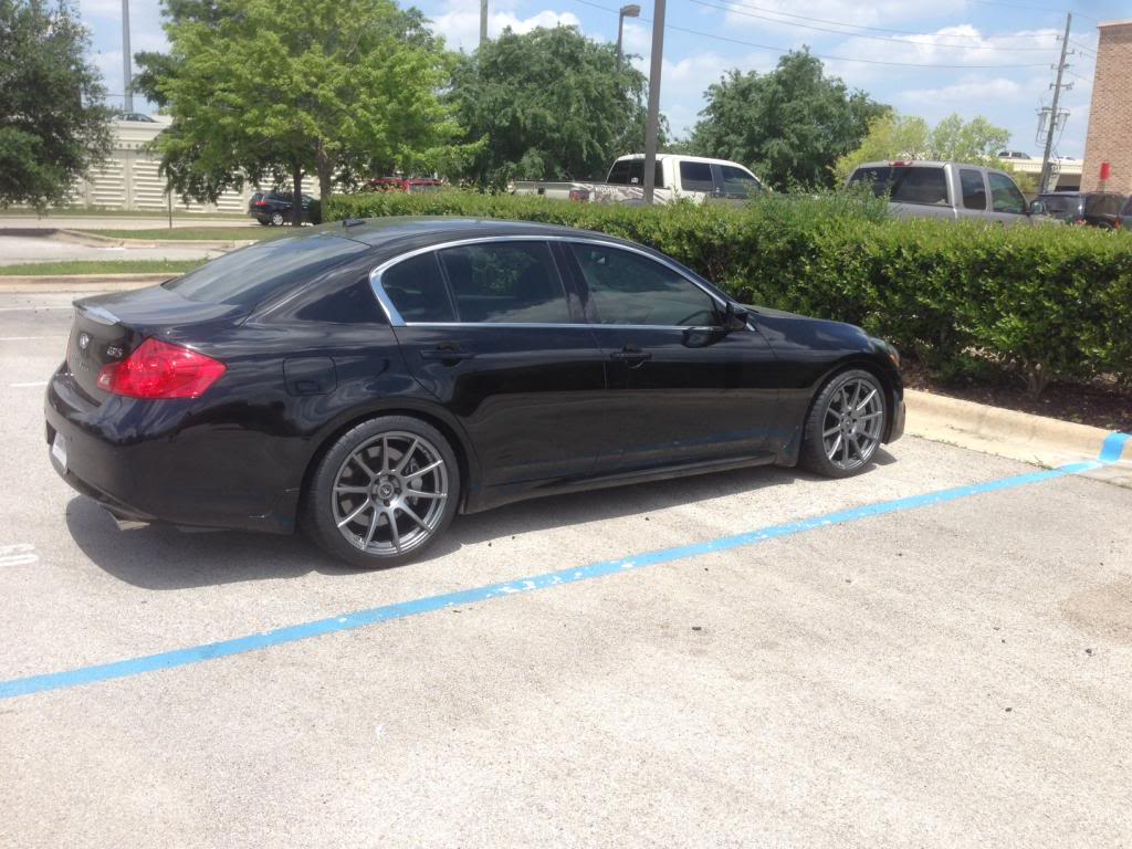

Just got these wheels installed and I like how they came out. Kind of wish I went a little more aggressive in the front but now I got that muscle car look so not too shabby, . I'm hoping the swift springs in the front will settle more but I heard that's not something that happens normally so oh well.
Hope you guys like. Next mods up are exhaust and black out trim/grill.

Hey man looking good , can't wait till my swifts come (Monday I hope)
The drop looks good to me

Looks good. Are those 19in wheels?

Looking good, nice choice for the wheels and the gunmetal finish. What wheel specs and tire sizes are you running?

That looks REALLY good!! Specs please!!

Yup, 19's.
19x9+35 245/35 front
19x10+42 275/35 rear
These wheels totally change the look of my car and I'm now looking back (as opposed to stock) every time I park because how sweet it looks.
If I could change anything I'd probably go with 265/35 in the rear but the somewhat fat tire doesn't bother me that much.

Fixed. They can't both be fronts.
I've got the same rear config: 19x10" +42 with 275/35ZR19 Michelin PSS, and the tire doesn't look fat to me at all. Looks perfect, IMO. The poke doesn't look right, however. Swift Springs arriving next week.
Since we both have the same size rim/offset/tire, the same tires, and the same RWD Sport Sedan, can I see more pics of your rear fitment after the drop on Swifts? Your profile photos look fine. How about from the rear, or down the fender? I ordered the Swifts very specifically to camber in the rears a little bit so it doesn't look so silly. Sure would be nice to know what to expect.

The rears definitely tuck a little more so it doesn't poke as much as yours. I plan on washing the car tomorrow so i will try to get some pics then.

Thanks, buddy. I'm looking forward to seeing that.
With the identical configuration, we have (had) the identical rear poke, so this should really give me the proper expectation. Our fronts are different, however, because I have 19x8.5" at +32 with 245/40ZR19. Right now they're flush, just with a noticeable amount of gap. I'm hoping it pulls in just enough for me to put this pair of 3mm spacers on afterwards.

The difference in our front wheels is about 10 more mm so it won't be that crazy. I'm really curious to see if your taller 40 series tire will shore up some of the front gap because right now I have 3 fingers in the front as opposed to two in the rear.
