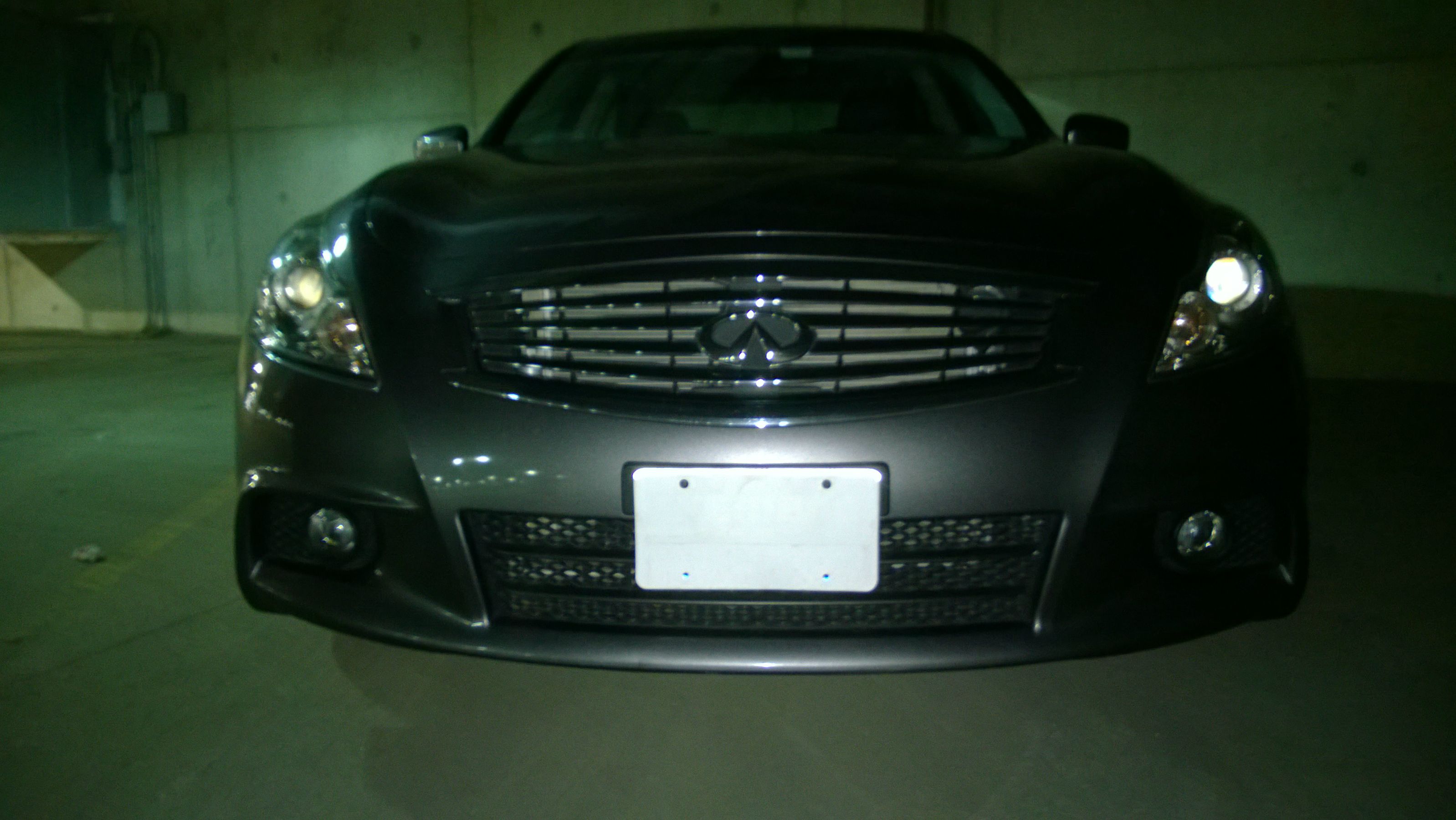

Nice good move, that car has black window trim and mirrors I believe
And my hooptie is black

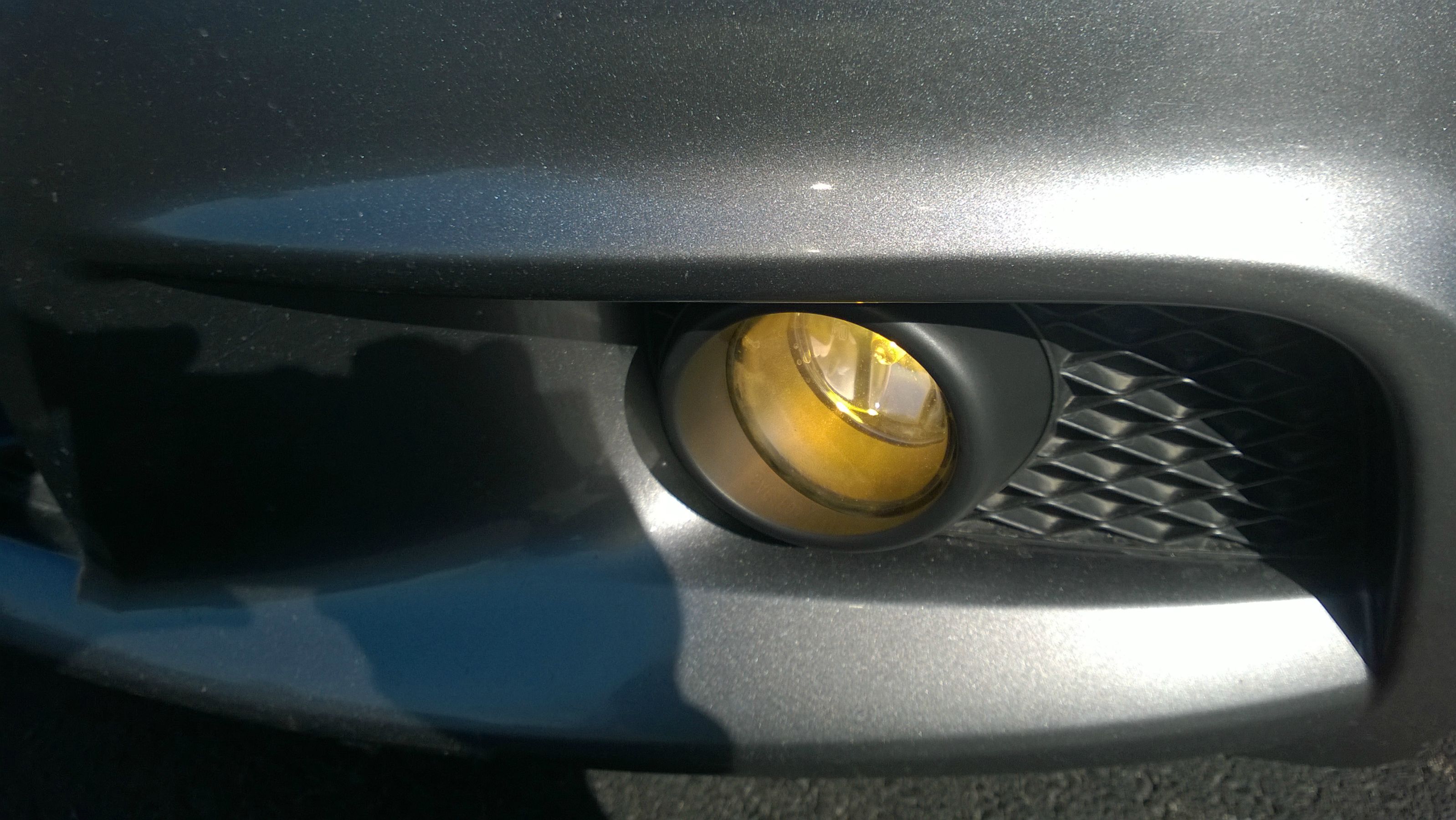

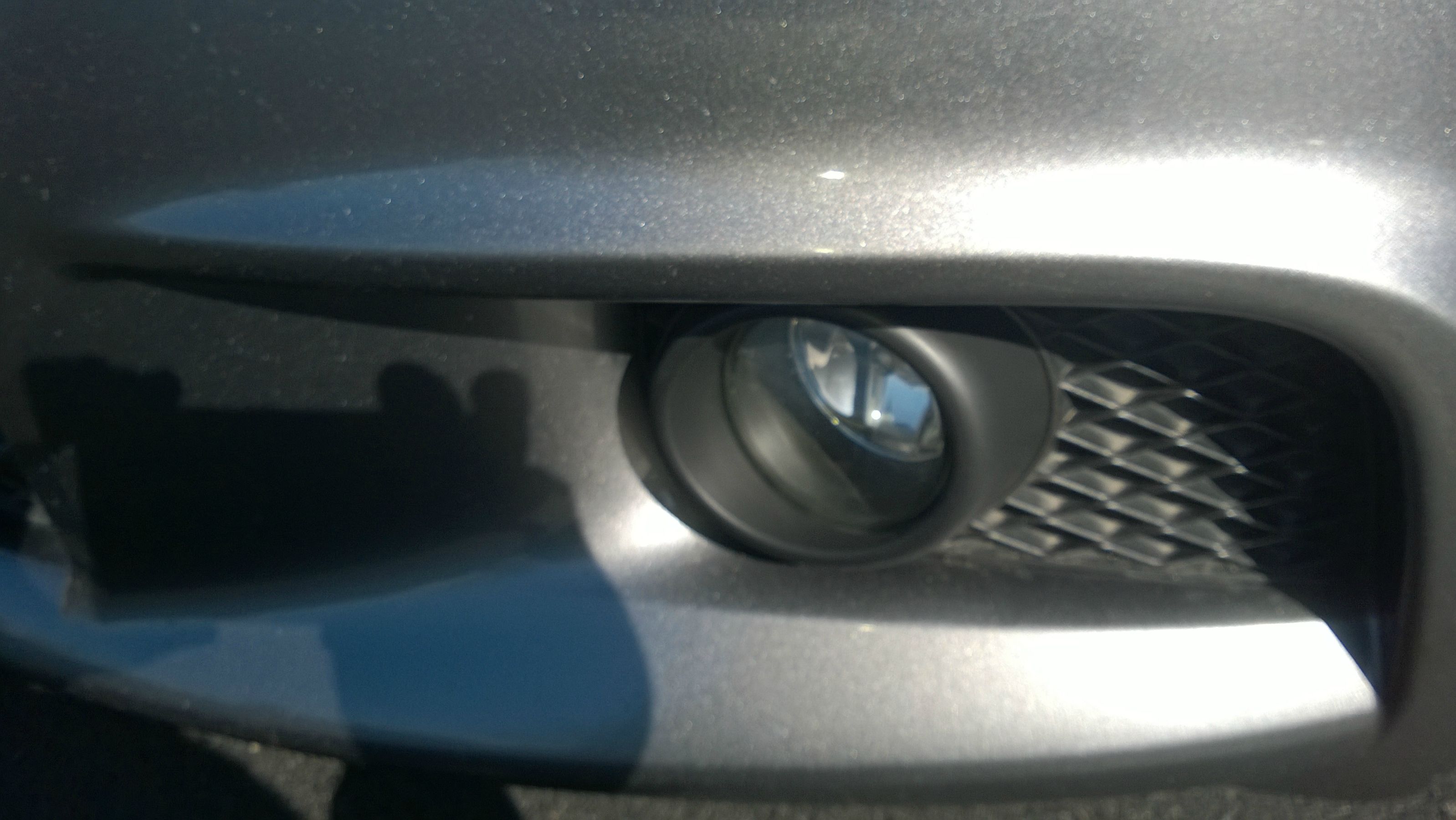

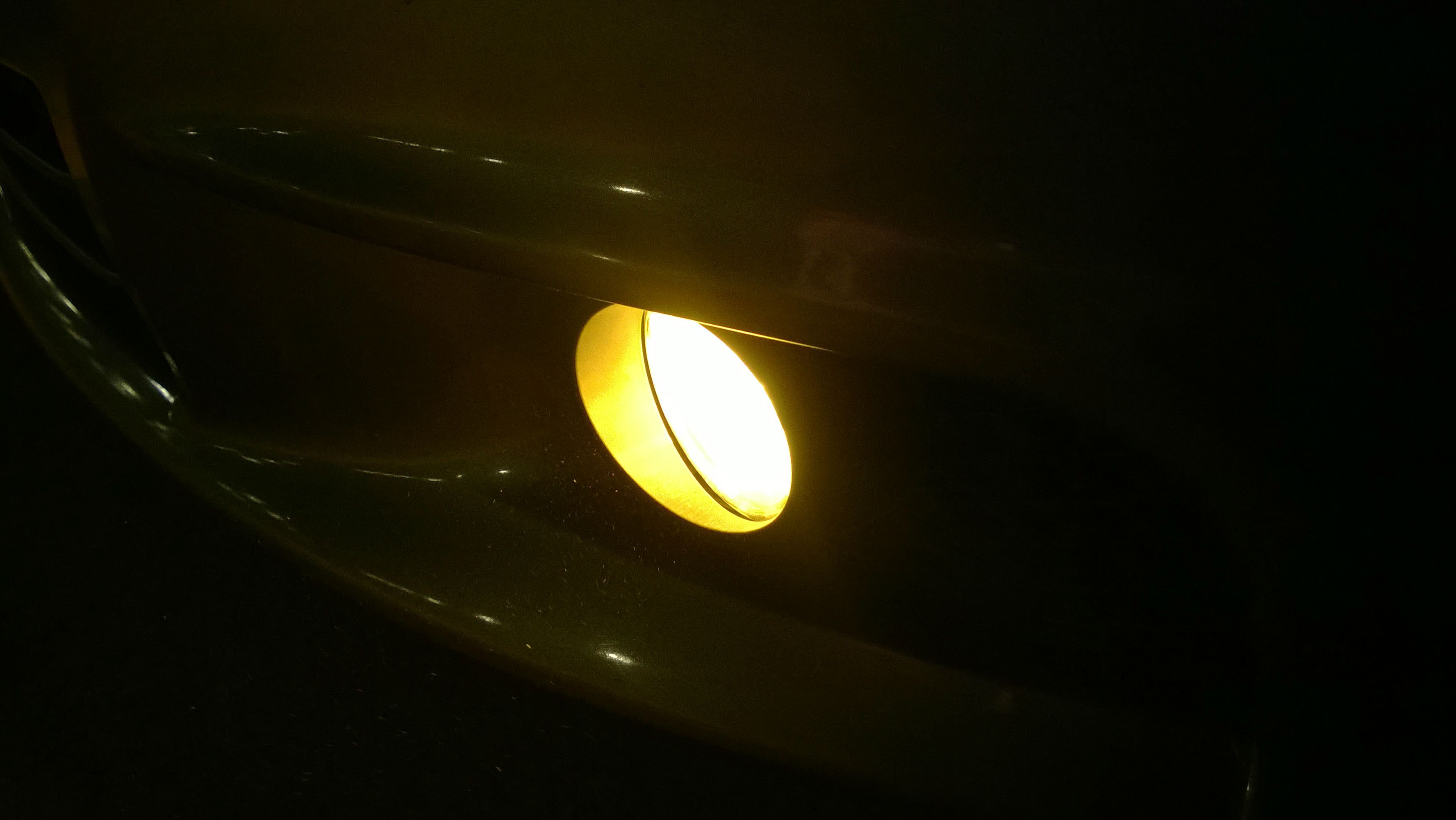

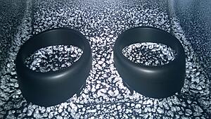

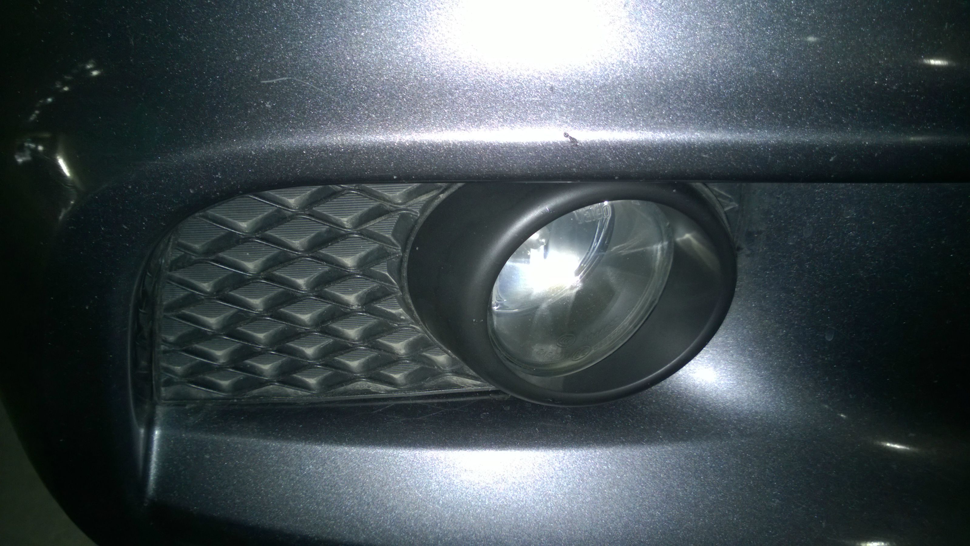

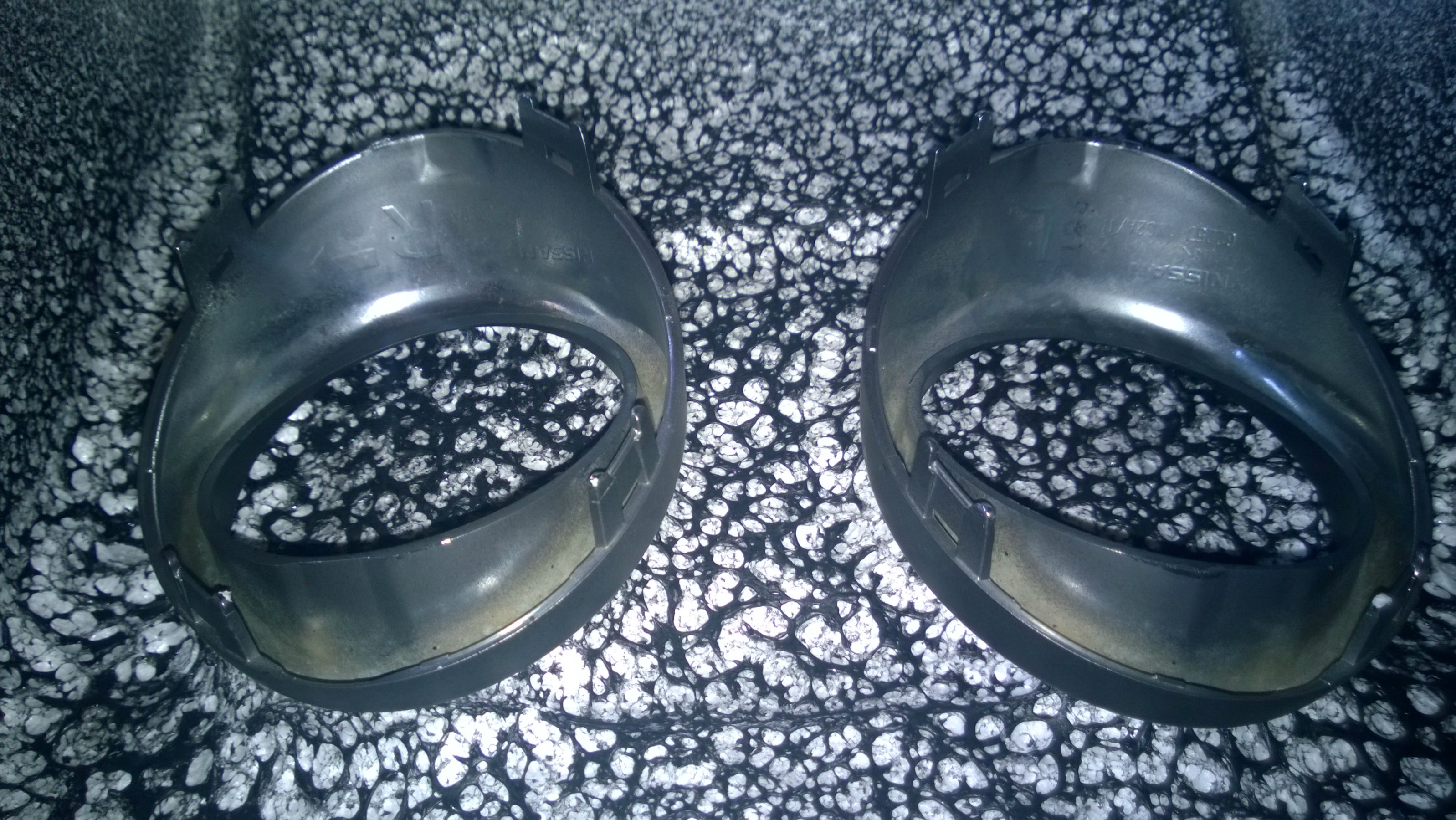

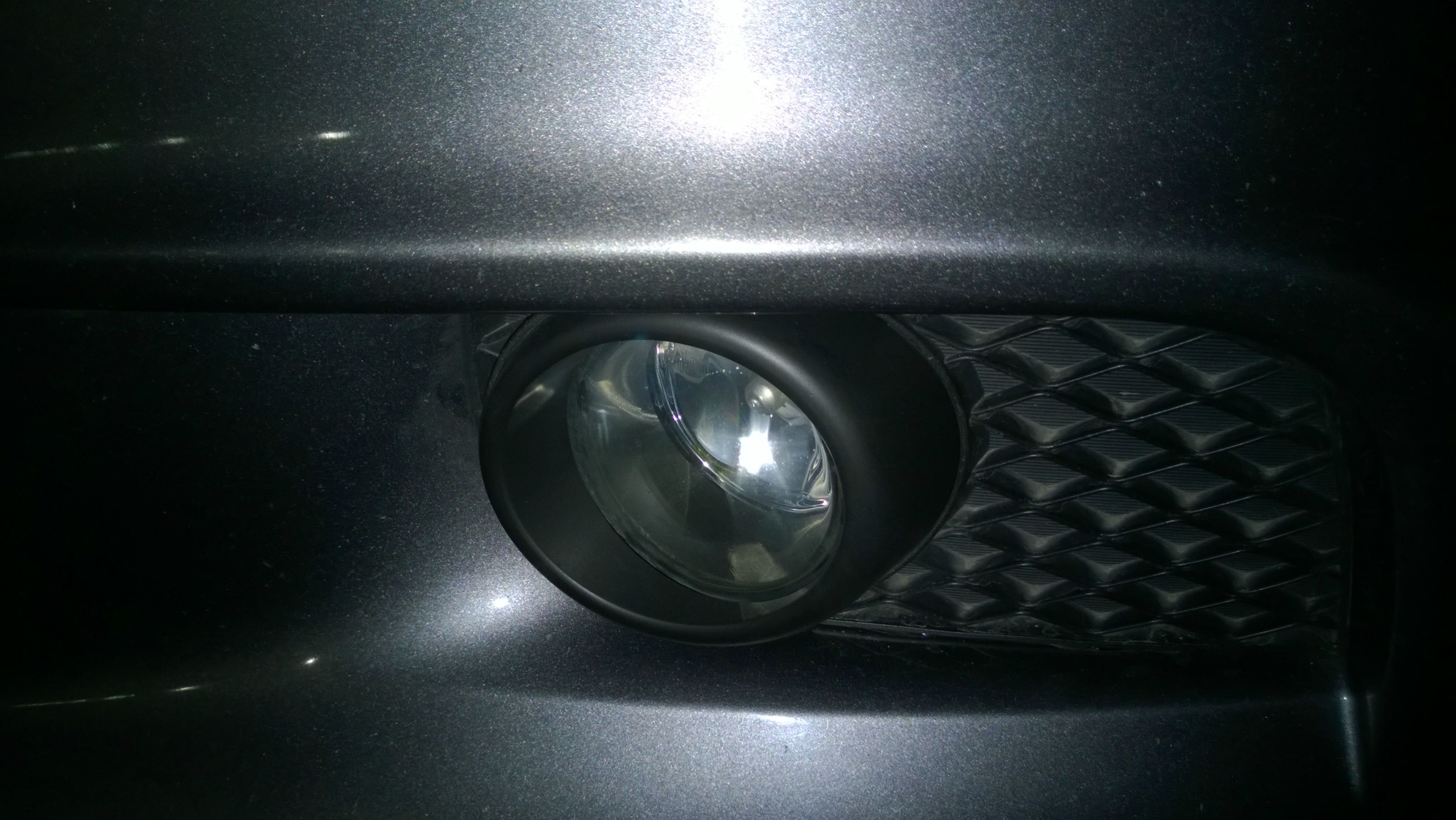

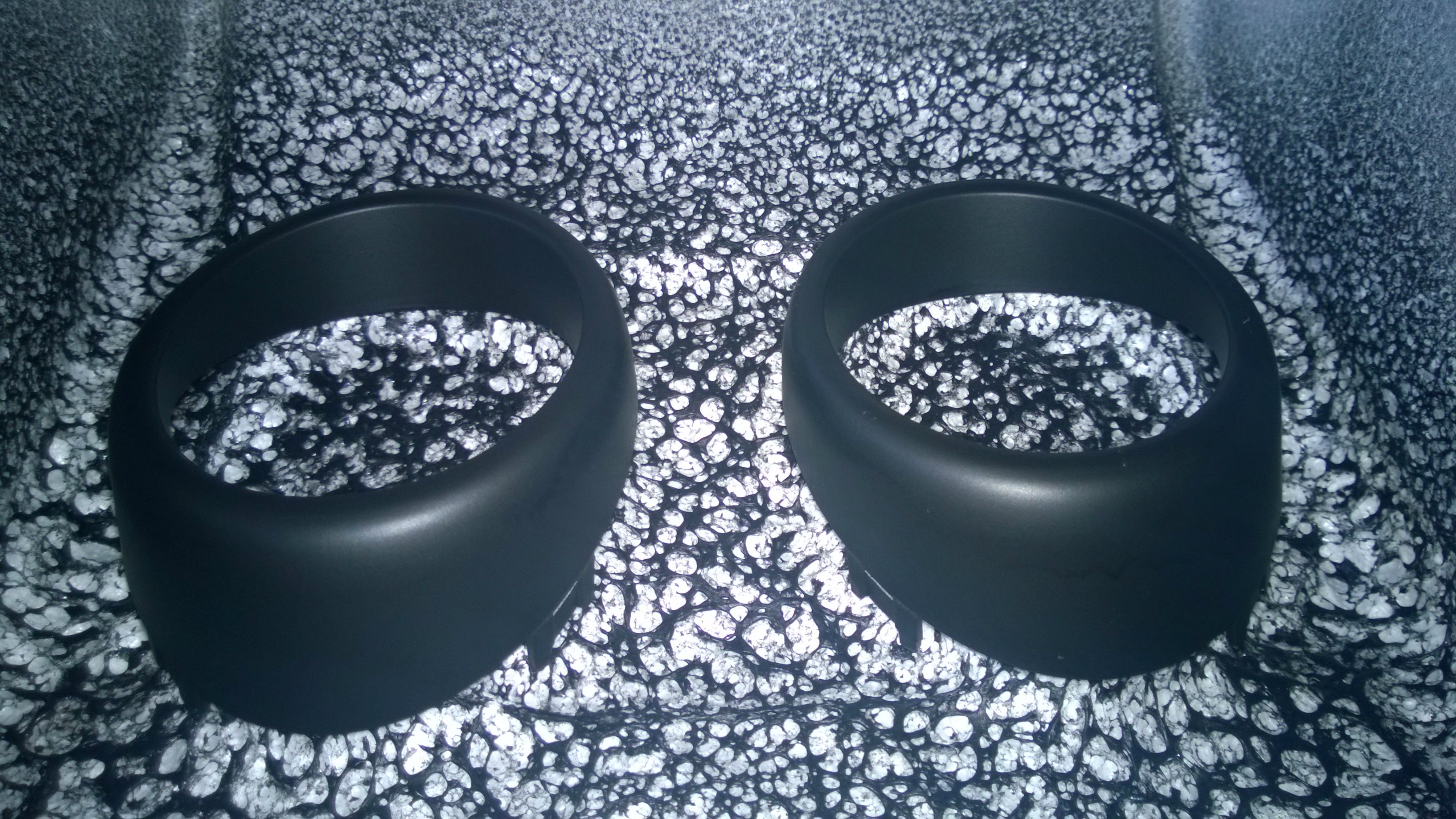

I removed the bumper to access mine as the washer reservoir was in the way. There were 4 clips holding the chrome trim. I don't know how people are grabbing them at 3 & 9 and pulling them off. The tabs at ~230, 430, 730, & 1030.
Rust-Oleum FlexiDip (FlexiDip) seems to eat through styrofoam -- used to hold the rings in place. Hope I did not subject myself too much to something poisonous or something.
I am not completely satisfied with the job -- drips and I dropped the passenger side on the sidewalk after the 3rd coat, subsequent coats did not fill and some chrome is showing -- and will probably redo on a better Saturday afternoon.
