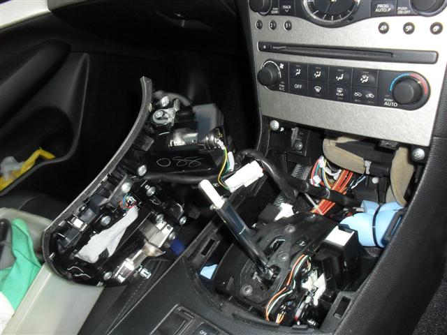

![Name: centerconsole_zps73f2b395.jpg
Size: 55.3 KB](https://www.myg37.com/forums/attachments/g37-sedan/156839d1501307586-annoying-center-console-trim-piece-creaking-noise-centerconsole_zps73f2b395.jpg)
looking at point# 10 from Coupe Daddy's post, it looks like he got lucky and his problem did not extend past that stage.
If you find that you still have creaking noises, you might need to dig further.
Remove the plastic piece that holds the seat heater switches. When the shifter thingamajig in the picture is off, pull the seat heater swtch plastic piece towards the front of the car and it'll pop out.
You will then be able to see a plastic "bar" that goes between the 2 sides of the shift console. Tighten the screws on that bar.
My creaking problem stopped there.
