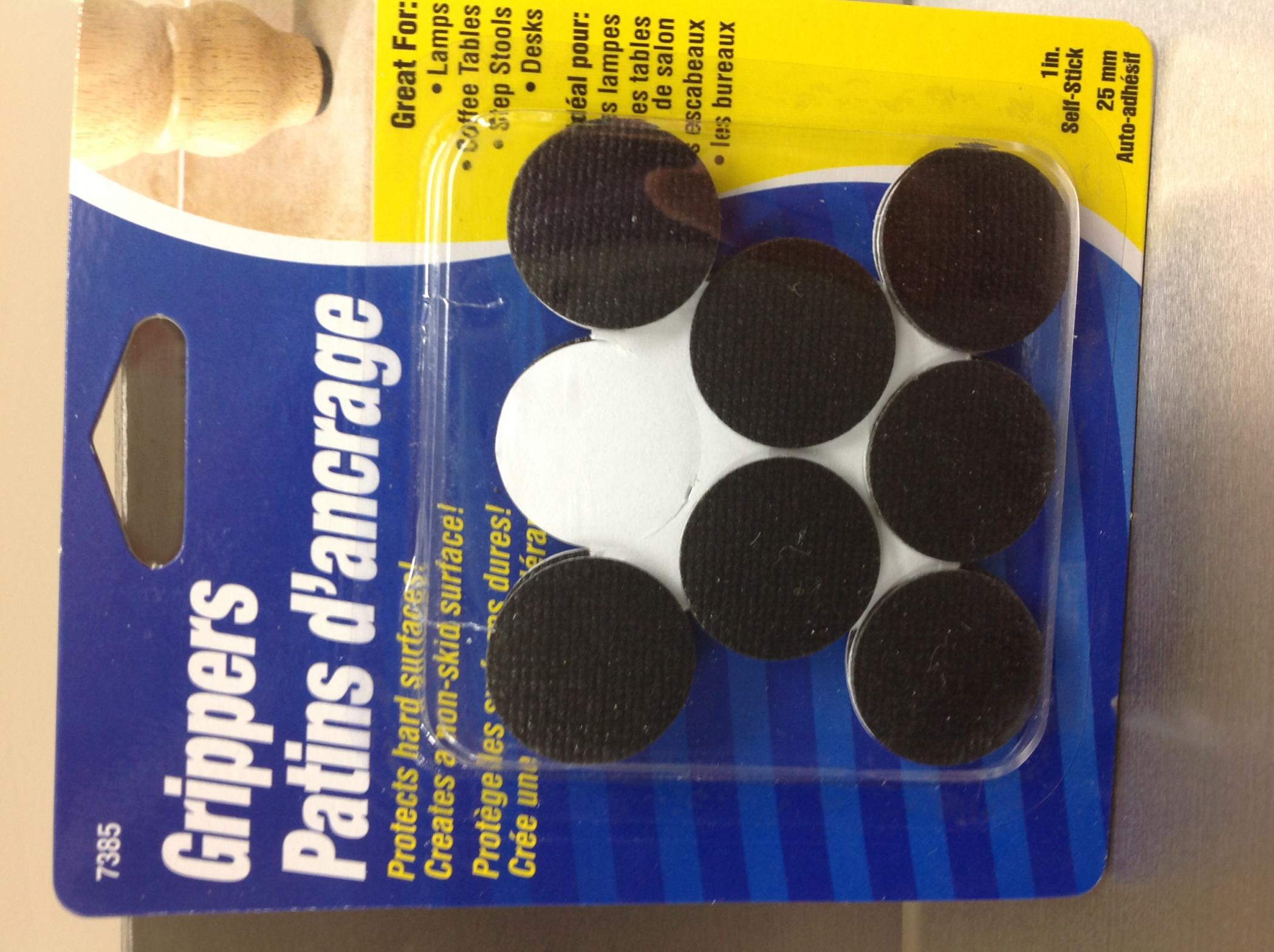

I took my car to the dealership last week for maybe the sixth time regarding this issue. I finally got one of their mechanics to sit with me in the car so I could show him how it blasts out cold air whenever the sun comes out & how it stops when the Sunload Sensor is covered up. He agreed that there was a problem. He looked to see if there were any
Technical Service Bulletins on it & found none. He said that he would call their technical support people but would likely get an answer to the effect that there was nothing that could be done about it. We commiserated about such design flaws but all we came up with was that I should find something to cover the Sunload Sensor. I left there & went to Lowes. I bought something called Grippers which are 1" diameter "peel & stick" circles of black pads for the bottoms of "lamps, coffee tables, step stools & desks". They appear to be made of a vinyl-like material and perfectly cover the left sensor on the dash by the windshield (will try to attach a picture of them). So far, so good!
The mechanic promised to let me know what tech support says. I'll update if I hear anything other than "You're S.O.L."!
Attached Thumbnails A/C issue for brand new owner-photo-17-.jpg
