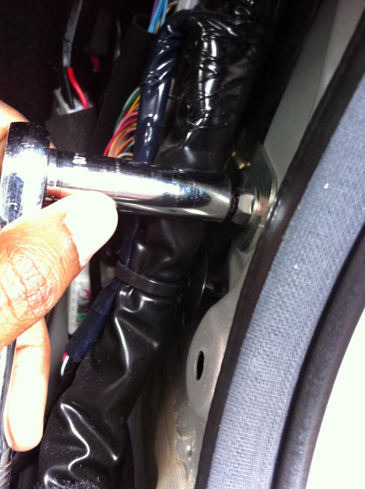

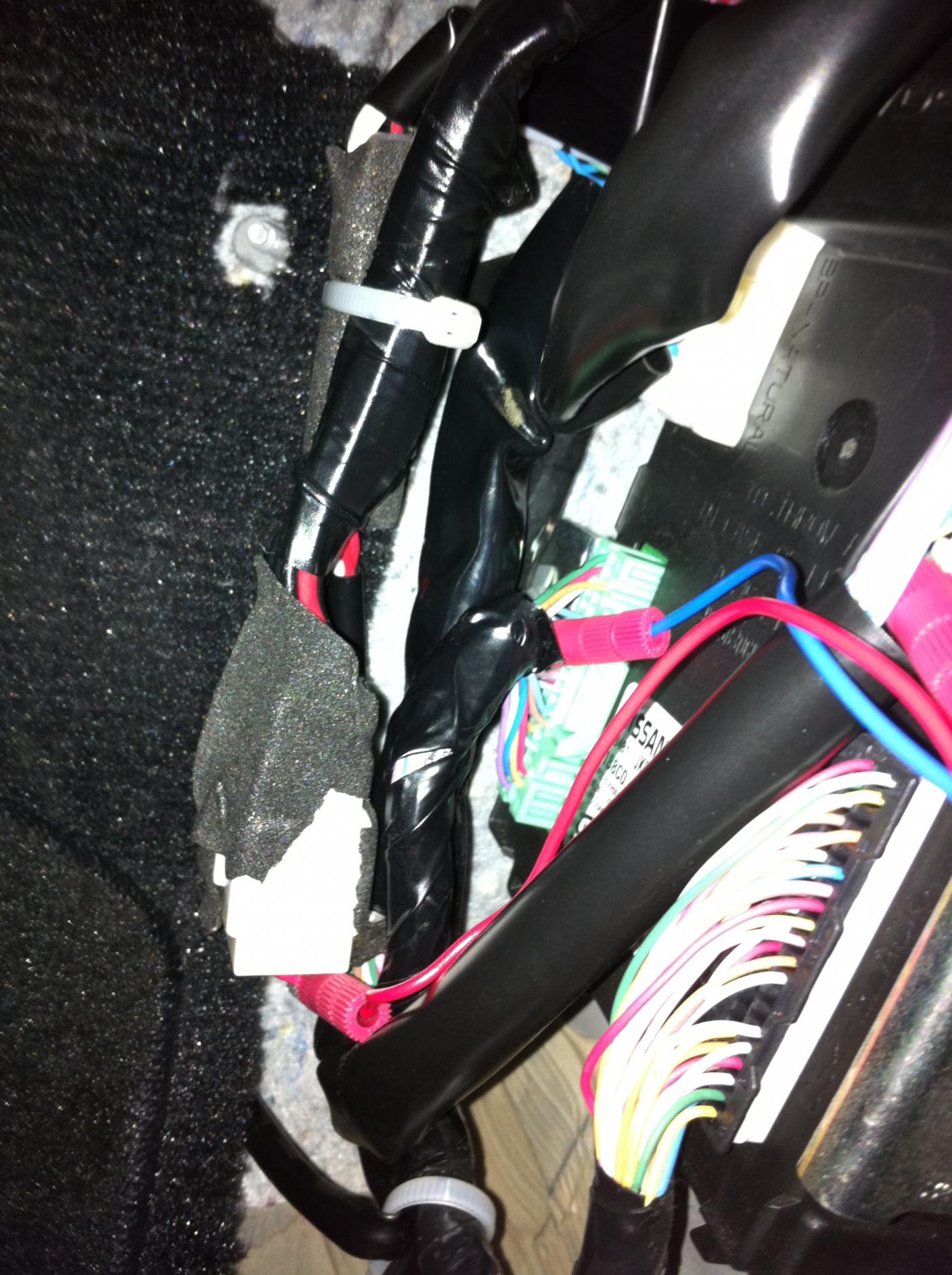

It came in today. Install was successful ladys and gentlemen . Here is what I did.
M121- tap into the red wire in cavity 50 to the brown wire on the sensor.
M119 - this plug is not located where it shows in the instructions. It's actually located a little lower, follow the plug that is where the M119 is supposed to be, and you'll see it connected to an adapter plug that plugs into the location shown by the instructions. The pins are the same, its a red wire in cavity 11.
M123 - tap into the with wire shown in the instructions. I'm not sure it is exactly in cavity 123 but its very close if not. either way tap the white wire there.
Mine came preset to 2 as the sensitivity. I have it set to about 3.5 and it triggers if I hit the body decently hard, and if I kick the wheels (no hammering of sockets possible with out triggering "I hope...").
Pictures below
Attached Thumbnails Factory alarm impact SENSOR pic-img_0170.jpg   Factory alarm impact SENSOR pic-img_0174.jpg   Factory alarm impact SENSOR pic-img_0175.jpg
