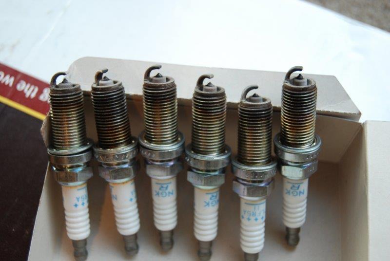

NGK PLFR 5A-11 from my previous 06 G35 6 speed replaced at 106k miles
I should have thrown these out 10 years ago
