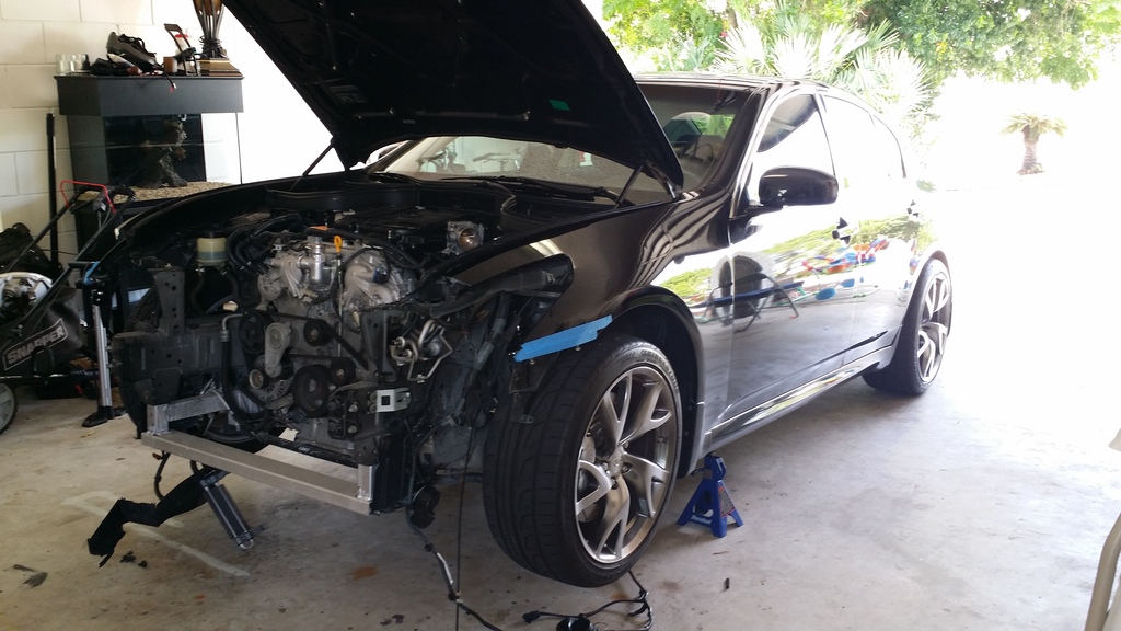

No, I'll be using a VQ37VHR bottom end with my 35 heads. Bottom end in my motor is going to need to be rebuilt and I can get a low mileage 37 bottom end for around $1200.
I started the tear down today...

^^ Nice! Definitely keep us posted on what you find. I'm sure we can all learn something from the process.

I called a few performance shops in hopes I would get a faster car out of the deal.
The best quote I got was for a hybrid VQ37HR motor build. They were going to use a 37 bottom end and use my heads and intake manifold. I will go this route with the old motor and reuse the heads.
The quote they gave me was $4600 assuming everything was good. That wasn't including a new CSC which i know it needs per the factory service manual, anytime the transmission is disassembled. I knew this was more than I wanted to pay.
I bought the replacement motor from a wrecked 2007 350z on eBay with 47,000 miles. My car has 78,000 on the body so at least I was getting a fresher motor.
After all supplies and tools needed along the way, I ended up saving about $2,000.
Took me a month of weekends but it's back to normal...mostly. I still need to go down and have the AC vacuumed down and charged. I was quoted $85, I just need to find the time to get down there.

35Sport, Did you have to remove any spot welds on the core support or was it completely bolt on?
Old 06-12-2015 | 11:34 AM
  #44
35Sport's Avatar
35Sport
Posts: 378
Likes: 59
From: Central Florida
The core support is 100% bolt on. The factory service manual that is stickied on the main page of the sedan forum helps a lot!
I did have to disconnect the 2 AC lines that run from the condenser through the core support however. This involves having to reclaim the refrigerant first before it can be fully disassembled.
