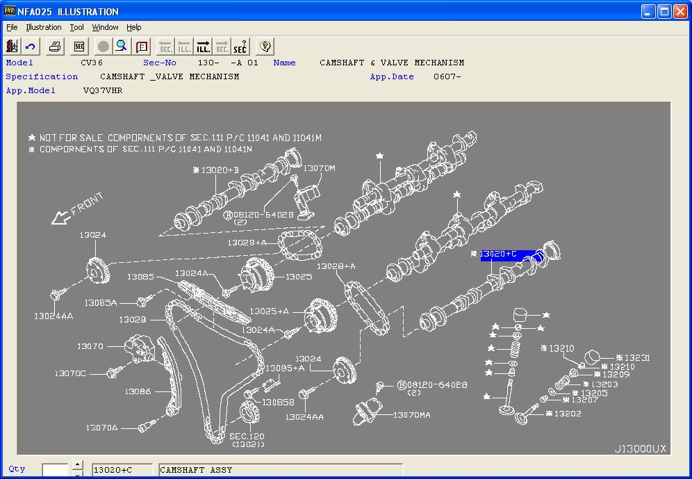

What I am saying is... If the motor already has variable Lift which will also change duration of the cam, wouldnt just programming it to adjust at different rates across the powerband benifit the same if not better than a cam upgrade... hence being able to adjust the amount of lift / duration through the power band...

Yes, that's what is so cool about the new VVEL system. Variable valve event and lift. Aftermarket cams are not necessary because the ecu controls the valve timing and lift now. It was mentioned about that a reflash of some sort could be created to tell the ECU to open the valves more just like some aftermarket cams would do.

VTEC simply engages an alternate cam profile (more aggressive lobes) at a certain RPM. It's literally a single cam with 2 profiles. VVEL uses output cams who's profiles can be adjusted independently by changing the fulcrum of the links that close the intake valves. There may be no benefit at all to changing cams in this motor. Like SlapinFunk said, a tune will likely be the best bet.

Yep Vanos is very similar to vvel but goes a step further. The new BMW V8 uses double Vanos which controls both the intake and exhaust cams which are variable across the motor's entire RPM range. The DME controls it and it's based on oil pressure and pedal position. The end goal is the same (valve event control) but the use of special cam grinds will probably be left to the domestics.
