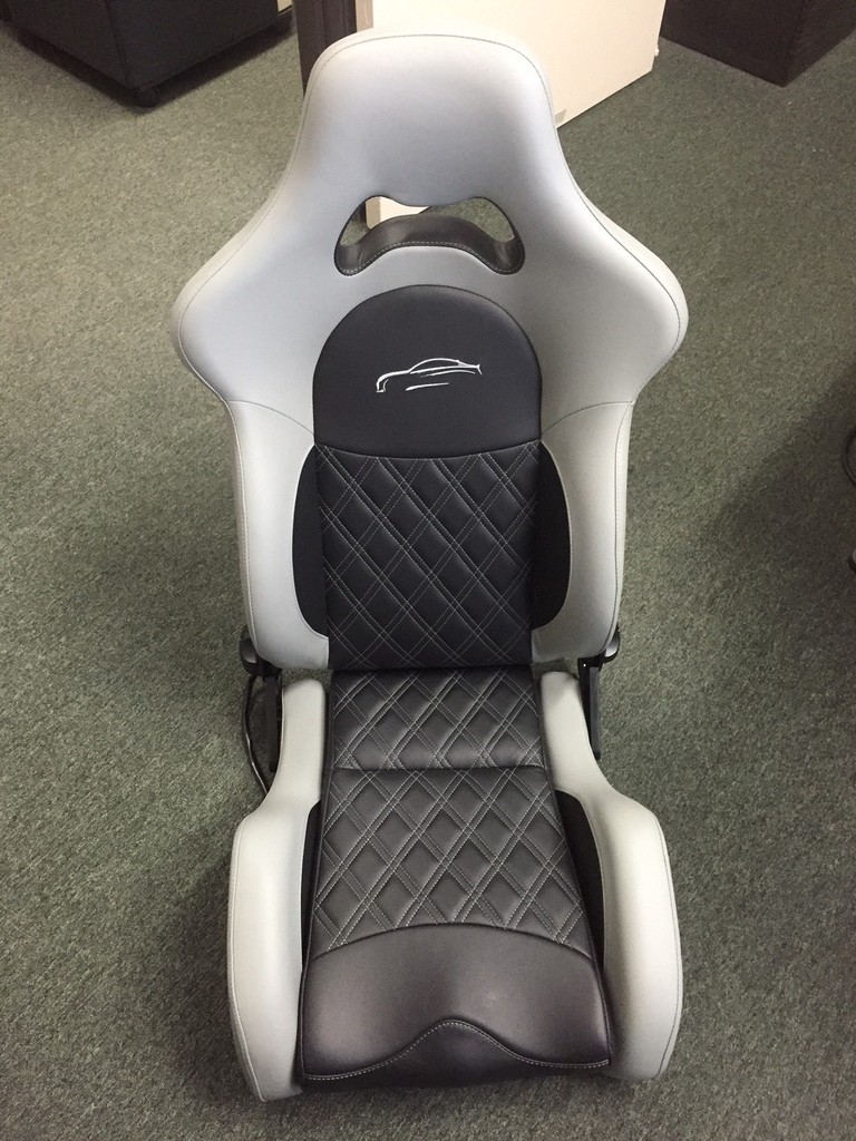

Originally Posted by 4DRZ
Any ideas or has anyone tried this on the sedan?
Something like this?
Old 11-18-2016, 03:11 PM

Rochester, that is a pretty cool seat, but I was thinking of something in cloth like below. I'm not a big fan of leather. A set of these would shave about 100lbs. out of the car. Now about the wiring....

Those leather racing seats are custom made for 2GoRNot2G. They're freaking gorgeous, IMO.
You know... not to toss cold water on an otherwise righteous idea, but racing seats in a sedan usually look pretty dumb, and impractical as hell. I know you track your car, which obviously changes what this all means, but still... It's a basic bread & butter family sedan, after all. Passengers in that narrow seat are going to hate you, man. At first it will seem cool, but 5 bone jarring minutes later, not so much. And if your passenger has normal hips (like a woman), or an old-man gut (like most of us), it just isn't going to work.
Have you considered getting *ONE* sport seat instead, just for the driver's side? You're obviously handy at taking the seats out, so swapping in the single sport seat makes sense when you're taking the car to the track, while going completely commando on the passenger side. And if you leave the sport seat installed while not at the track, so be it. You're the driver, after all.
wow this looks fantastic. do you know who makes them?
A company called Cobra
