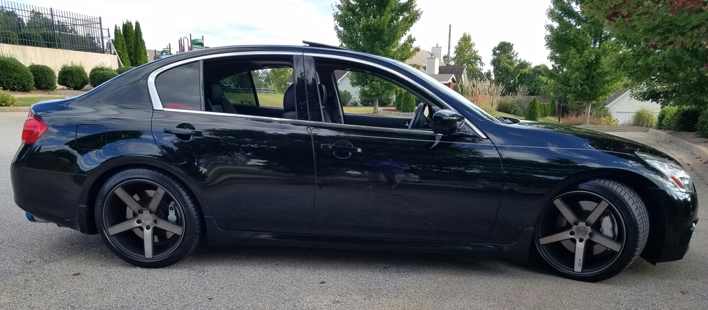

finally installed my coilovers (spc front and rears)this weekend..
i have not had it aligned yet.. i am sure it is totally out of whack
19x9.5 +35 et with 245/40/19 tires
after this picture, i adjusted the rears to match the front at 26.5 in height
this is still a good picture even if i dropped it a little more after
i tried to be straight as possible, but like i said,.... i still need an alignment to get everything proper like.

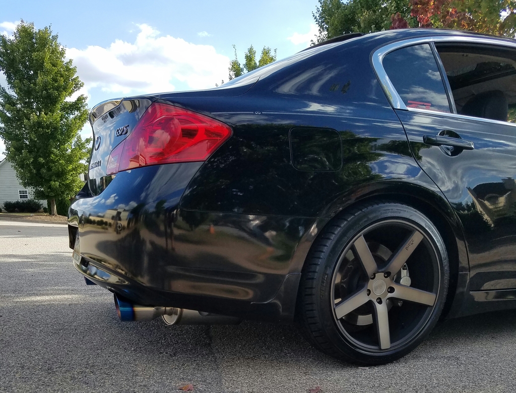

[/url]
19x9.5, +18, hubcentric, no spacers, 255/40/19, Eibach Pro-kit

Nice tight fit Bassy, well done. Got some pics down the side?

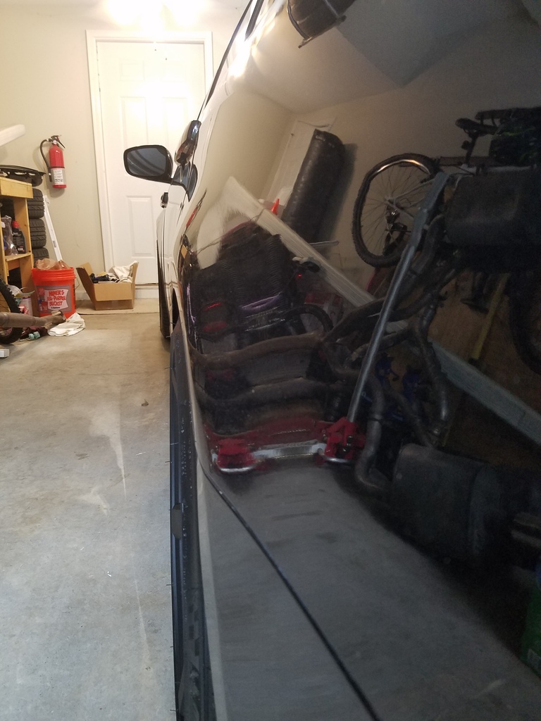

Thanks, Brad! I do have a few more pics.
Attached Thumbnails HELP~All squared setups please post here!-20161010_171224.jpg   HELP~All squared setups please post here!-20161010_171054.jpg   HELP~All squared setups please post here!-20161010_171007.jpg

Thanks for the shots, nice tight fit!

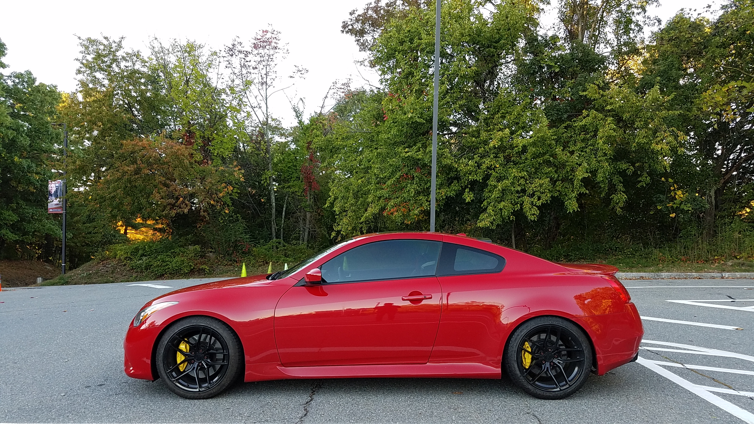

Have a 2011 G37xS Coupe dropped on Eibach springs (1.9in front and 1.6in rear). I am looking for specs for my summer setup. From reading some of these posts i am thinking 19 x 9.5 + 25mm offset or 19 x 10.5 + 25mm offset. What do you guys think?
Old 10-21-2016, 07:08 PM
  #675
VenomGT9
VenomGT9's Avatar
Join Date: Feb 2016
Location: Ft. Campbell / Chicago
Posts: 1,452
Received 226 Likes on 195 Posts
I'd say 19x9.5 but find a lower offset around 20 with either 255/40 or 265/35
