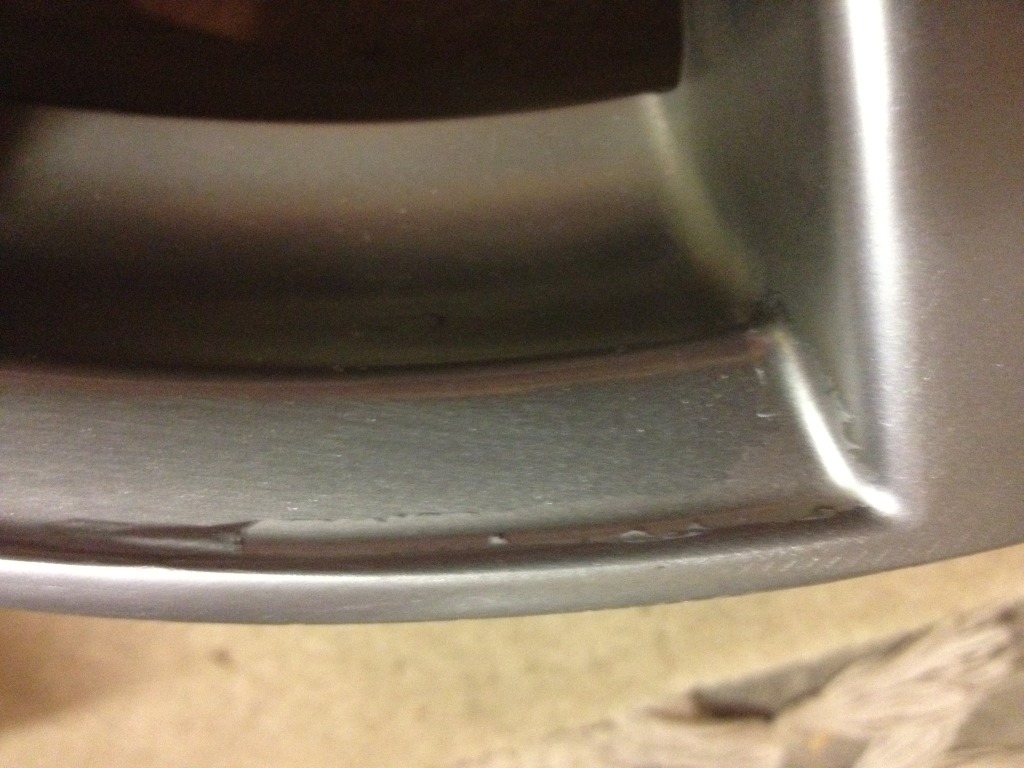

Bandit's 19" OEM Wheels have STREAKING & PEELING. Pictures Inside! Come look!
LOOK Down Several Posts. I ADDED New Pictures of the STREAKING that won't come off too.
Bandit here and sorry for all the threads lately. I made a seperate thread because this is a NEW SEPERATE ISSUES I am trying to figure out.
The quick summary is got a 2009 G37 Sedan, Black on Black 3 weeks ago. I just bought 19" OEM G37 Coupe Wheels off a local forum memeber who took them off his 2008 G37 Coupe at 23K Miles and have been sitting in his garage for a few years. I was seriously considering getting all 4 Chromed, but after hearing suggestions and getting a little gun shy about being too much of a PIMP with the Chromies, I am leaning toward putting the Coupe 19" Wheels on AS IS to see how they look.
The wheels I purchased were in great shape overall, except a shallow nick on the face of a One wheel spoke face. You can see some black through the silver finish that got nicked/peeled off.

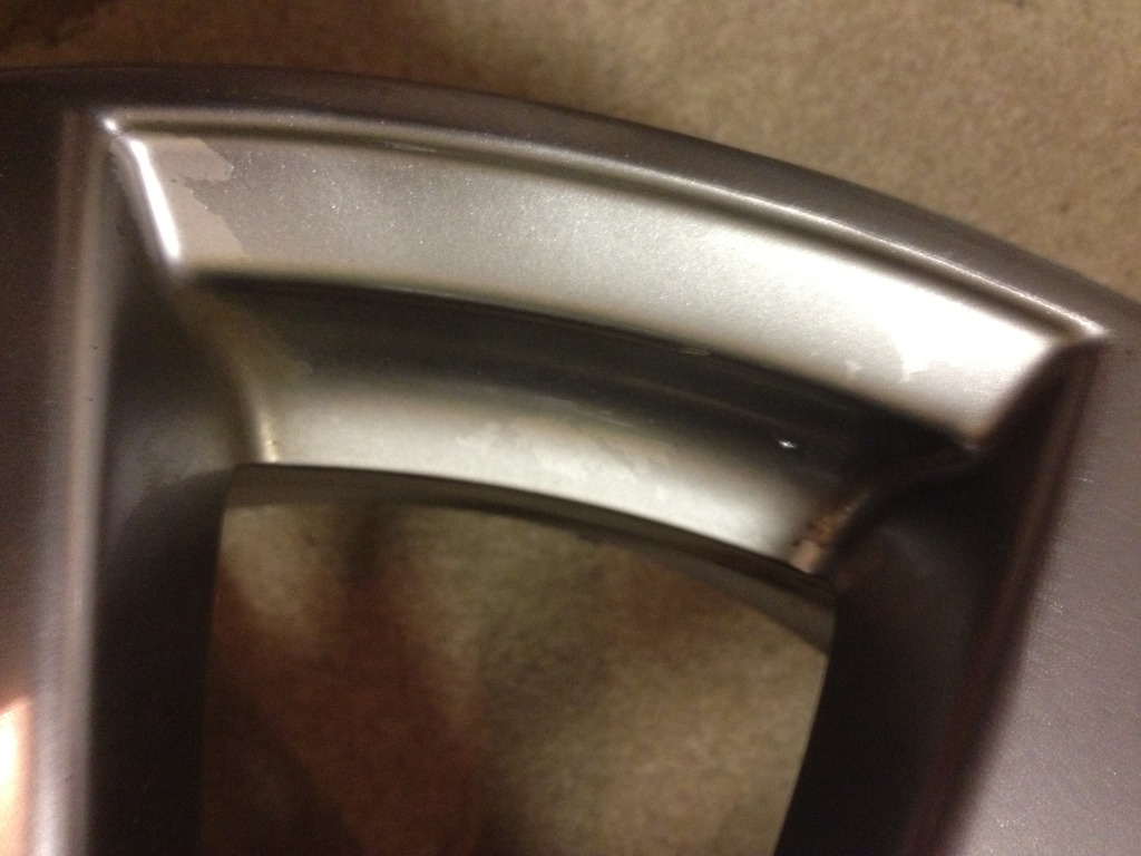

However, ONE Wheel in particular had some prtty bad peeling (Will include pics below). I also rubbed the peeling with my finger and it peeled off further. The memeber I got them from said he thought he had that one repaired in the past and it looked like the repair was comming off.
What should I do to fix the wheels to make new again? I am going to bring them to a LOCAL place in Dallas (Where I live). Anyone have any suggestions on a good place near Dallas that does good work on wheels, let me KNOW Please
OK, a Picture is worth a thousand POSTS.
This one shows exactly what I mean, by "Peeling".

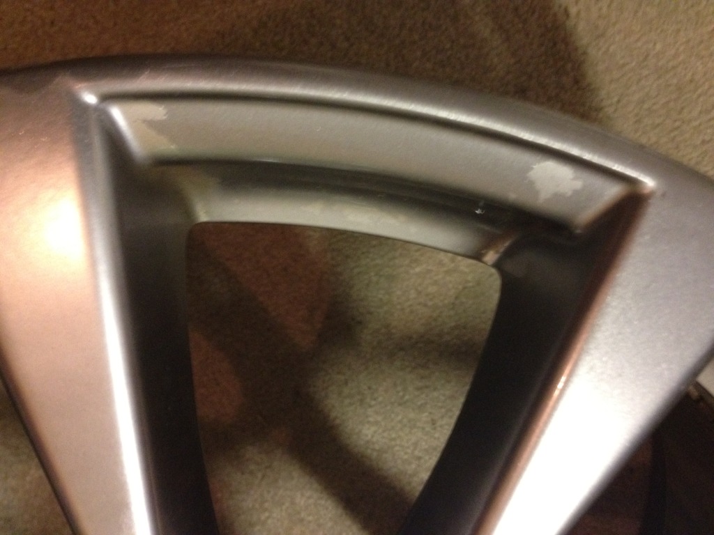

Same Wheel, different area.

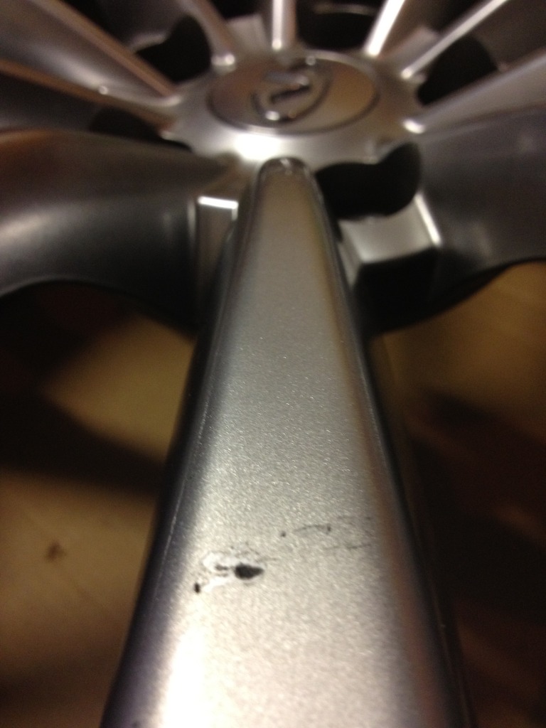

Here is the Surface NICK on the FACE of the Wheel Spoke I mentioned
earlier. It actually might just bemore paint peeling off and has black dirt/oil showing through the nick/peeling?

trouble is the color is hyper silver, almost impossible to match with touch up paint due to the 3 stage paint, so you'll have to get a repair place with something that is incredibly close. The paint is actually "illegal" in the US due to environmental reasons, which is why no one can get a perfect match here. Most wheel places have something that is so close you won't notice the difference though.

Looks like it's been refinished before and the paint/clearcoat is peeling off. It's an easy fix. I had 3 of mine done in L.A. for less than $200. Any reputable wheel repair shop can fix yours. If you pay more than $100 each, then you're probably paying too much.

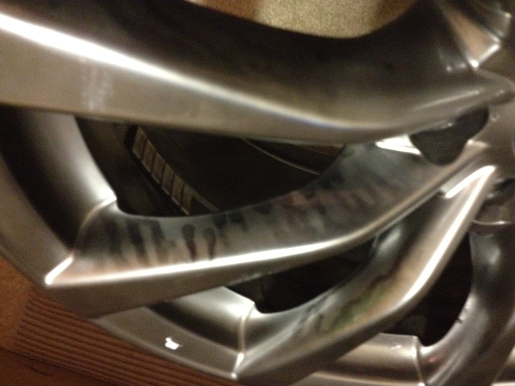

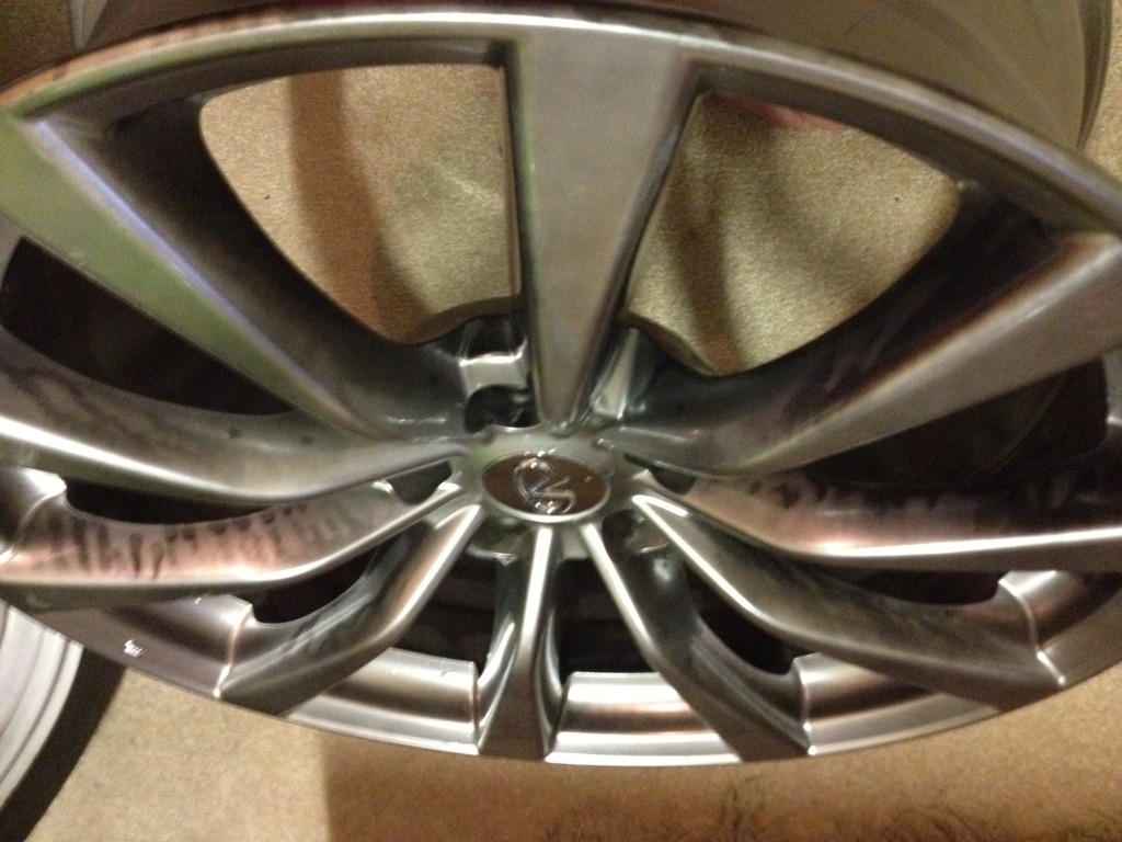

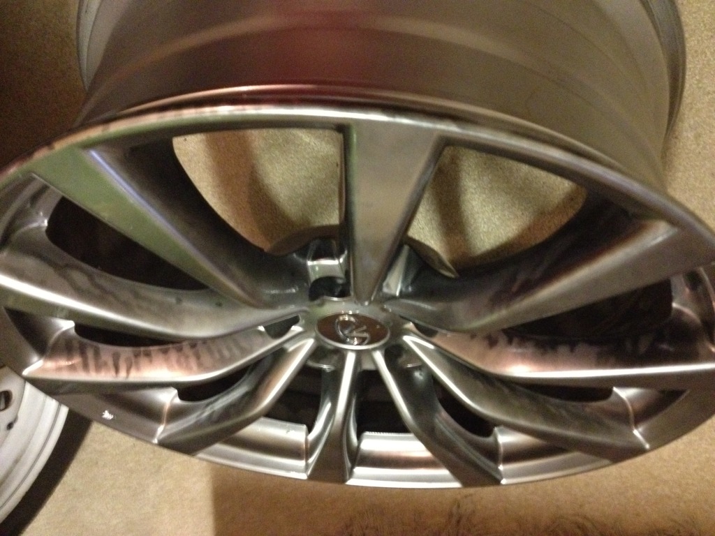

Tried to Clean my Wheels with Dawn and water first, then McGuires Aluminum Wheel Cleaner, didn't do anything.
Here is another 19" Wheel from the set I bought, it has streaking in several areas that won't come off. I don't know if it is oil and grime that was left on and burned into the wheel, or was paited or what? I am not sure if it can be professionally cleand and/or polished out?. Or, will I have to have the entire wheel repaired/refinished. It looks like I will have to get all 4 of the wheels I bought refinished or chromed at this point, if I want them to look new and can't get this stuff off.
Here are some pictures of the streaking I am talking about:

I have to say: I think these wheels were repainted by whoever you bought them from, and without much thought to prep work from what it looks like, or using the right paint. Repainting them again over this finish or touching them up will not solve the problem - just delay the inevitable.
Strip 'em and refinish professionally. But don't let a repair place convince you to take shortcuts to save $$$. They do need to be stripped to get rid of that flaking paint that isn't adhering to the wheels!

Here is the LATEST! I think I got it figured out now. I am going to Have EACH Wheel totally stripped down and redone m=by a reputable shop. I already checked credentials and they are GREAT!!!!!!!!!!!! I am adding at Michelan Super Sports (Similar to Pilot Sports, but better).

P.S. the guy at the place said the streaking looked like someone sprayed wheel cleaner on the wheels and left it on, after they sat for years in the gaarge, they ate throught whe finish. I showed him pictures.
