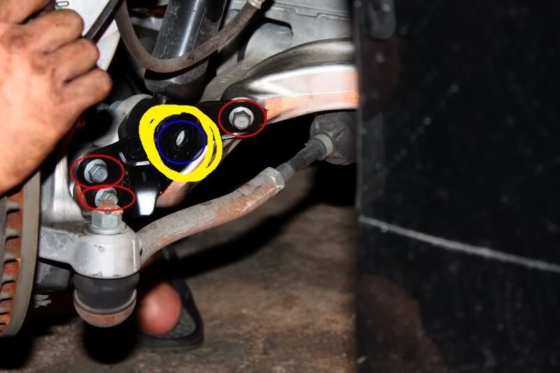

So today I tried changing out my springs back to stock and I got all 4 bolts out off on the front passenger side and it was a pain in the ***! On the driver side I could only remove 1 bolt, I tried taking out the other 3 and they were stripped or too rusted to even come out. I tried using WD40, torching it and still nothing. One of the bolts were halfway screwed out but won't screw back in!!
So I have a question 2 of the bolts aren't screwed all the way. I plan on taking it to the shop because I can't deal with it anymore. Would it be okay for me to drive 5 miles or so with the 2 bolts not screwed in all the way? Thanks in advance!

So I tightened up all the bolts except for the one with the yellow circle, that one won't unscrew or screw on. I have no idea what to do! I'm thinking of driving to the shop with it a little loose but not sure if thats a good idea. Should I just cut off the bolt and add a new one?

What are you using to take them off?
1. Use an impact wrench. There should be zero problems if you use the correct socket and the impact wrench.
2. If you have already managed to "strip" (I am guessing the bolt head) then you really don't have any choice but to cut them. Are you using the incorrect size socket? Why are they stripping?
3. If you don't have an impact wrench use a pipe for an extension to your wrench for leverage.
4. If all else fails and your bolts are that seized I don't think that going 5 miles is going to be a problem. Your obviously taking the risk of it coming off, but the worst that can happen is that your suspension fails and your riding on tire.... Worst case scenario your only out 2-3k in parts.

Used an impact wrench with the correct socket, when I try removing it the other side starts to spin as well. I hold the bolt on the other side with a wrench while using the impact wrench, still nothing! I might just go ahead and cut it off, Is the picture I showed the control arm bolt? I might have to go to the dealership and pick up the right bolt, or go to the hardware store. Also the bolts aren't really stripped. I just feel like the impact wrench im using isnt strong enough.

Try a breaker bar. Get a good distance and give it hell.
Wedge a crescent or whatever you are using on the rear so that it holds when you rotate the other side.
I have a steel pipe I use for pain in the *** bolts.

I GOT IT OUT!!!!! Holy hell that was hard, the bolt was completely rusted! Thank you for the suggestion!
