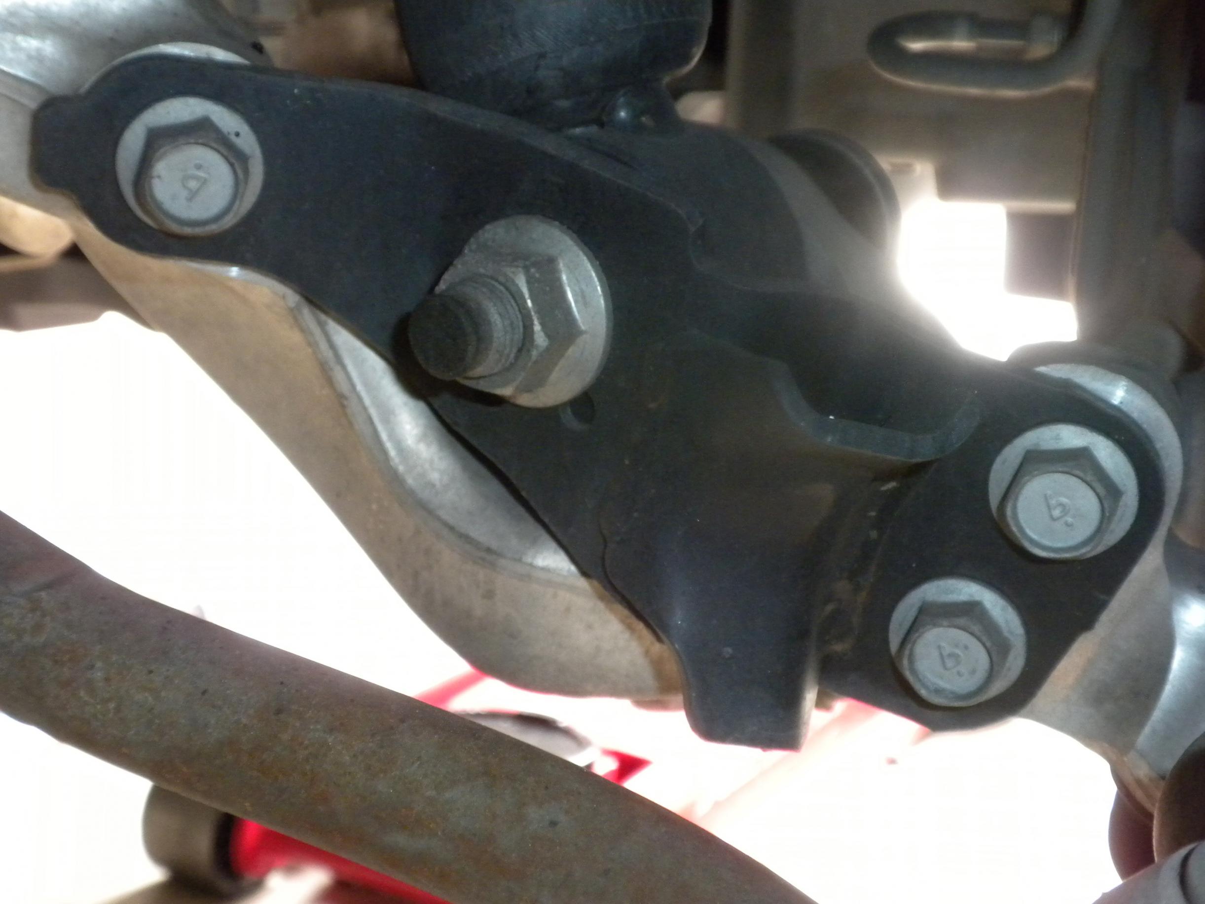

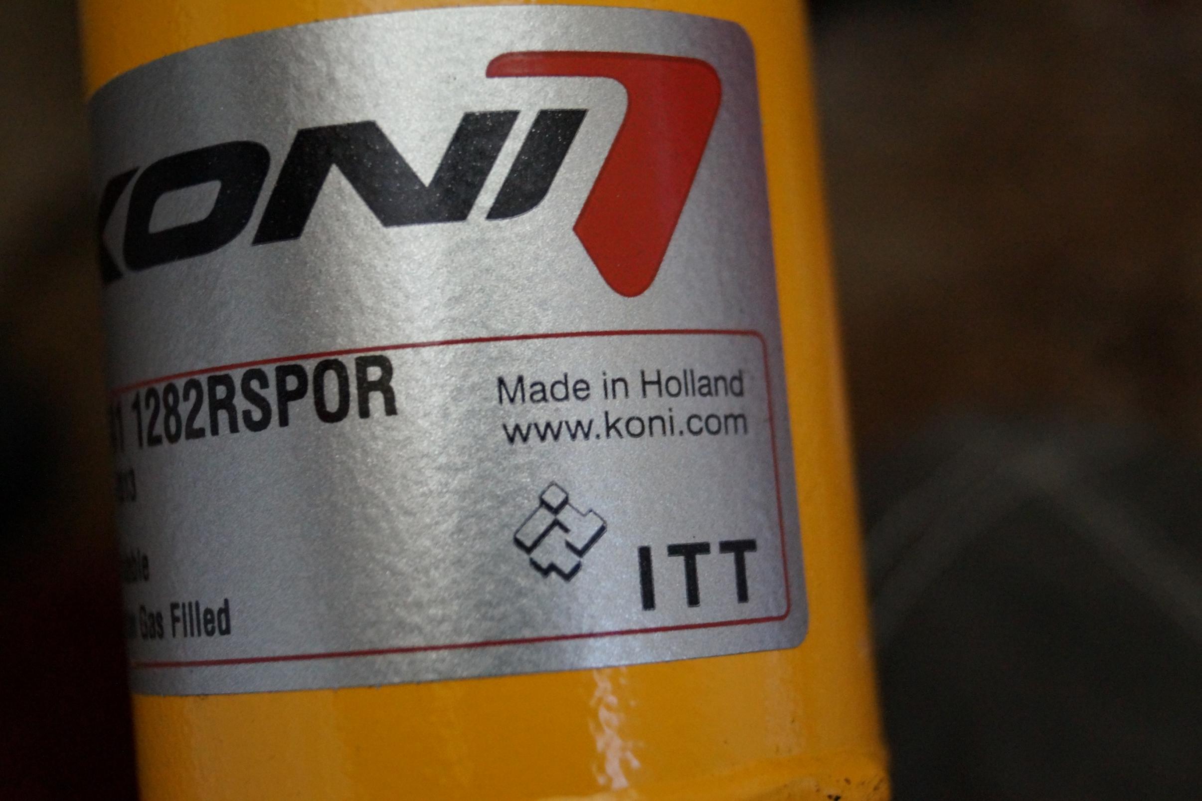

Over the weekend I installed Koni Yellow shocks for a 370Z/G37 coupe and Swift RWD sedan springs. Koni doesn't list the sedan as being compatible, but I risked it
Installation: I did it by myself. It kinda sucked. A helper would have....helped
The shock through bolts are a known as a bitch. On the drivers side, I realized I was torquing down on the suspension. I supported it with a jack, and the bolt came right off.
The orientation on the passenger side is different. Lefty-lousy is up. There wasn't enough space to do the wrench/floor jack technique. I put a 6 point wrench on it, hanging down, and beat it with a dead blow hammer.
Everything about the install is straight forward, the fronts are secured by 3 buts at the top, the through bolt below, and a bracket with 3 more bolts. Remember to route the brake lines properly. I didn't and had the joy of taking the first one back out.
I rented spring compressors from Auto Zone, pretty easy to use. The fronts didn't seem to be under any compression. You could probably just take the top hats off. But danger and all that. I only had to compress the front Swifts a little. Again, if you had a helper, you could probably push down on the springs enough to get the nut on the shaft. Compress the springs, remove the top hats, reassemble. Done.
The rears are even easier. There are two 12 mm nuts at the top, one 17 mm at the bottom. Remove the three bolts, take the top hats off your stockers, assemble them with the Konis. Done.
Highly recommend 6 point sockets if you are going to DIY this. An impact wrench would be awesome too.

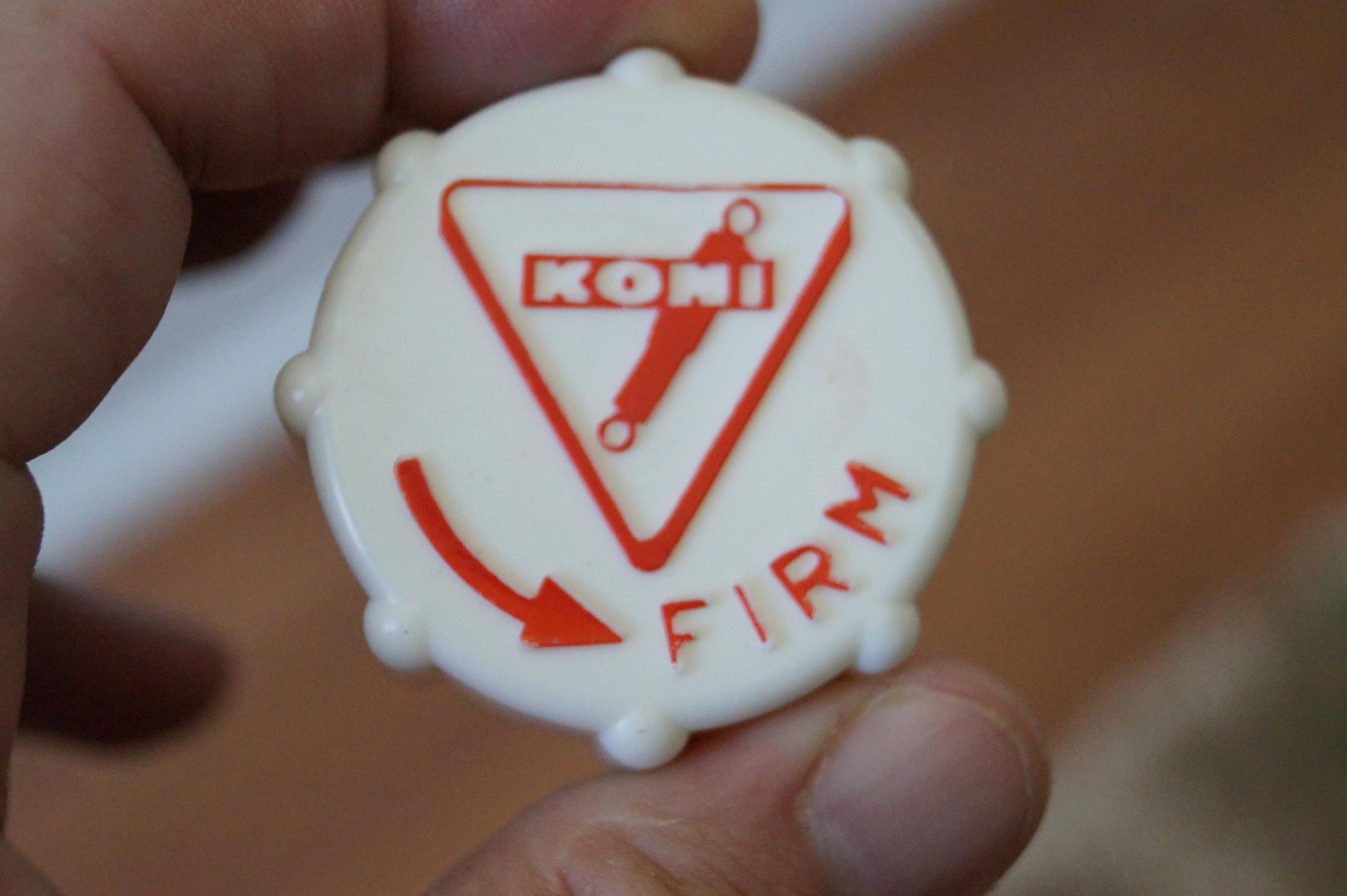

The rears dont use a **** to adjust. They have a window with 2.5 mm hex indents at the top of the shock. You stick an allen wrench in and turn. I'm not sure if I'll be able to adjust them on the car yet.
