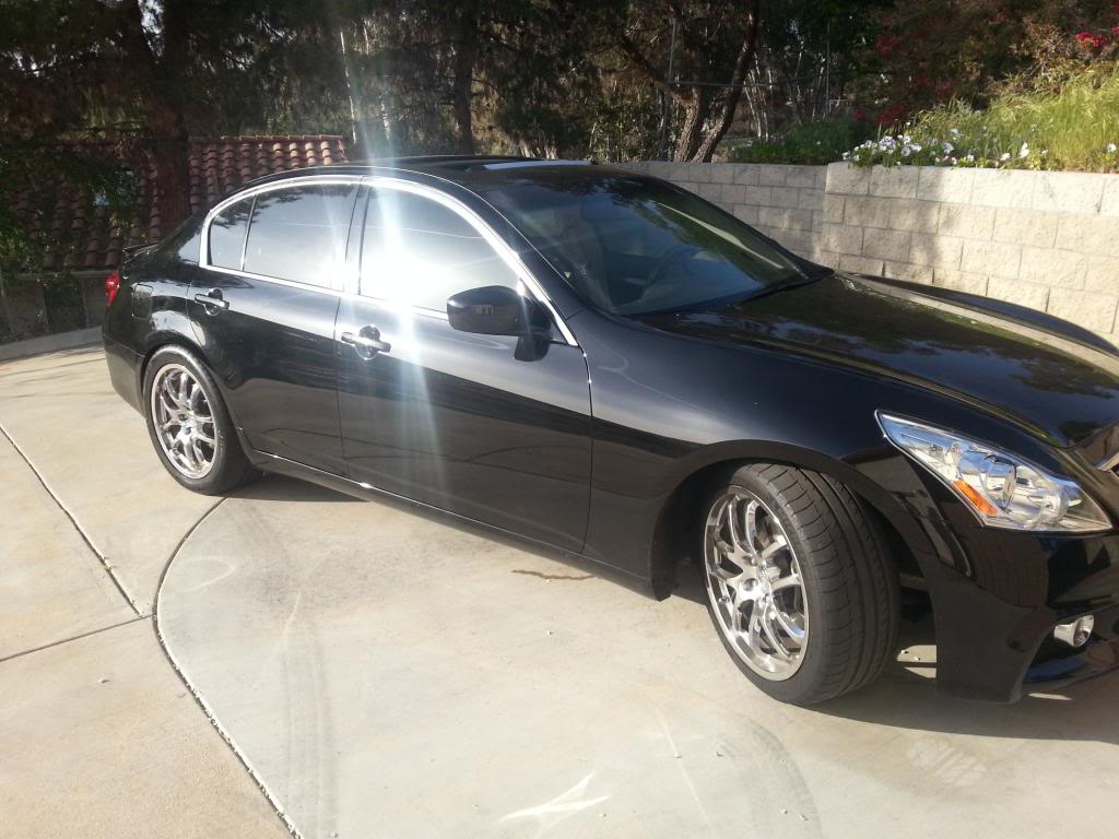

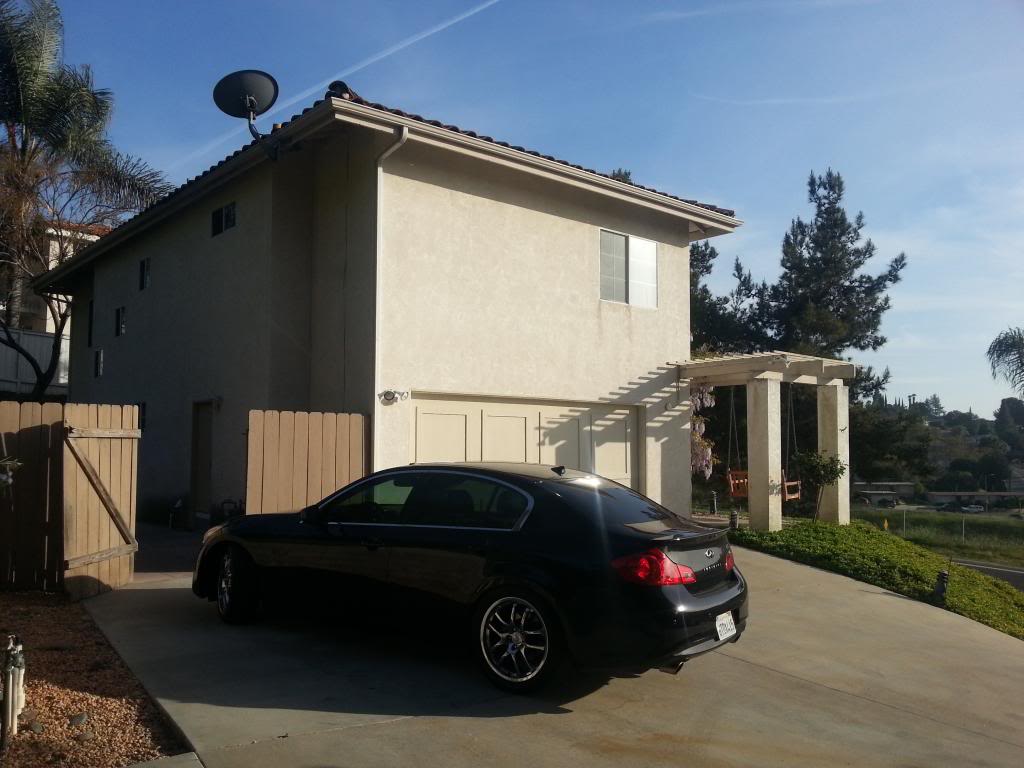

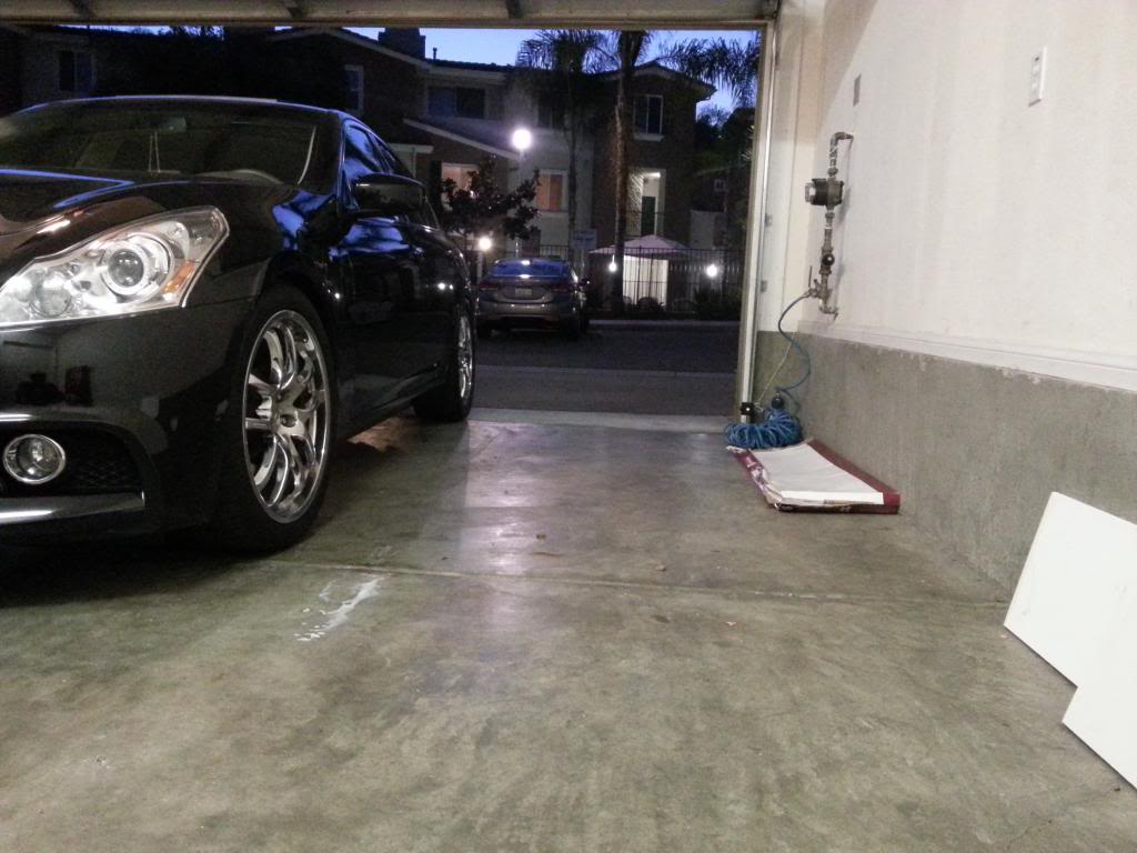

Here's a few pics of my car. I know, I'm a terrible photographer. The car looks better in person.
I'm not much of a fan of chrome but it doesn't look bad. I originally wanted 370z wheels but had a hard time locating a set.

Do you have stock wheels to swap?

No, I wish. I sold them shortly after putting the rays on. Had I known they were going to give me these problems about the wheels I would of kept them.
