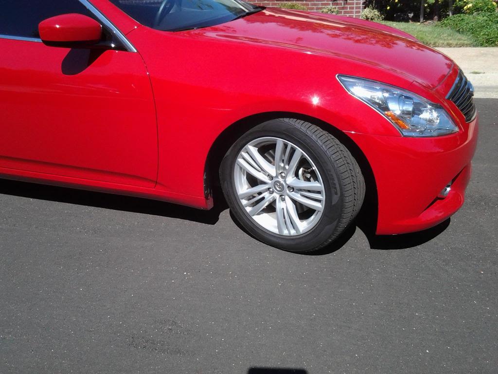

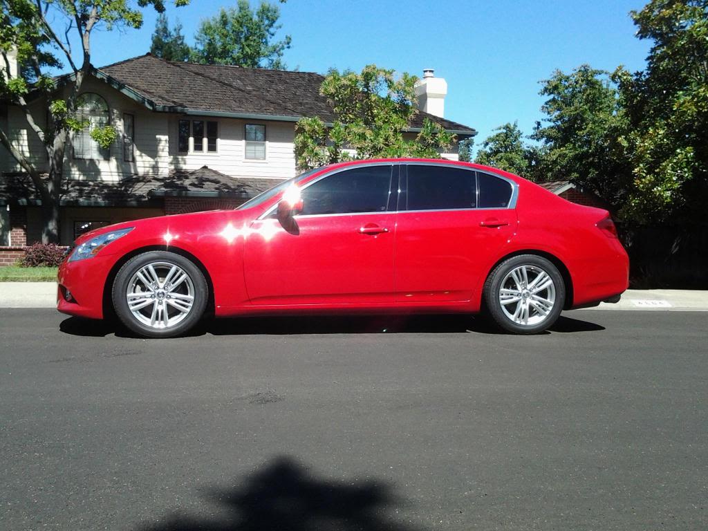

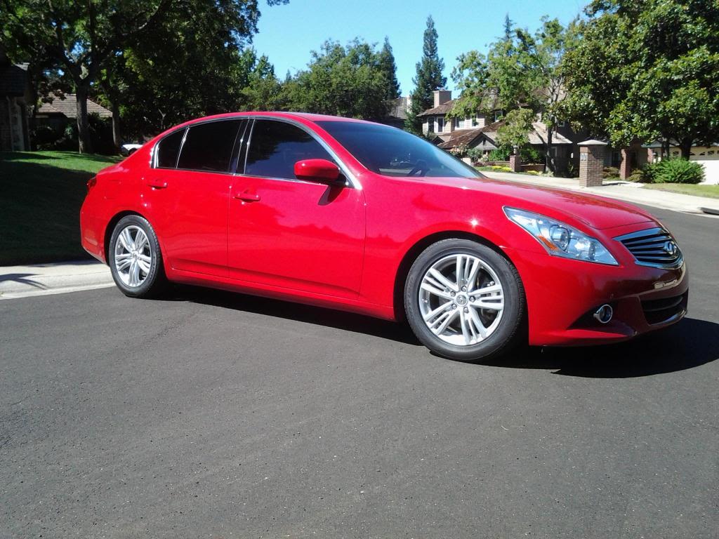

Hi All,
Finished the Rear last night and was exhausted. So posting pics that I took this morning.
Started out:
28" all around.
Final score:
26 7/8 front
27 1/4 Rear
I am running 5 twists out of 10 for rebound adjustment. It's not as easy as a clicker adjustments like a bike shock but it's easy enough.
Thanks for all the help that you all offered. And thanks for the funny comments too. Next week I will be driving in the Sierras for vacation so I should get a good idea of the performance improvement.
But my driving impressions so far:
Soft Ride! Not as stiff as my 2000 Camaro SS with Eibach and Bilstien from SLP. It may have something to do with the 17" wheels and 55 profile tires. the front end does not wallow now when I turn in to a curve. And the traction control is kicking on after the apex of a fast turn if I step-on-it. A little more noise from the fronts, so I greased the spring seat, and it quieted things down. Definitly acceptable noise. The car sits about 1 1/4 inch lower so I will have to be careful with parking stops, speed bumps and driveways. But I don't think the drop is excessive. All in all, I am a happy camper.
After vacation, me and a friend are taking our cars out to Santa Clara and will do some night driving on in the coastal mountains. He has a 2011 mustang GT with the Brembo package, so I can't wait to see if I can keep up with him as he is a nationally ranked motorcycle road racer so he knows his stuff. Should be fun. And I promise no street racing stories... That's a rule right?

Very nice drop Scott, glad everything worked out so well, no pain no gain right
Springs may settle a bit more, as of now looks like a perfect drop for a daily driver, should be easy to navigate the speed bumps, steep drives etc.
Thanks for the review!
