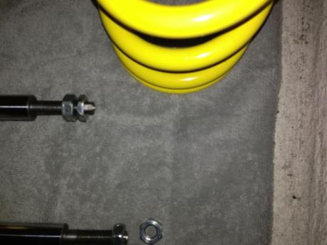

Yes, the nut that hold sthe upper mount to the strut rod...except I didnt get a large one. I got what you see in the pic below.
What you're looking at is the tip of the strut rod with the nuts attached. Eeach of the rear strut rods came with the two nuts you see on there.

Thanks for the info.
As for the nuts, I have a seperate set for the the bottom.
Originally Posted by soundmike
Not sure about the V3, but the two nuts included for your rears could be (1) for the top mount and (2) for the bottom, if it's not welded into the shock body like it is for OEM.
The bottom rubber mount will act like a spacer. Personally, i'd go without it if that's what's recommended for your application. Any spacer to the spring, multiple by about 1.6 IIRC and that's how much height you'll gain -- or basically, if it's 1" tall, expect a 1.6" height increase.
The top mounts should be manually torqued down, but you need special tools to hold the nut while using a torque wrench to tighten things down. If your hands are "calibrated" you can just tighten by feel.
Worst-case scenario, you can theoretically use an impact to tighten it, but make sure it's just 2-3 very short quick bursts at high power. This will cause the nut to turn before the rod itself will turn. If you just keep hitting it with the impact, the whole rod will just keep spinning, causing damage.
