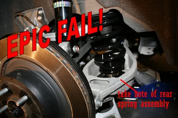

call pete at bc and listen to what he says, he knows what he is talking about and is a good dude. i have the bc on my X and i had a ton of problems because of the weight of my car, but a new longer rear strut and spring spacer in rear corrected all problems. now i just gotta figure out why my car is so bouncy and handles not as good as the old setup.
