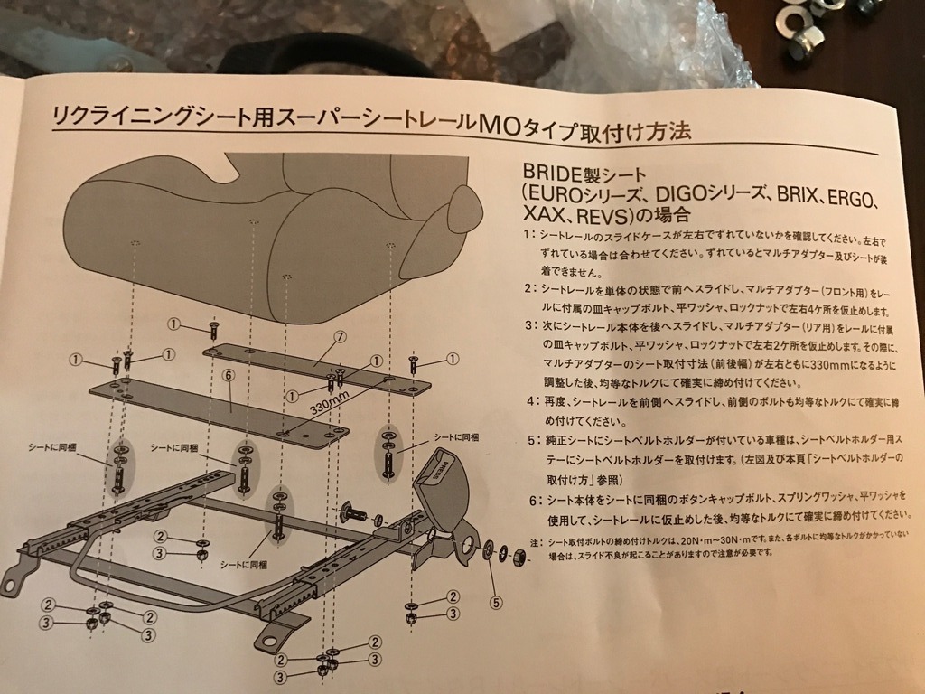

So I just spoke to a rep at Sparco and a rep at Corbeau with some questions. It looks like the Sparco seats will match up to the Bride rails exactly as they are all 271x345. Bonus! Thank you 2GoRNot2G.
Corbeau had their dimensions in inches 11 3/8 x 13". The 13" is front to back and translates to 330.2 mm so that should match up. The 11 3/8" is 288.925 mm so I am assuming they will match up or I may have to modify the holes slightly.
The guy at Corbeau said their seat rails with slider are only 8-10 lbs so if the Bride rails really are 15-18 lbs, that means the Corbeau A4 with their rails could weigh as much at 15 lbs less per seat. However, this would also mean that I would need to pick up coupe seat rails and try to have them modified to fit.
The guy I talked to at Sparco also recommended I take a look at the Chrono Road seat. I had previously passed on this seat because I thought it was only in vinyl according to their website, but it is available in cloth.
The holes in the mounting plates that Bride supplies with their brackets/sliders are elongated, so you do have a little bit of adjustability for variation between seats.
I believe most manufacturer's list the weight of their brackets without the top mounting plates. The Bride brackets came with those mounting plates separately so the brackets themselves probably only weight about 10 - 12lbs, but the mounting plates are pretty beefy and probably weight another 5 lbs. I can't see how you could make the bracket much lighter unless you made it our of aluminum, but then you'd probably need to make it out of thicker material so it would be strong enough to hold up in a crash. Also worth mentioning is that the Bride brackets come with the seat belt mount (for the OEM lap belt) on the slider where some manufacturer's don't even supplied a bracket for mounting the OEM lap belt.
All that said, I would just go with the Bride brackets. It will just make the whole install more straight forward and simple taking out a lot of the hassle for you.
Also, I really like that Sparco Chrono seat. I think a pair of those is well suited to the G interior.

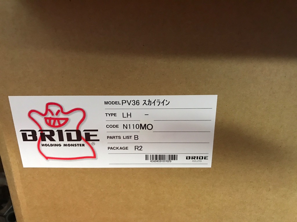

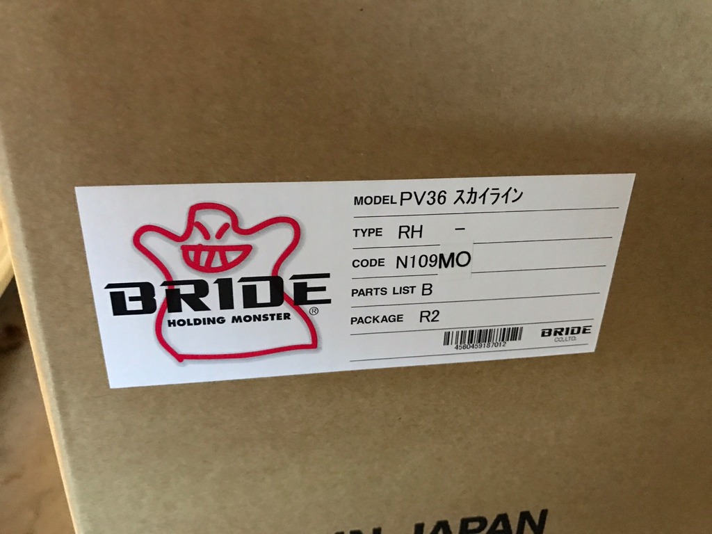

FYI... Here are a couple of pics of the Bride bracket boxes so you will have the correct part numbers for the sedan brackets. Also included a pic of the instructions showing the seat mounting plates and seat belt mount I was talking about above.
Size:  137.5 KBName:  IMG_0287_zps2diojz7k.jpg
4DRZ (05-12-2017)
Thanks for all the good info. You are like my aftermarket seat hero! I am beginning to agree with you on the bride seat brackets. How long did you say they take to get, about 6 weeks?

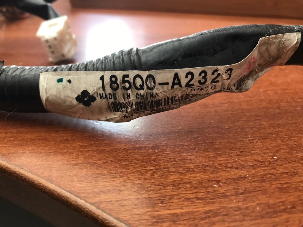

Also, here's a pic of the driver's side sport seat wiring harness part number from my car.
