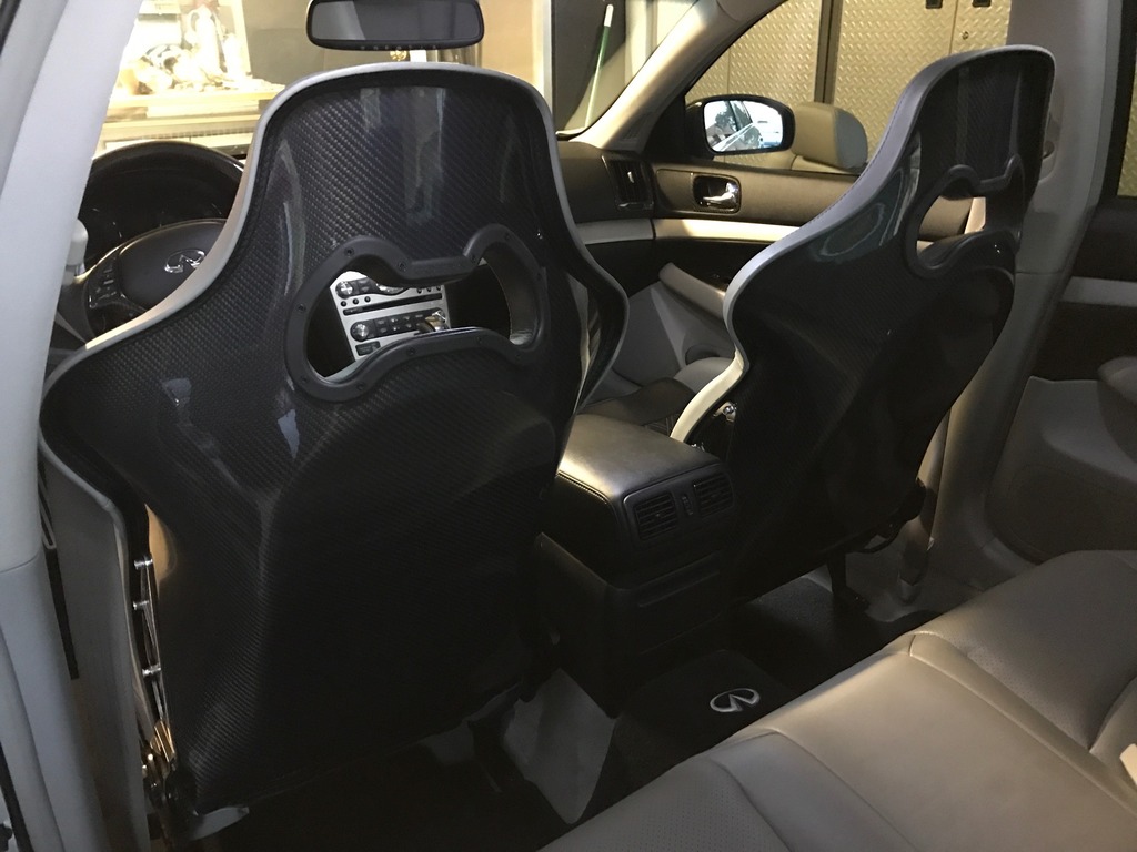

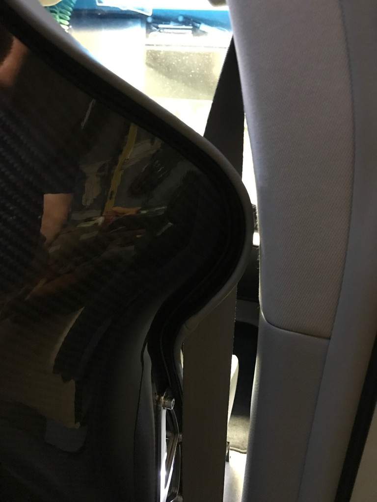

One other thing to keep in mind is you should pay close attention to the width of the seat at the widest part of the shoulder bolsters. Mine sit within millimeters of rubbing my B pillar and when I originally measured them I thought I was going to have plenty of clearance. Although the wide shoulder bolsters do make for a nice holder for the shoulder belts!

Good point! I originally thought the Sparco R333's were going to be way too wide from the pictures, but it turns out the measurements were actually a bit more narrow than some of the other seats.
Do you have that measurement for your seat just so I can compare. You are right, that looks really, really close!

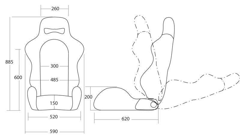

Listed below are the complete dimensions for the Cobra Misano 30th Anniversary seats that I have. Shoulder bolters are 590 mm (~23-1/4 in) wide. Thankfully the Bride seat brackets had slotted mounting holes which allowed me to slide the seats as close to the center console as possible, otherwise those outer shoulder bolsters would be constantly rubbing the B pillars. Ideally you will want a seat that is 22" wide (so 1/2" more clearance per side) or less. Incidentally, Cobra would have custom made these to my specific dimensions at no additional charge if I had known in advance that they were going to be a tiny bit too wide. Oh well, live and learn!

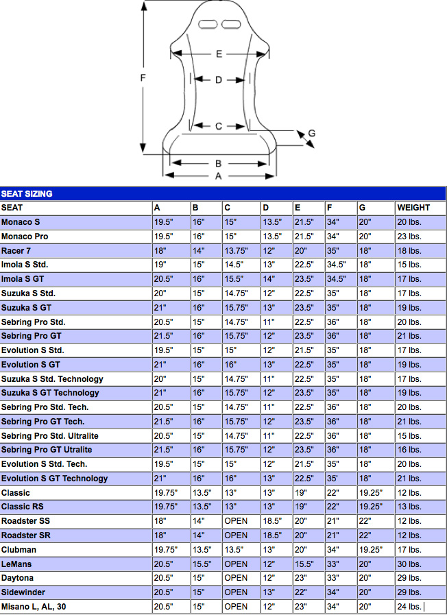

FYI... It looks like the Corbeau A4 seats are about 21-1/2" at the shoulder bolster, so those pit just about perfectly with about 3/4" of extra clearance per side.

Thanks for posting up the width of your seats. I found that sizing chart too as I remembered you had Cobra seats, but I could not remember the specific name to save my life.
Fortunately, the Sparco R333's are 520mm at the widest part of the shoulders or just shy of 20.5" so I should have plenty of room there like I do with the Corbeau's.

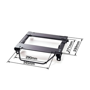

I didn't actually think of weighing the Bride brackets along with the bottom mount adapter plates, but if I recall correctly the total shipping weight was around 20 lbs per box, so each bracket probably weighs around 15 - 18 lbs without all the packaging, etc...
The Bride brackets will fit most Sparco and/or Cobeau seats, you just need to confirm the mounting pattern and make sure it matched up with the ones listed in the below dimensional diagram.

So I just spoke to a rep at Sparco and a rep at Corbeau with some questions. It looks like the Sparco seats will match up to the Bride rails exactly as they are all 271x345. Bonus! Thank you 2GoRNot2G.
Corbeau had their dimensions in inches 11 3/8 x 13". The 13" is front to back and translates to 330.2 mm so that should match up. The 11 3/8" is 288.925 mm so I am assuming they will match up or I may have to modify the holes slightly.
The guy at Corbeau said their seat rails with slider are only 8-10 lbs so if the Bride rails really are 15-18 lbs, that means the Corbeau A4 with their rails could weigh as much at 15 lbs less per seat. However, this would also mean that I would need to pick up coupe seat rails and try to have them modified to fit.
