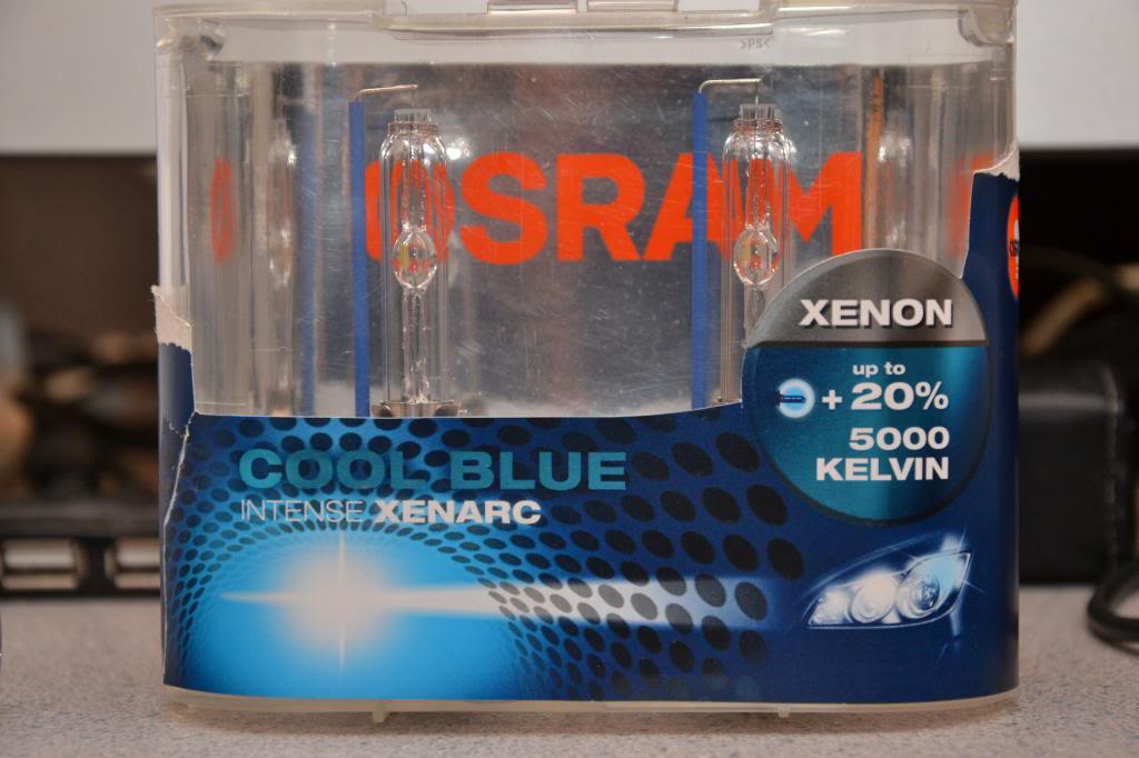

Not sure if this is out of content, but is anyone interested in purchasing the Osram bulbs?
Please PM me for details.
