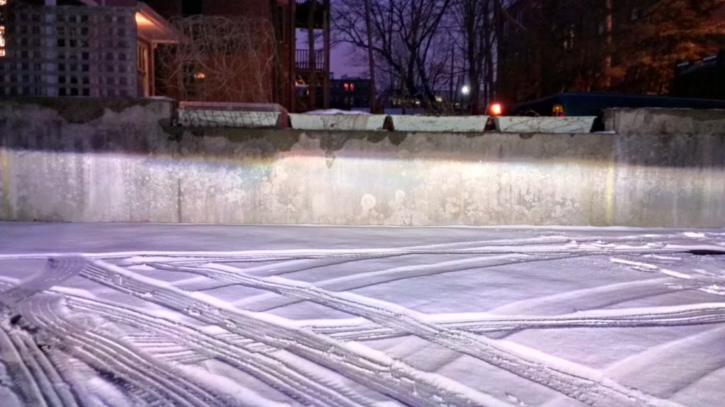

Here is a quick pic from my HTC One S:
Is this better?
Picture was taken at about 15ft from the wall and ground was not level.
Please leave any feedback regarding the alignment or anything positive or negative about them.
Although, the cut off isn't very sharp I think it is much better than it was before.
They are still within the break-in period.
Is this better?

#58
Hard to tell.. I would like to see a nighttime shot.
As for alignment, it should be a 2" drop every 25' so find a level wall park 25' away measure from the ground to the center of the projector.. And then lower or raise your "step" <--- (the center of the light beam) to fall 2" shorter than your previous dimension.
#59
Yeah, I can't tell either...something does seem off with the drivers' side. The color is different (more purple on the left?), and you can see a halo effect on the driver's side headlight and none on the passenger's side.
You're supposed to see the beam patterns of two headlights ___/----___/----, but you only see one. It seems that one beam might be overpowering the other beam...
Granted, your bulb won't be sitting in the bowl per OEM specs, so this is expected. That arc in the bulb should be in the same location as before, but now it won't be, so your light output wouldn't be the same as OEM anyways.
I think the way the camera captured the picture might have gave it a purple tint...the light output is definitely white.
Only the cut off has a bit of color...yellow, green & blue.
I think that my projector lenses might be part of the problem...can they cause the halo effect?
