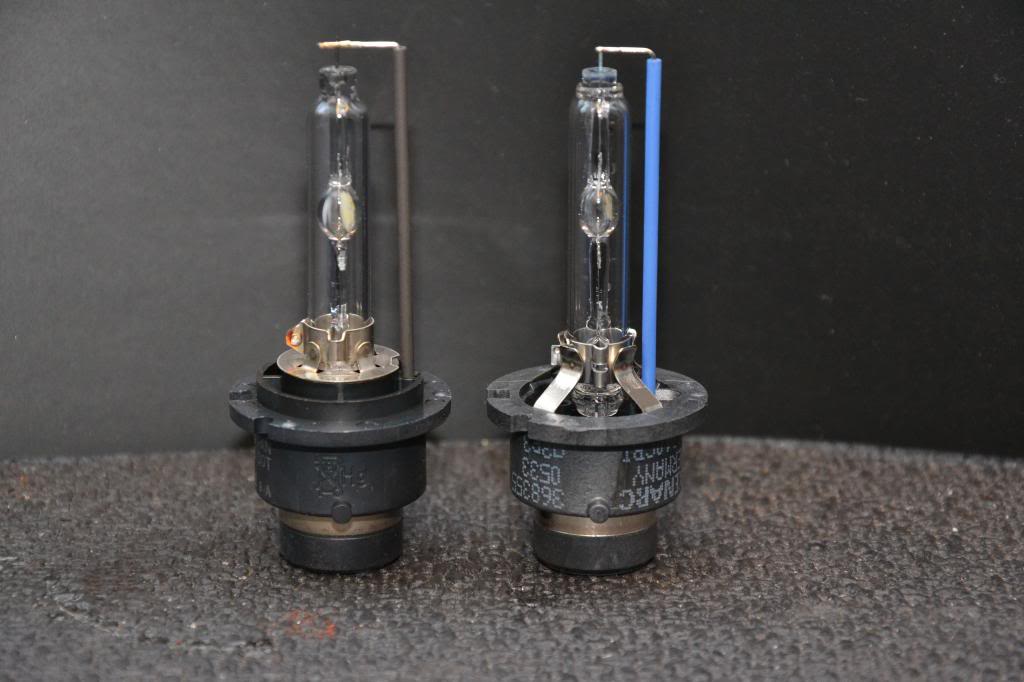

Problem Solved!
UPDATE:
Went for a second opinion and came out with better results!
Took a visit to Royal Wheels & Tire in Arlington, MA and had John install the Osram's.
What he found out was that when JT Motoring installed the bulbs, the installer broke off a piece of the plastic tab that holds the wire clip...which keeps the bulb in place.
This was the cause of the issue...the bulb was not aligned correctly and was sitting loose.
Also, when John went to remove the stock OEM Hoito bulb...it wasn't even clipped in!
John managed to clip the bulb in and reassured me that it was fine and shouldn't have anymore issues.
Now everything seems to be good!
I just need to allow the Osrams to burn-in to their brightest point and I'll be happy...still a bit yellow right now.

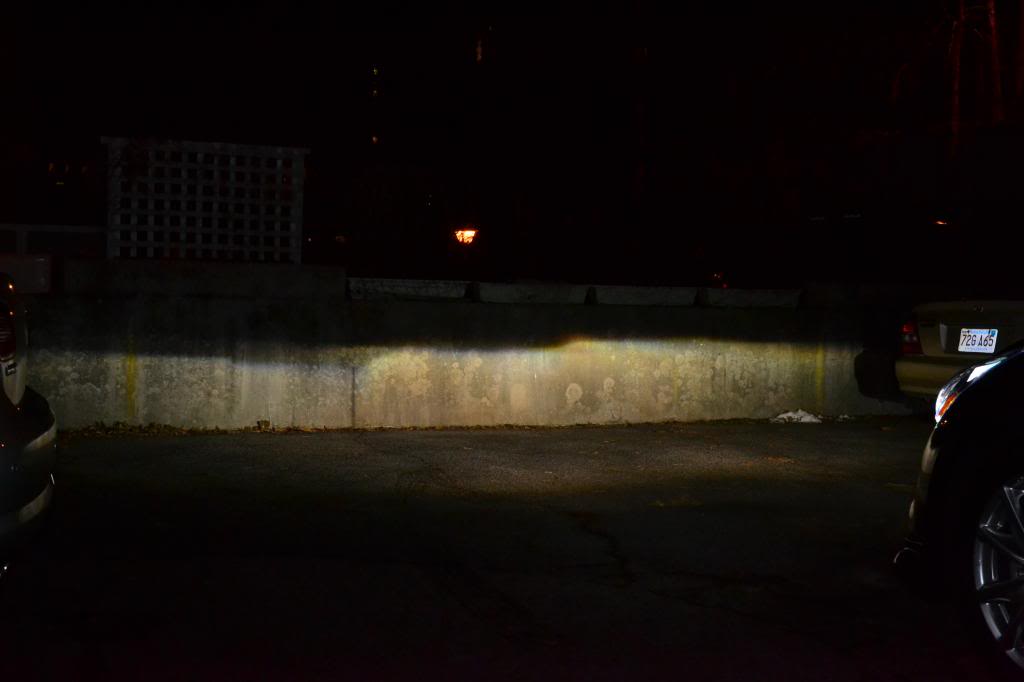

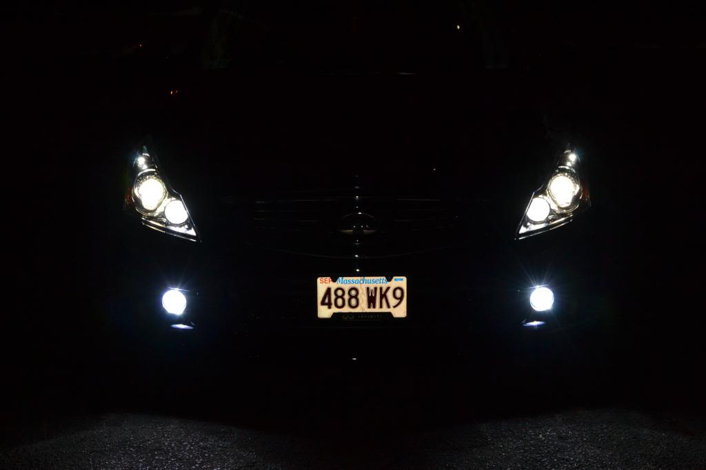

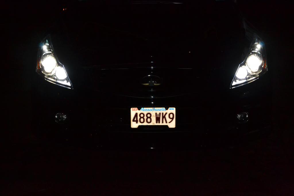

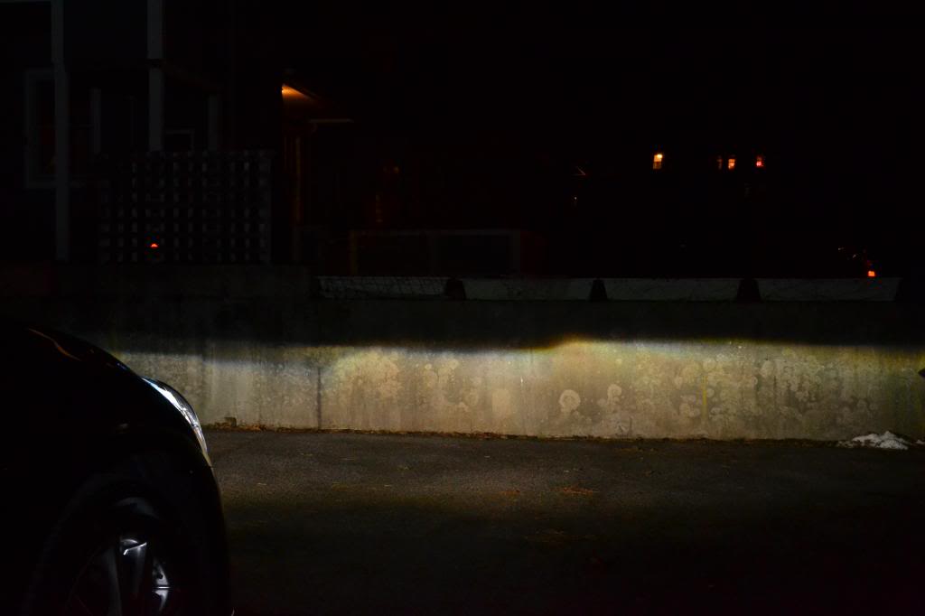

Here are some pics:
Not sure why the output looks so yellow against the wall, but it is definitely whiter in person.

I'm not sure if you are talking about my HID fogs, but it was the headlight bulbs that JT installed. When you saw me, the stock Hoito bulbs were installed...not the Osrams.
The Osrams Xenarc CBI 5000k are much brighter and produce a pure white output...they are still on the yellow side until the salts are burned in.

For some reason the cut off looks a bit off to me still. Did you try to adjust the height when you thought it was the projectors/bulb problem? That's a shame a actual shop couldn't install a pair of bulbs correctly. If you haven't you should upgrade to tsx clear lens for maximum clear cut off.

The fact is that they were the only ones to access the HID headlights...except for the Infiniti factory.
Brian @ JT Motors adjusted the passenger's side...he said it was way too low.
Now both side are even when light is projected from 3 ft against a wall.
Was thinking of adjusting the driver's side higher, but not sure if I should.
I compared mine with my friend who also has a 2013 G37x sedan and his cut off is exactly like mine with stock bulbs.
I think it is the headlights, they are that way.
To change out the projector lens isn't in the picture...leasing.
If I plan to keep the G afterwards then I'll consider retrofitting.
I had an FX before the G and the cut off was way sharper...is there anything I can do to improve it without opening the headlight?

I doubt it since I believe some of the FX have clear lens on them from factory. They are just overall better projectors. Not sure why they did that. From factory the driver side should be lower than the passenger side.
I guess I'm stuck with the inferior lens.
What is strange is that it was the exact opposite from factory...the driver's side was "higher" than the passenger's side.
That is why Brian adjusted the passenger's side higher, but now I'm being told that the driver's side is too low...I'm confused!
I've also mentioned this issue on HIDPlanet and members there are saying the same thing that the driver's side is off.
I think that due to the broken clip, the light isn't exactly aligned correctly within the bowl of the lens, so it is causing this issue.
I feel that as long as they are doing the job they are designed for, I'm not going to cry over it...even if they aren't perfect.
All I can say is that I'm quite happy regarding the Osram CBI bulbs...they are a huge improvement over stock as far as brightness and looks!
Can't wait until they are fully burned in.
If there is anything that can be done to correct this issue without opening the headlight then please advise me.
