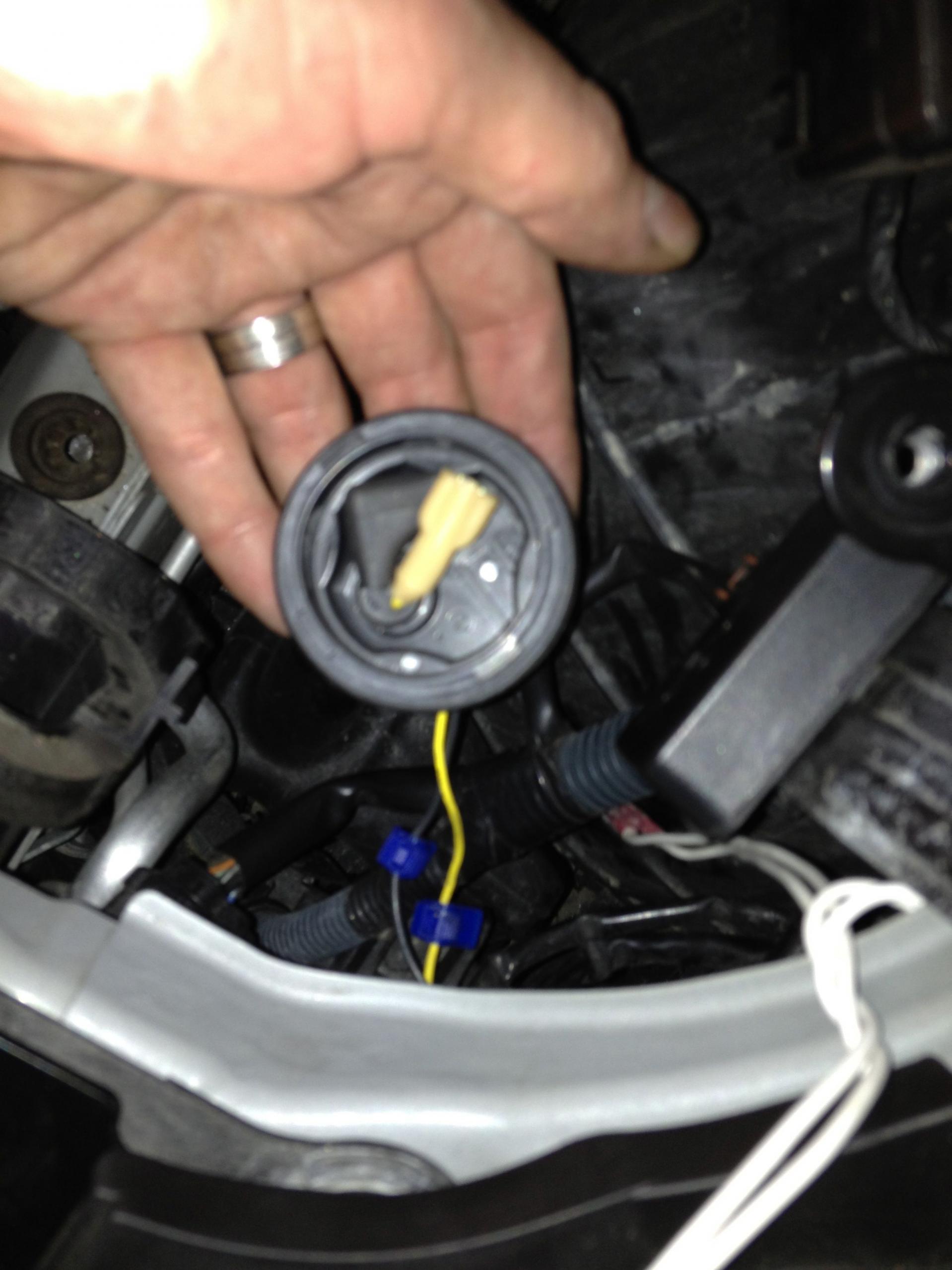

So I just finished hooking my fogs up. Yesterday I tried the whole wheel well thing, leaving the wheel in place. Dirty and awkward and I have no idea how people manage that...I put the car back together. Last night looking at the light placement, I figured that maybe I could just do the lights from the top. I looked, found the following thread:
https://www.myg37.com/forums/d-i-y-i...acement-7.html
It talks about just changing the bulbs, and indeed confirms that the top is the best way to change fog bulbs. I pulled the air intake boxes (see the how to half way down the page in the above link) and opened the fog back EASILY. I didn't want to cut the wires, so I just disconnected them and pulled them back into the fog light cap (see pic). THis got them out of the way of the connectors on the back of the light and got me a bunch more wire to work with. I slapped on my t-connectors on the fog wires, hooked my fogs in a voila! Working fogs! The beautiful part of this, is that it's completely reversible...that was important for me.
So, anyway, worked for me, might not work for others but figured I'd share!

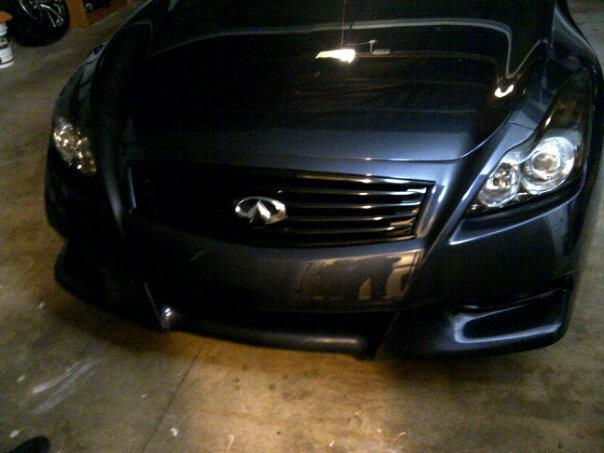

IPL/Aerodynamic Bumper Swap Idea.-73orq.jpg
not wired fogs yet, and Sides in Feb. thanks for all of your kindness in this forum
