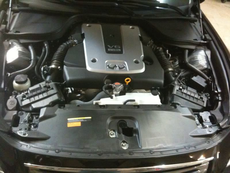

Which bolts exactly? I tried looking around and I couldn't figure out what to unbolt to get to the parking light bulb. I think that I would have to remove the intake box but that seems like way more than 3 bolts.
Could you point it out on the pic?

yes, if you have the OEM intakes you will either need to take off the tires or take out the intakes (the intake would be MUCH easier)...with my Stillen Gen3 I can just reach in and get to it.
But with the OEM intakes it IS only 3 bolts/side

with the passenger side lights, make sure you take out the washer fluid tube -- it gives you a lot more room to work

Sounds good, removed the driver side box it took like 2 mins, didn't have time to do the rest I'll finish it up when I get home tonight...

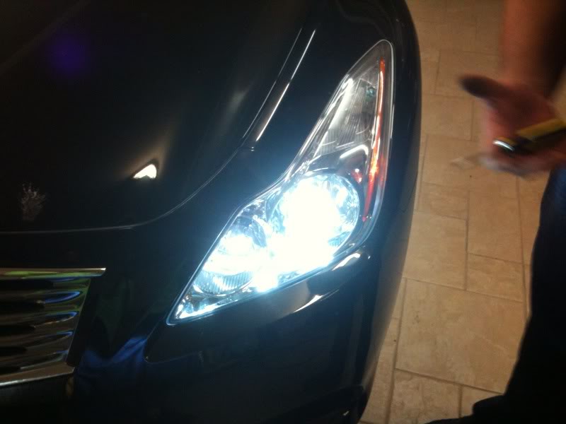

Lights are done! Looks much better IMO. I rarely use the fogs, and when I do, I want max visibility so I will be keeping the OEM bulbs for those situations.
Thanks for the tips guys!
