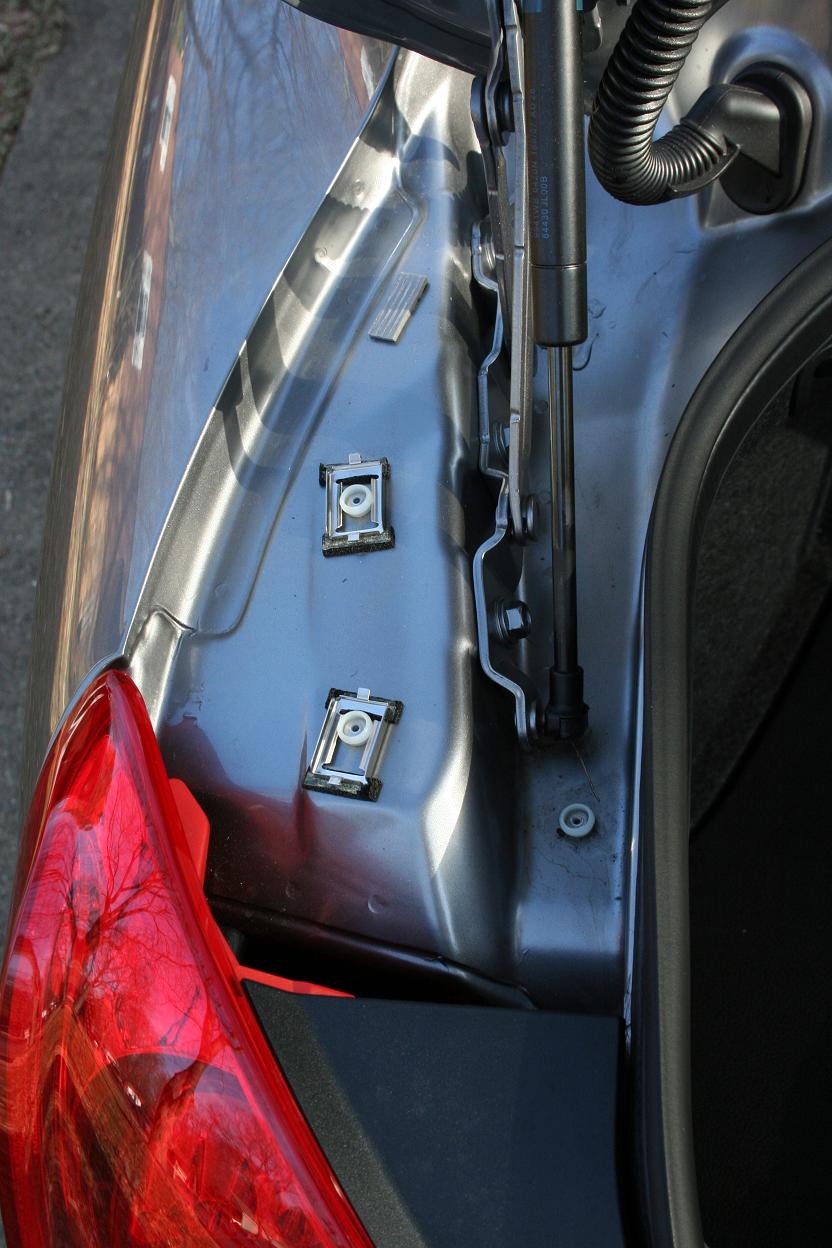

Alright just did mine and i figured out a way to skip taking off the plastic panel pieces above and running a wire behind it, once youve taken the 3 nuts off the bolts take a small hammer or back of your screwdriver and wack the ends of the 3 screws, this will pop the assembly loose from the clips without any pulling or the fear of breaking them. After trying it on the first one the second housing took my about 3 minutes from start to finish. Good luck.
https://www.myg37.com/forums/attachm...d-img_1561.jpg
the picture above shows the 3 attached bolts after the taillight assembly is removed, these are the ones you should wack when their poking out of the holes in the frame of your car.
