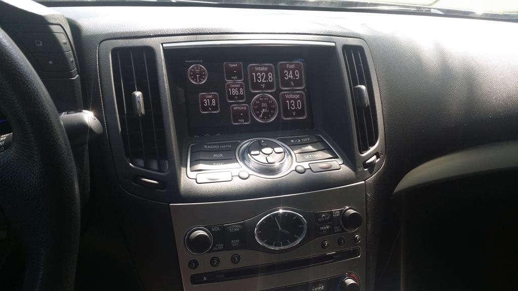

Nexus 7
![](http://i100.photobucket.com/albums/m33/blazeplacid/Audio/20140704_155422_zpsz4vi0dyy.jpg)

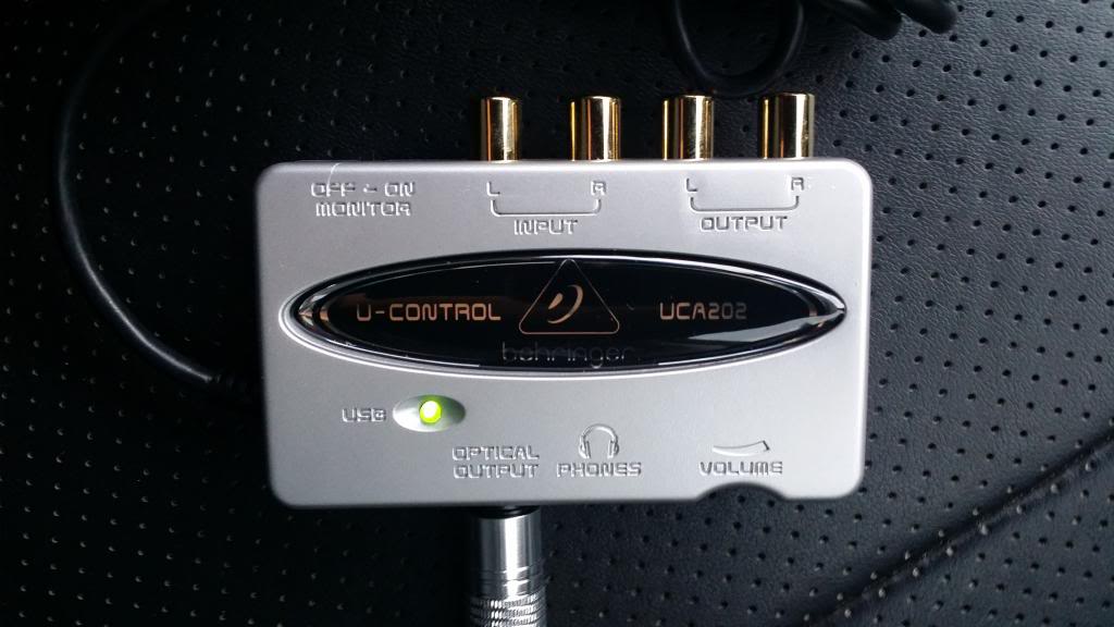

DAC
![](http://i100.photobucket.com/albums/m33/blazeplacid/Audio/20140703_072017_zpsflhekczu.jpg)

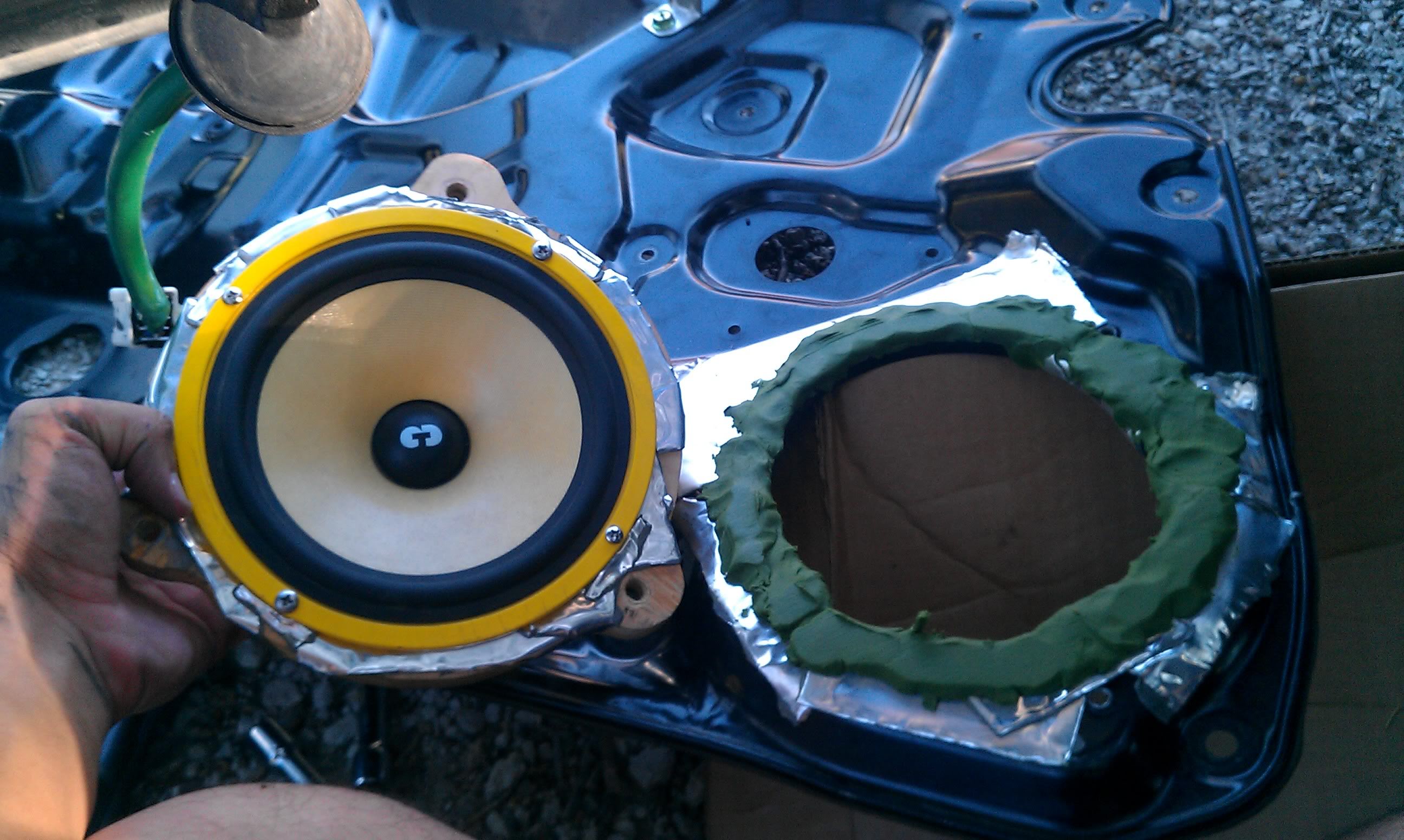

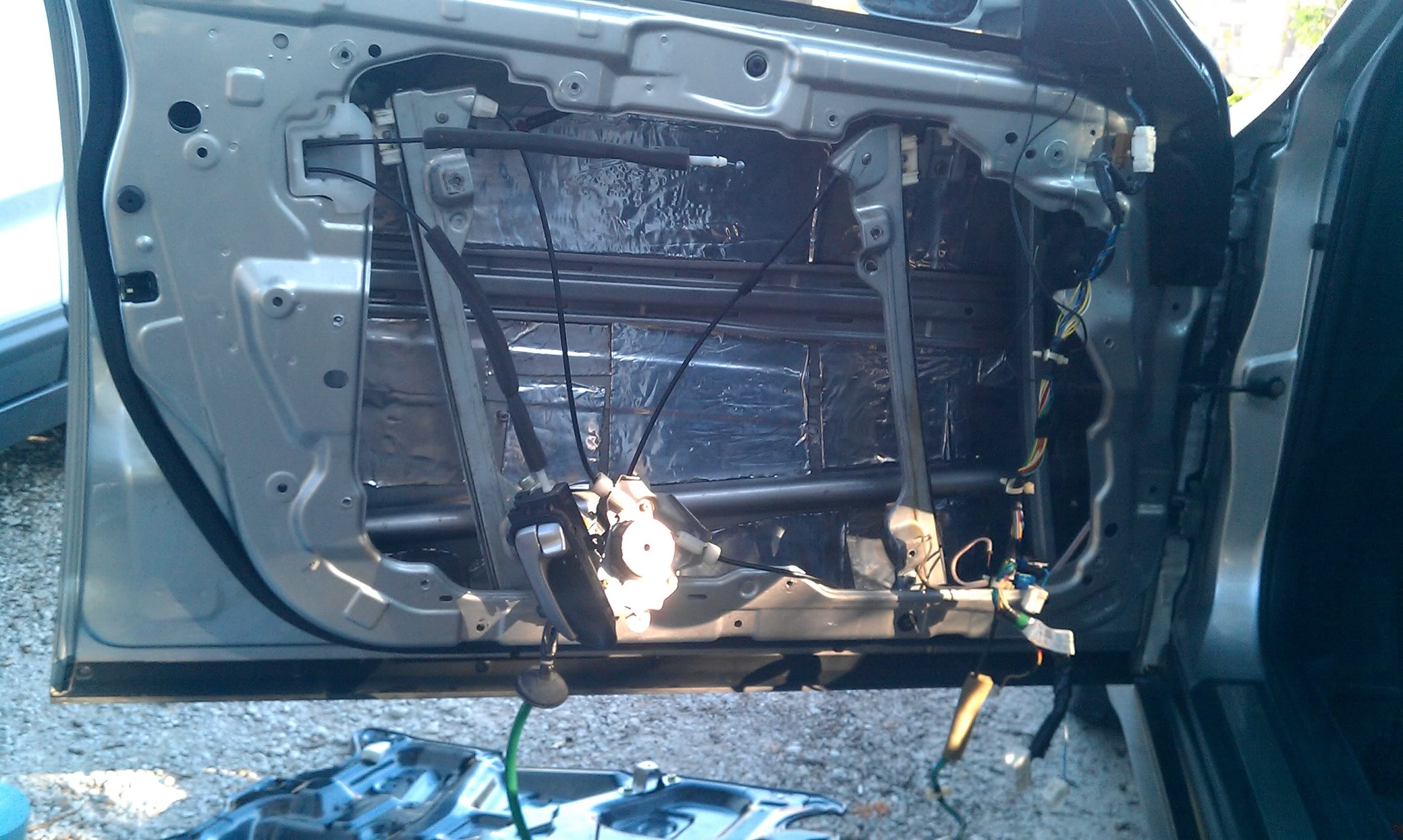

Doors
![](http://i100.photobucket.com/albums/m33/blazeplacid/Audio/IMAG0240.jpg)
![](http://i100.photobucket.com/albums/m33/blazeplacid/Audio/IMAG0239.jpg)
The BTD is being fed signal from my Nexus 7 in the dash. The Nexus 7 is sending signal to the BTD via a DAC. Optical cable connection.

The Doors are deadened. The sub is in a 1.0 cube sealed enclosure.
Nexus 7
DAC
Doors

Thata a pretty cool set up adding the Nexus 7, how did you settle on the ctds? Ive never heard of them before.
CDT is an SQ (sound quality based company).
I have been using all type of CDT mids and tweeters for over 10 years.
I liked the ES series because they provide excellent mid bass without having to build an enclosure in your door.
