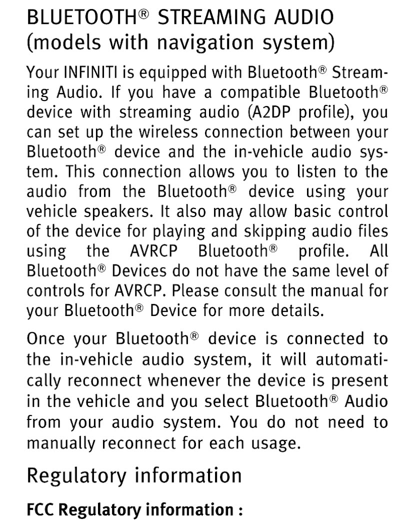

Originally Posted by cribbsjy
Don't the 2010+ have A2DP built into the stereo? I thought 2010+ could stream media over Bluetooth.
Mine is non nav and bluetooth only works with the phone. I assumed with bluetooth of any kind I could stream from my blackberry or iPad as well, but when I couldn't, I checked the owner's manual and it says only the ones with nav can stream the audio.
