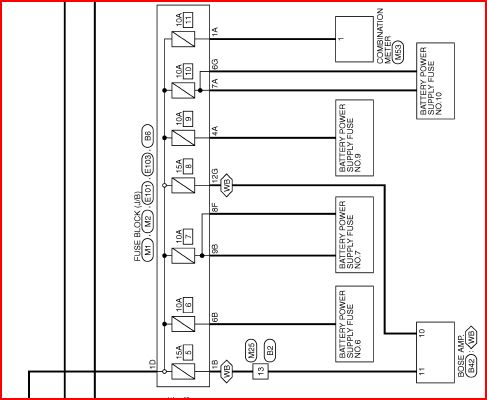

There is a Bose amplifier and a separate Sub-woofer amplifier, that I do not see any specification details on from the service or owner's manual. There are so many factors in audio reproduction. Bose seems to be a neutral, clear sounding system to me. Perhaps there are photos of the amplifiers in the forum somewhere...sounds like time for a search. I have attached clips from the service manual. Only the rear shelf "woofers" are powered by the sub-woofer amplifier? the front door 10" woofers are from the main Bose amplifier only? I will have to try boosting the rear or adding bass and see what happens. The center speaker in front is only used for bluetooth telephone speaker?

Looks like two 15A fuses to the Bose (premium) system, I assume one for each amplifier. Max'ing both fuses out at 12V x 15A = 190W x 2 fuses = 380W, very close to the 374W mentioned in the article above.
